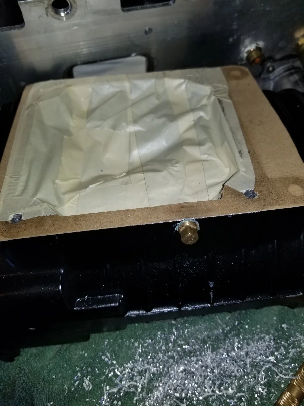

I.i.i. don't even know what I'm looking at. Is that the blower outlet base where it meets the intake manifold?Ok so things didn't go well yesterday.

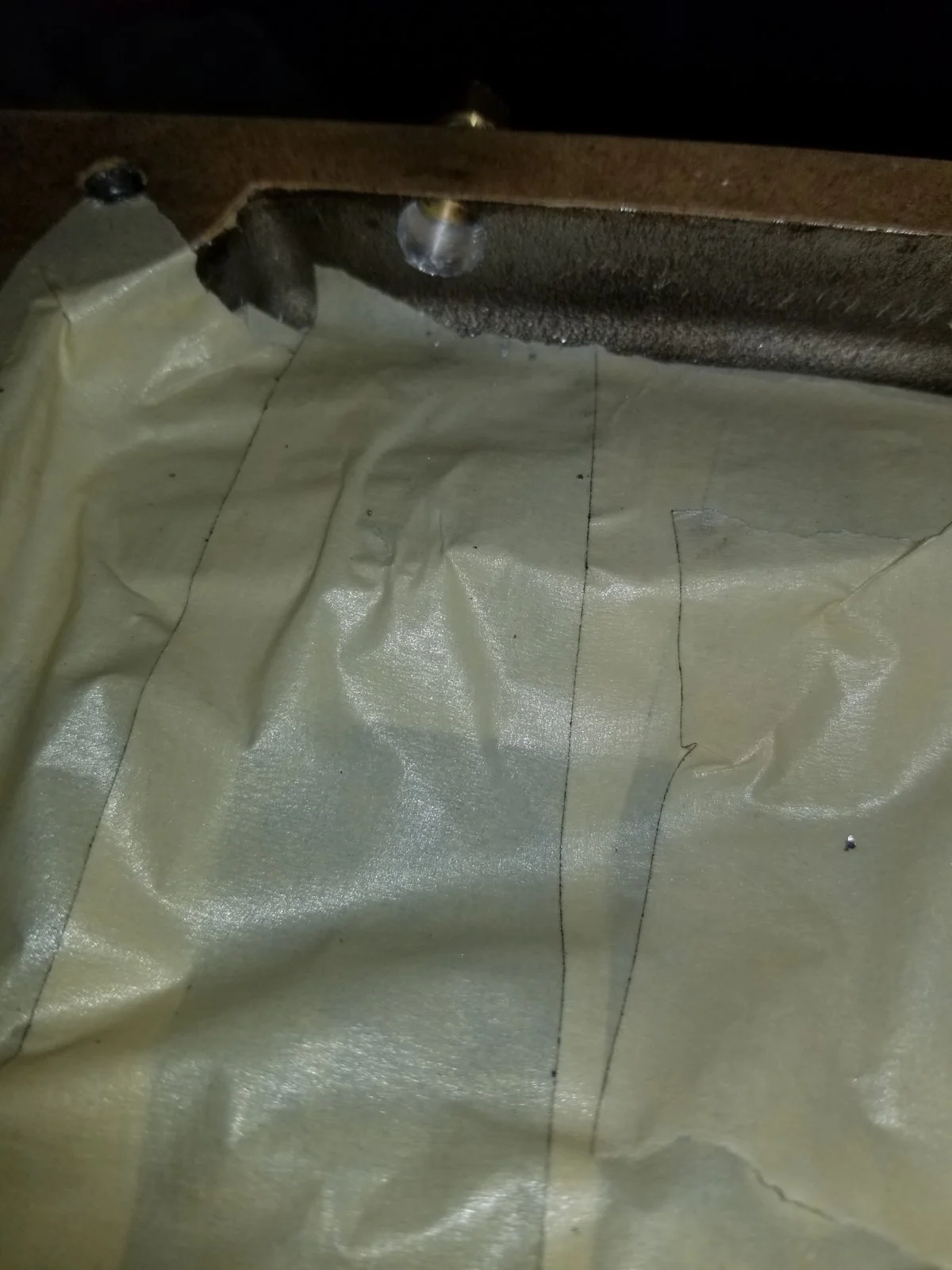

You can see how close I ended up to the gasket surface. Luckily it did not distort, the metal at all.
I was doing some Google work and am considering holding off until I can get ahold of some 1/16 NPT fittings/taps I may be able to make them work as they will require less real estate.
Looking at this again today, I can probably make it work if I get some different fittings and extend the nozzle into the blower area.
Valid point Mike, after some research it seems spraying after the blower is more effective, but I think I am playing with fire at this point....I.i.i. don't even know what I'm looking at. Is that the blower outlet base where it meets the intake manifold?
I think you'll have distribution problems if you do anything there. The intake plenum is too small on that blower manifold, and the runners that route from there are way too short. ford intake manifolds are notorious for starving the 4 outside cylinders even when using a centralized spray bar like what is used in a typical nitrous plate, and you putting a meth nozzle in one spot is begging to hose down a couple of cylinders, while the rest of them get dick.
