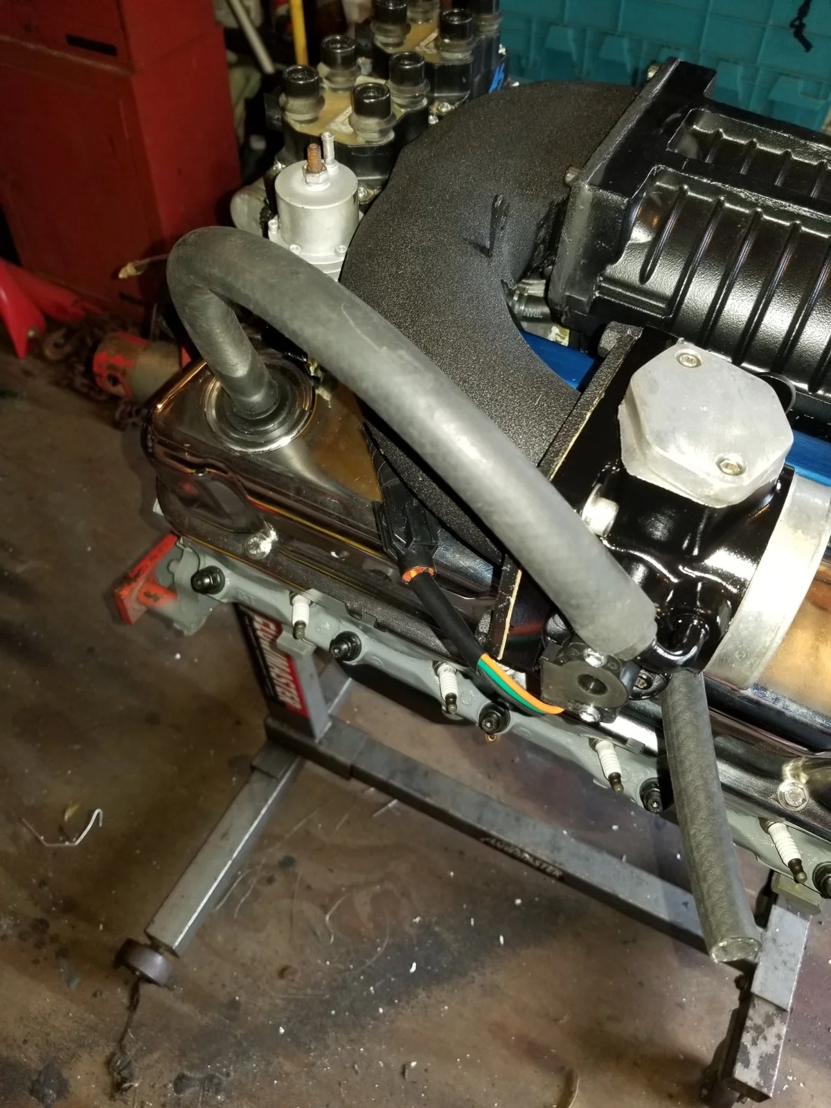

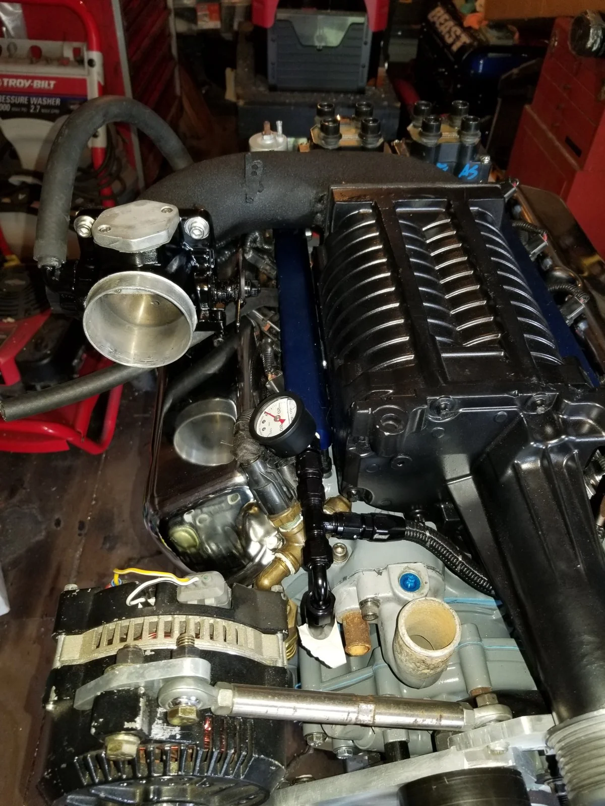

Tb cleaned painted and installed, currently working on the fresh air feed for the valve cover/ IAC valve... may weld a port onto the cai tube for the iac feed. Looking good so far. I think.
Looks good brother,very simple and clean-yet,painfully planned out and designed. One of my favorite custom builds to date.
don’t worry about the ugly headers-VHT will make them better than new lol
I'll be honest....I love the build....but I don't like that regular hose going from the valve cover to the TB. I think it needs a pre bent hose....or one of those spring hose shapers. They have them in advance auto in the aisle with hose clamps, pipe plugs, and vacuum fittings. They are stainless. ( don't know if they make them small enough ) i used them to use a straight hose from the WP to the coolant pipe on another mustang.
I don't know.... it needs something.... The hose section behind the counter may have a hose with a 90° bend.
The hose thrown on like that says " I'm tired... F it.... I'm going to bed... its done "
My first idea probably won't work and may look dumb, but it shows i really thought about it.
Second option would be a lot cleaner and cheaper. Could even throw some black vinyl braid on it with black heat shrink at the ends. Doesn't need clamps....
I agree but I'm sure Steve's not satisfied with it either, move that nipple in the tb pointing down, a couple 90° hoses with a pipe in between some braided covering/heat shrink (no dave not green) in black good to go :nice:
I have the two different style braces I can bring.
I had that lying around so i figured why not give it a try, it fits snugly and will do the job for now. I'm not sure how any of that will look or fit once the engine is in the car so i am going to wait and see.
I thought about buying cheap nylon braided hose to do the job for all the vacuum lines ect. but even the ebay stuff seems pricey. I like the idea of using some kind of nylon cover with a bit of heat shrink. i even found a kit on ebay to do all the vacuum hoses under the hood. Thanks for the Idea Scott!
If you could bring those braces JR that would be awesome. Thanks!
