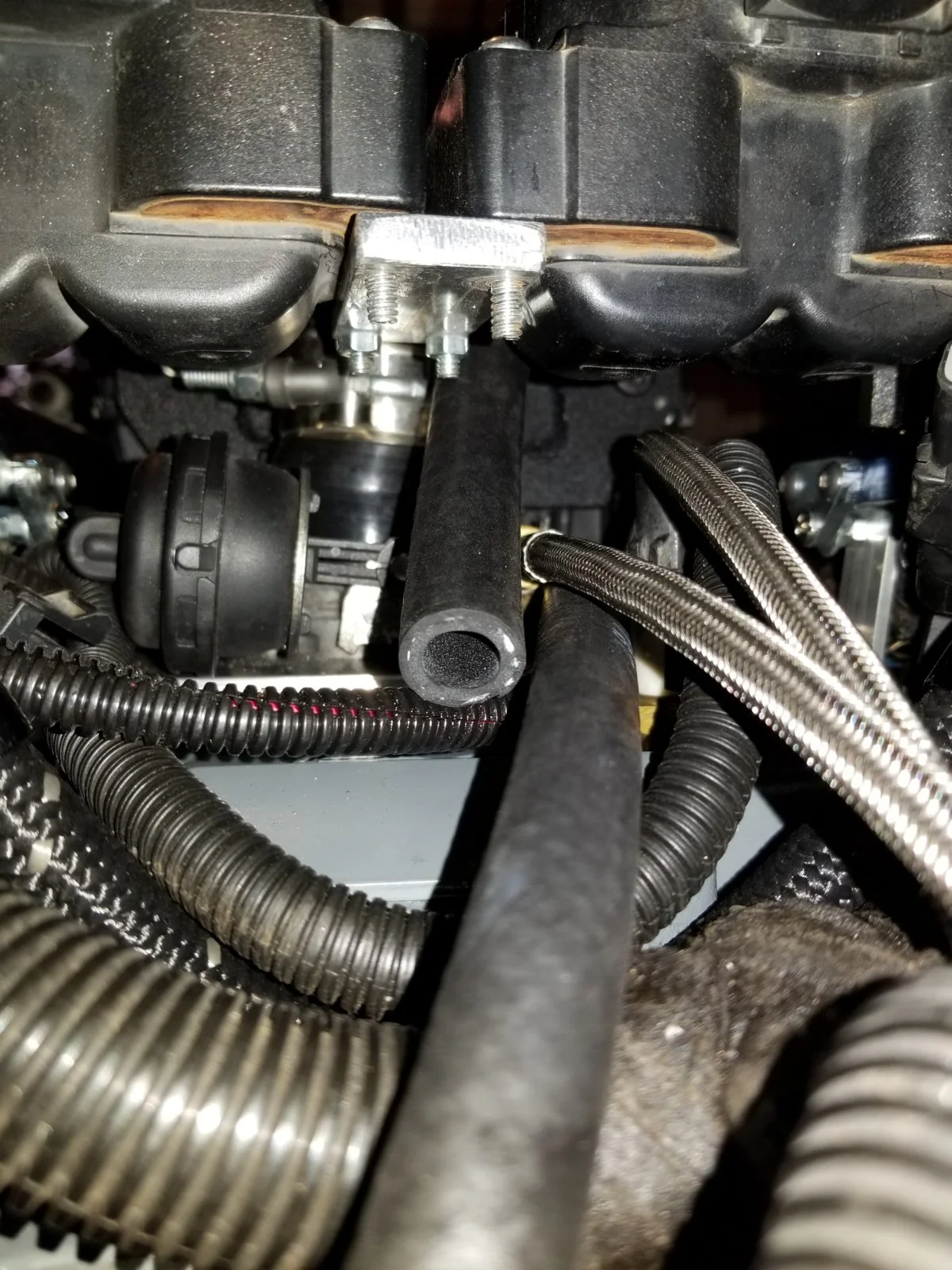

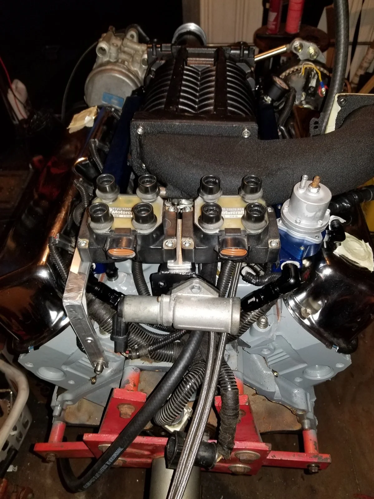

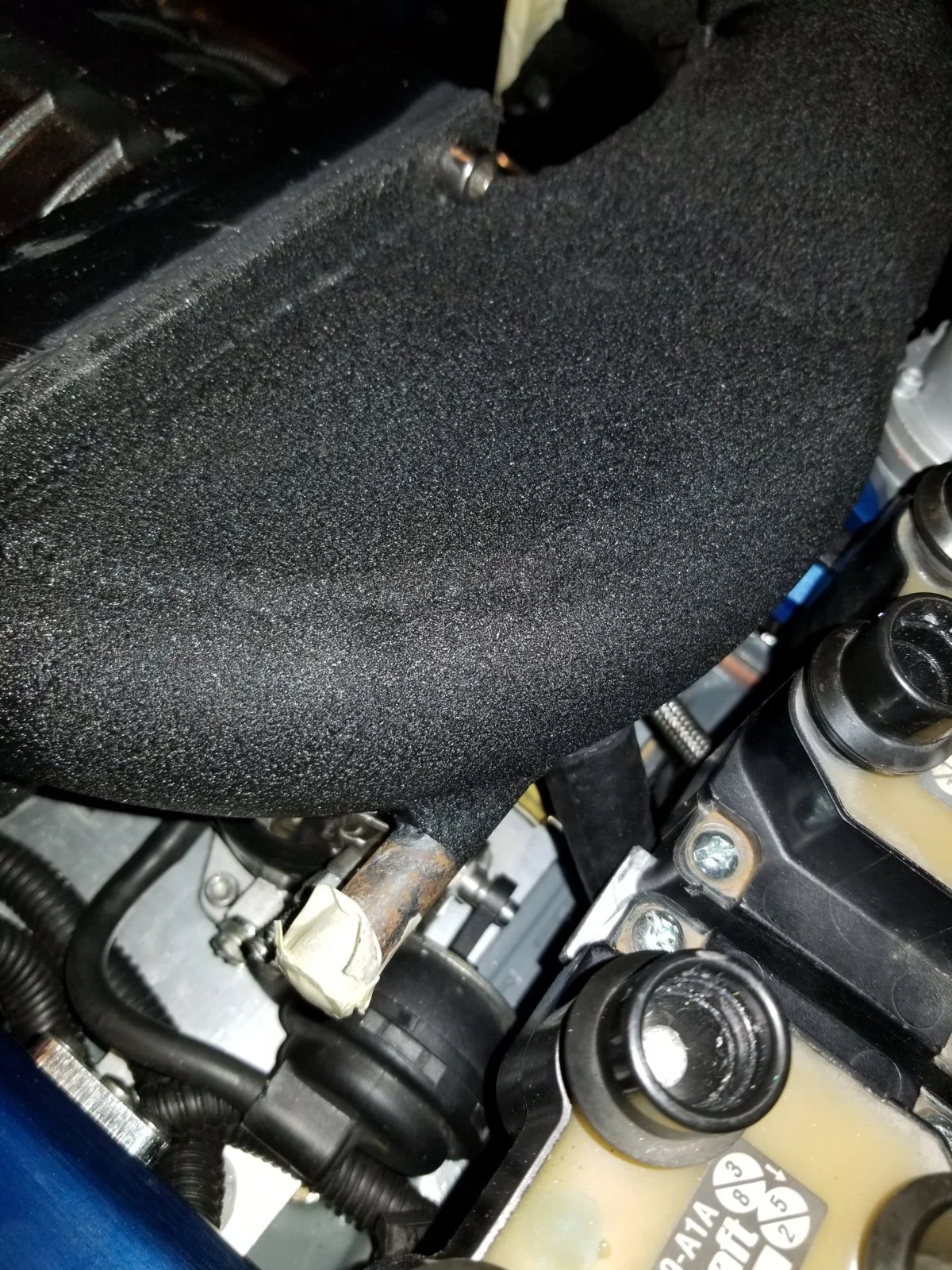

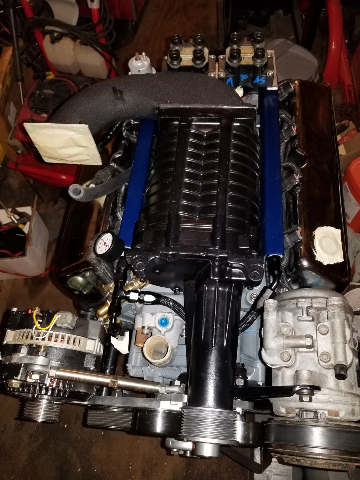

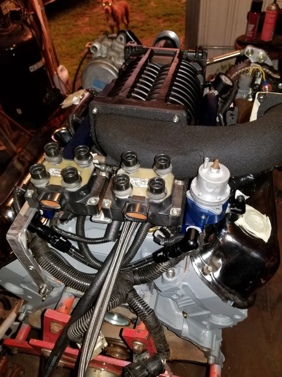

Got some more pictures for you guys. Down to the little things now, line routing ect. Trying best I can to hide things.
I know the coil packs are ugly, I have a new set but motorcraft> house brand.
I vacuum tested the assembly with it taped up, held 5inhg for 10 min.. no leaks as far as I can tell.
