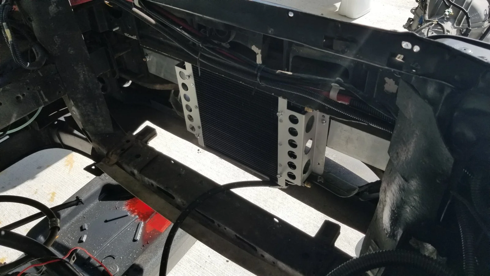

This morning I got the transmission cooler mounted, I removed the fan to make enough space for the AC condenser... I dont think I will have any cooling issues without the fan in stop and go traffic, what do you guys think? With enough finagling I may be able to move the ac condenser toward the radiator but I think it may be more trouble than it's worth.
The bottom half of it is directly in the airflow from the bumper, I could drill holes in the bumper cover but I think that would not serve a good enough purpose.

That will be plenty of airflow and good size for heat dissipation. Best place for it IMO as you dont have to rely on the fan to come on to make sure the transmission is cooled. I wouldn't go through the hassle of trying to move the A/C condenser towards the radiator as you do want some space between each item. Don't want the radiator heating up the condenser.

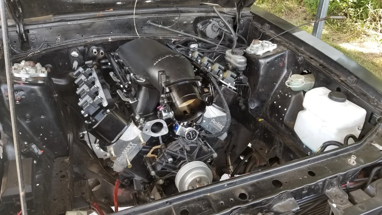

The engine is in! Few issues however, I needed offset rack bushings so I am waiting for those to come in.. the rack was hitting the bottom of the oil pan.
The hood closes, but barely touches the intake manifold, Kyle and I used a grinder on the bottom side to clearance it (fiberglass) and that worked very well. The hood is just barely touching the intake, I may trim the hood in that area and reshape it.
I am currently working on the transmission mount and crossmember I had to cut the tack welds so it could slide easily. I will post pictures once I'm done with that part.
The headers did not fit... so I was forced to buy a set of 1¾ long tube headers Doug's headers ceramic coated the ones that come with adapter plates. Got a smoking deal on them for 400.
