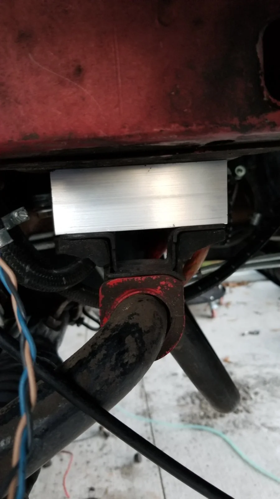

Ok so I swapped the spacers out with square tubing. Much more substantial.

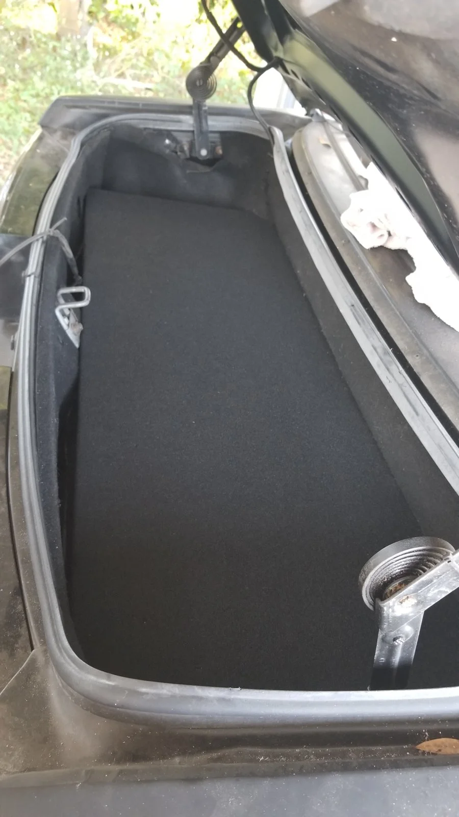

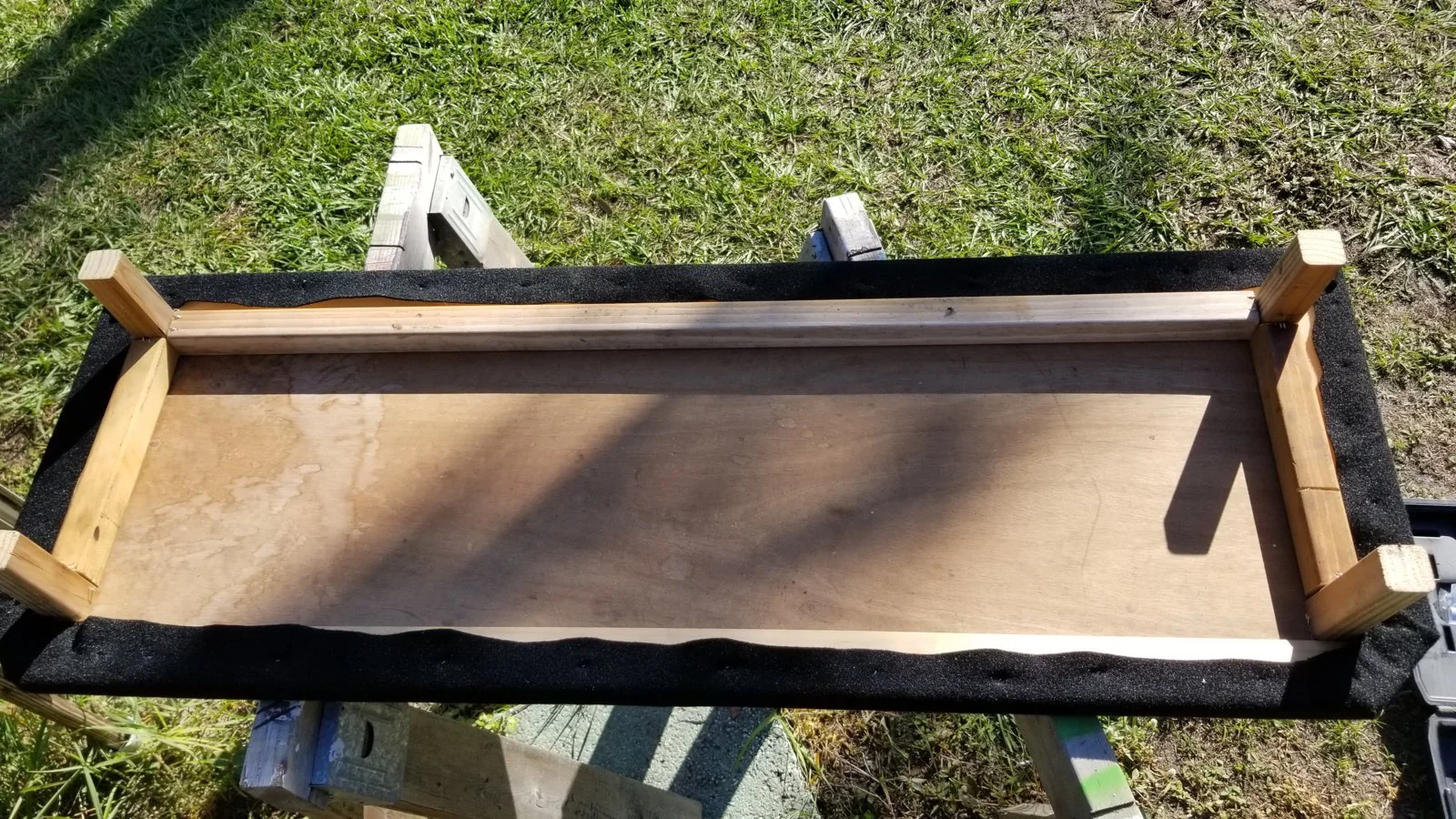

I have been working on some of the non essential parts of the project this week, I did not like the fact that the batteries and amplifiers ect. Just sat under a piece of carpet... so I decided to do something about that, behold! My bull:poo: cover up-er-er....

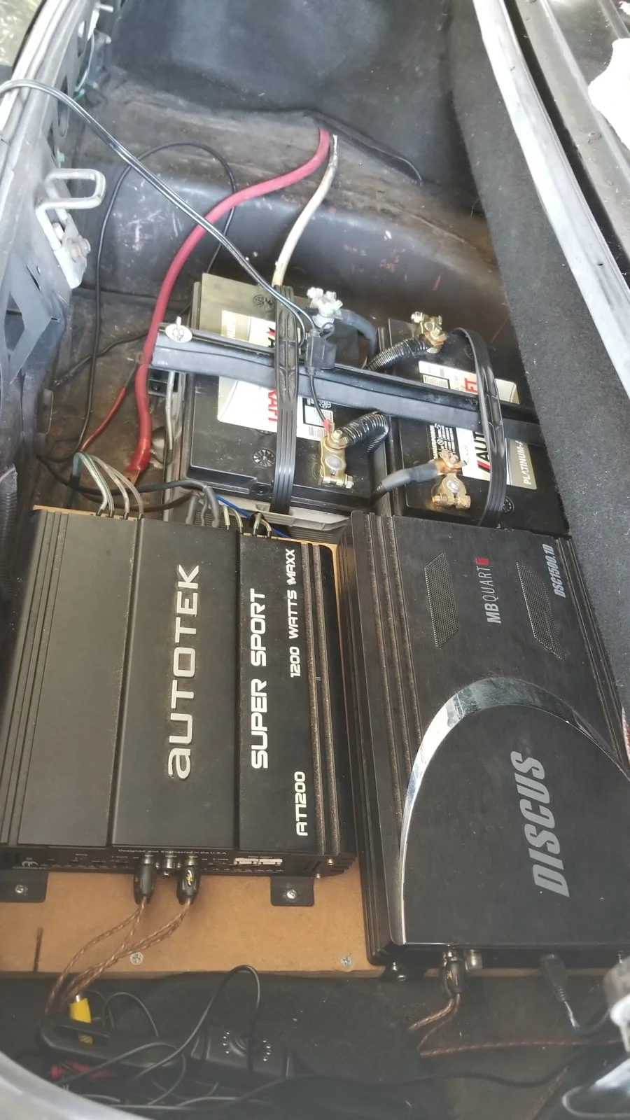

I am still wiring ect.. all this junk, it looks so dirty in the photos.... stuff is old I have had it since I was a teenager.
