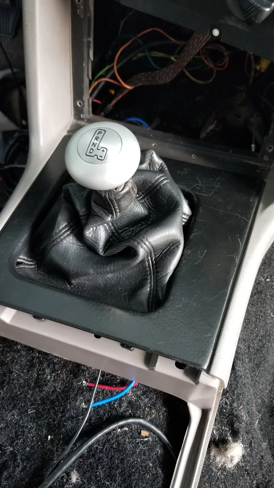

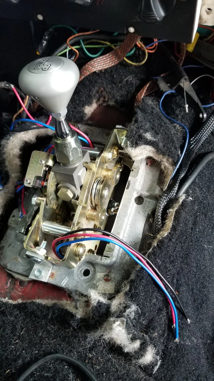

I managed to get the shifter installed yesterday, I am not 100% happy with the boot but it can be modified I would think. To get the shifter installed just like I wanted took a bit of time, i had to stop and tune a car while this was happening so it interrupted my flow a bit.
I started by cutting the factory shifter plate, I used a frozen up stock shifter to do this with. After the modifications were complete I went to mounting the new Lokar shifter in place.
In the picture above you can see the test fit, I had to do some more adjustments including moving the shifter down about 3/8" it would have hit the trim ring. I only have about 1/4 gap between the shifter and the transmission, that's enough for me.
The final product is not final just yet, I still have to wire in many things. But it is progress. I have to finish a tune today, so likelyhood of this getting done is low.
Yeah,......you’re gonna have to fix that. That looks like some sort of deflated ball, with a shifter handle sticking out of it. Way too much money spent to have the end result looking like that.

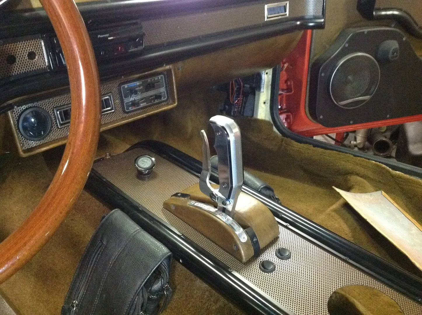

I’d ditch the boot, and make a slotted plate. (Think old Ferrari gate plate) and attach it to the bottom side of that bezel.at the very least, cut the excess off of the base of that boot, so it don't look like you just jammed it all in there.
*For inspiration....
