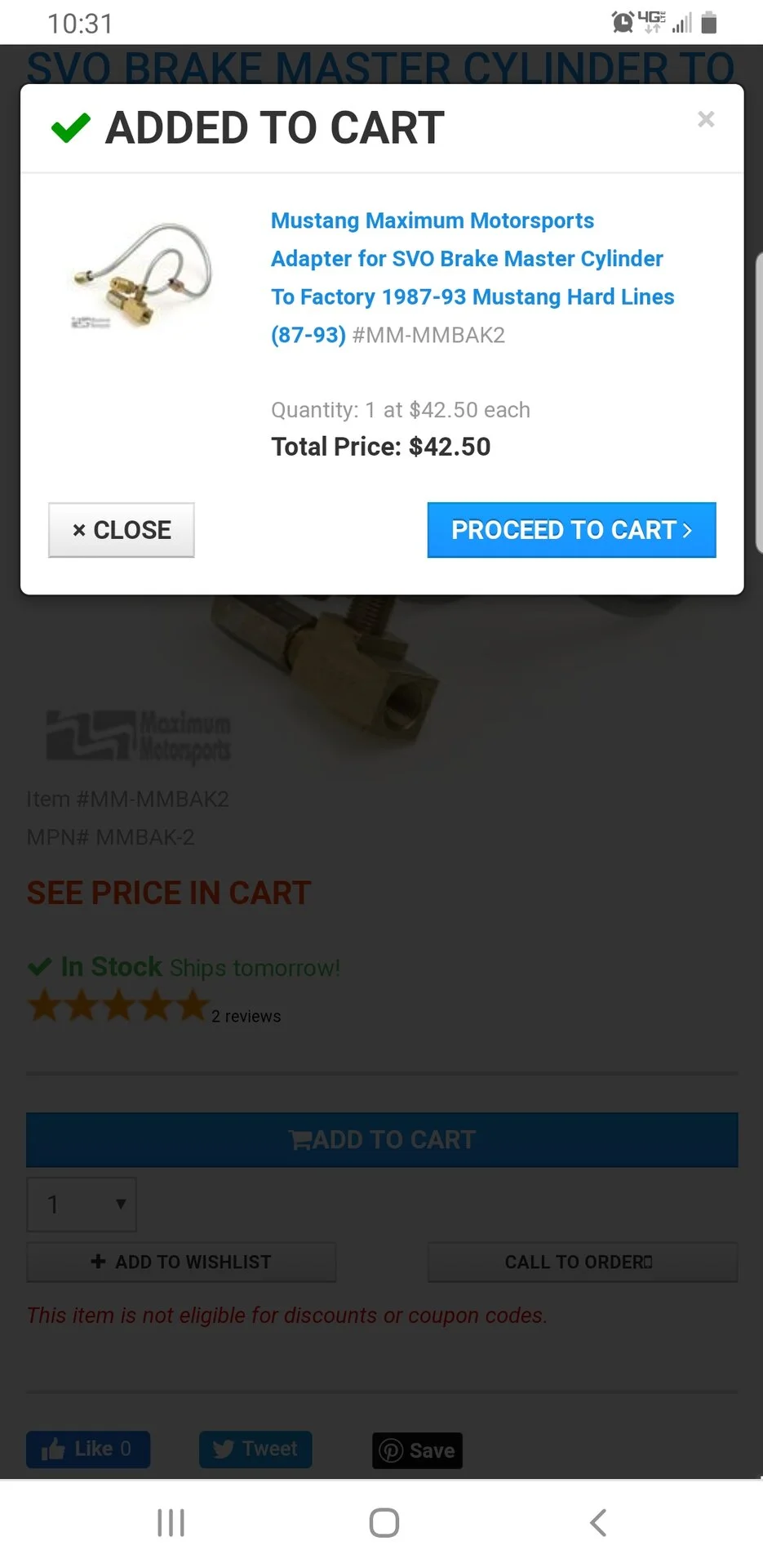

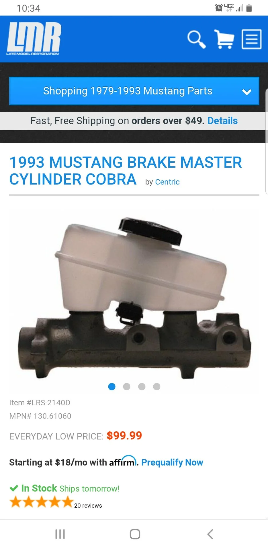

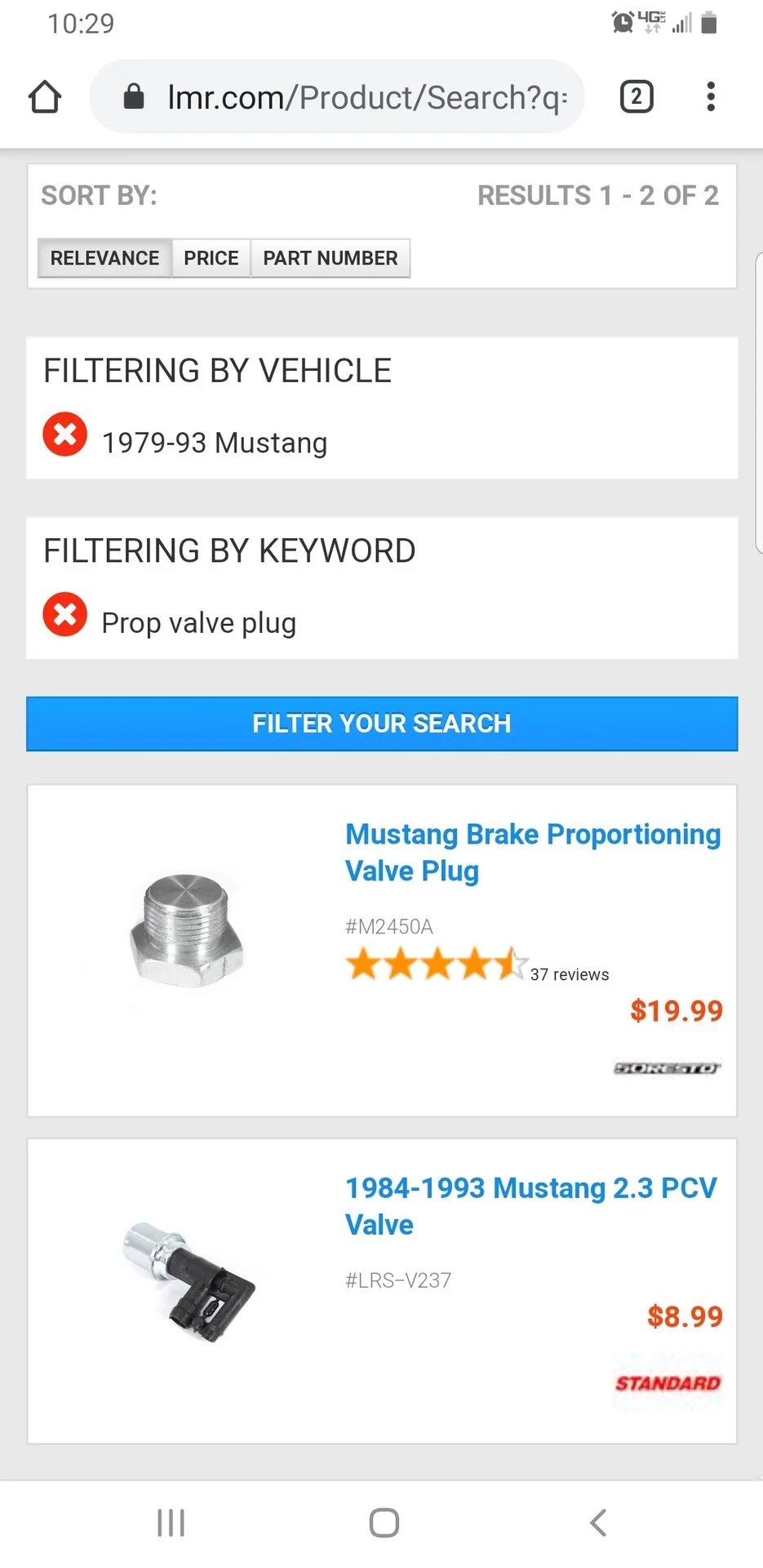

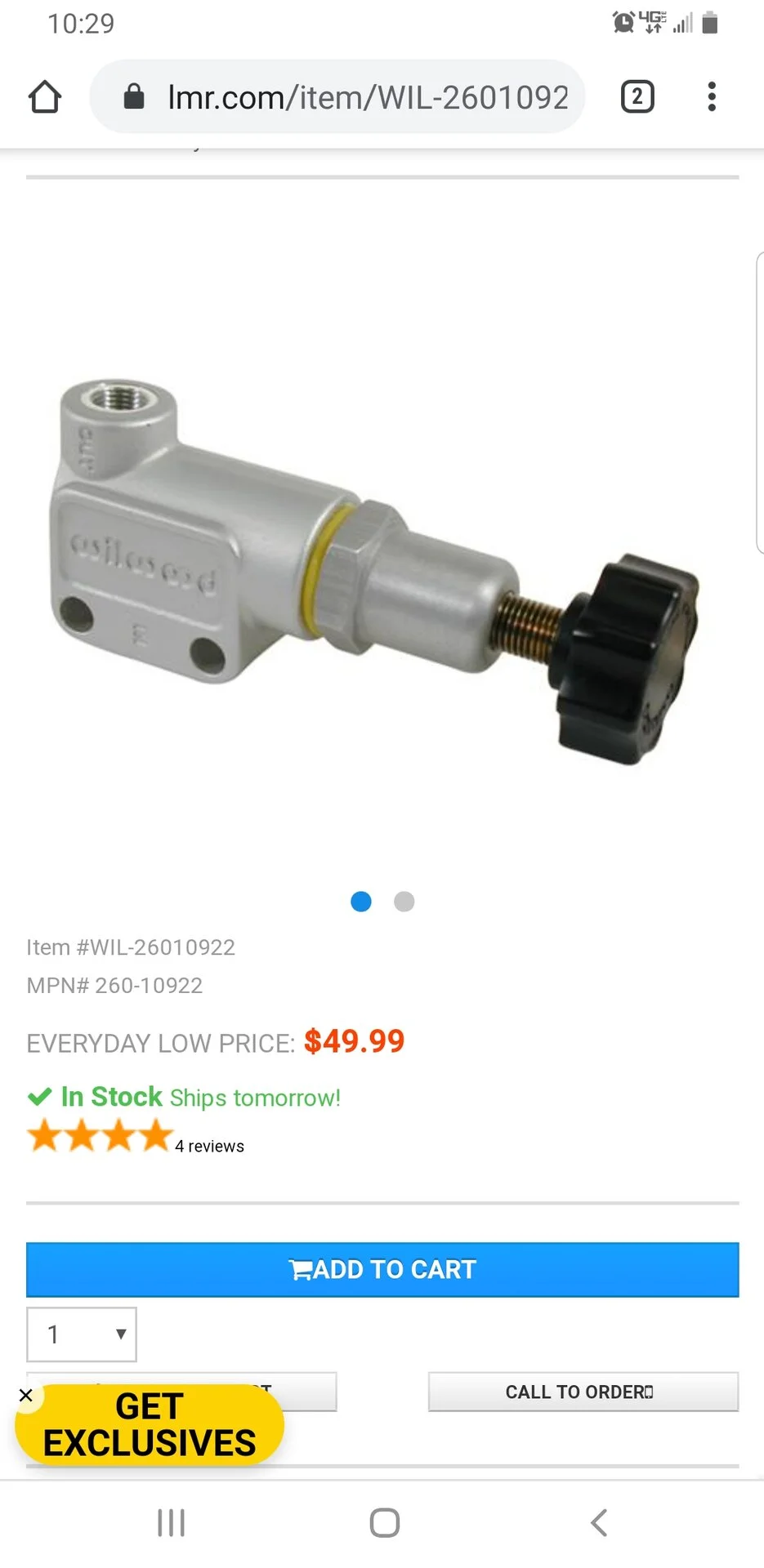

Ok so before this thing comes down off the jackstands I decided to go ahead and do a 5 lug swap. I need some help figuring out what I need to get.
-94-95 or 96-04 spindles? I know the only real difference is in the outer tie rod arm height I am using a bumpsteer kit to correct this downward already as the car is lowered with offset rack bushings.
-I have a set of the ATS brembo calipers with offset inserts that will be going on the car, I believe these will use a 13" rotor?
- I plan to run a 31 spline axle in the rear, do I need anything fancy to run disk brakes? if so what do I need? I believe we have a sn rear axle we plan to cut down for another project, will the brackets ect from that bolt onto the fox axle?
- MC selection, what's the properly sized one for this project?
-proportioning valve? what do you suggest?
I will read through some of the brake upgrade threads when I have time [its hard to find time these days]

A basic list of what you need. All 3 of my cars are 5 lug, 4 wheel disc with cobra brakes front and rear.
- Moser 31 Spline Axles Fox Length will work fine with hub for rear discs
- Front and Rear Cobra brake kits from North Race Car - North Racecars Brake Solutions or source the brakes seperate or if you already have then good to go
- '94/95 Spindles
- '93 Cobra Master Cylinder
- '93 Cobra Brake Booster
- WilWood Rear Proportioning Valve
- Plug for stock proportioning valve
- Maximum Motorsports 3 - 2 conversion brake line
