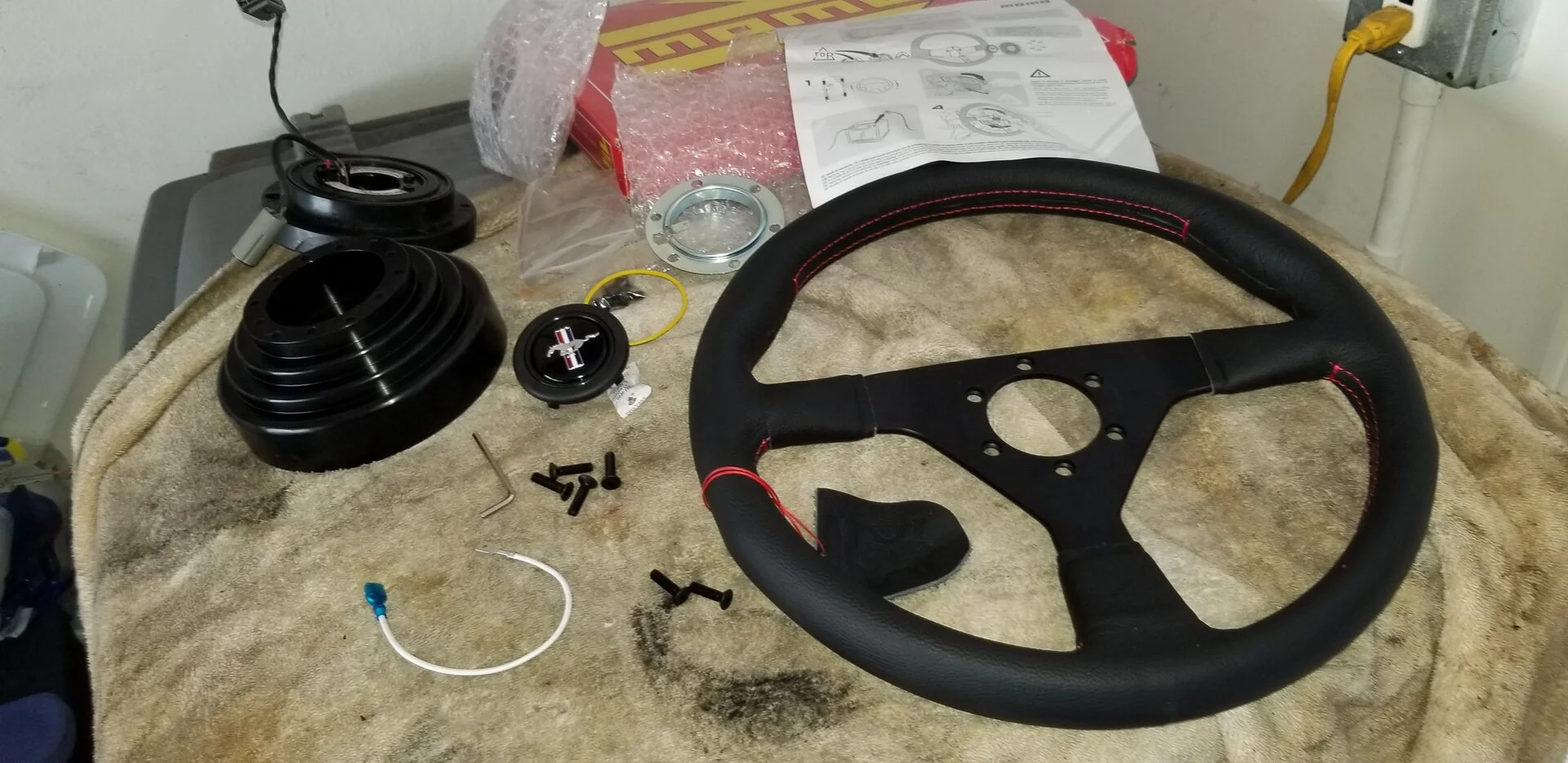

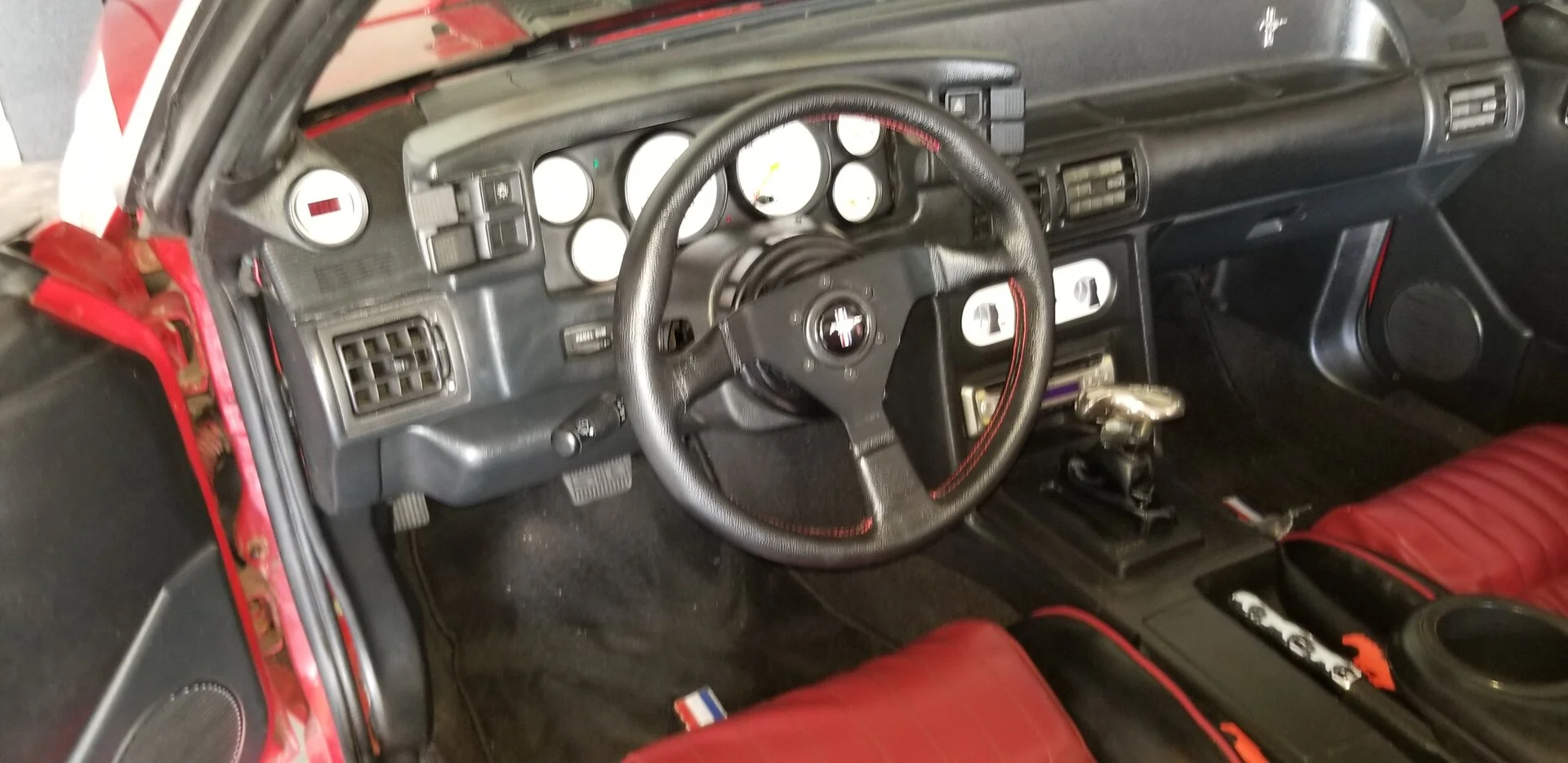

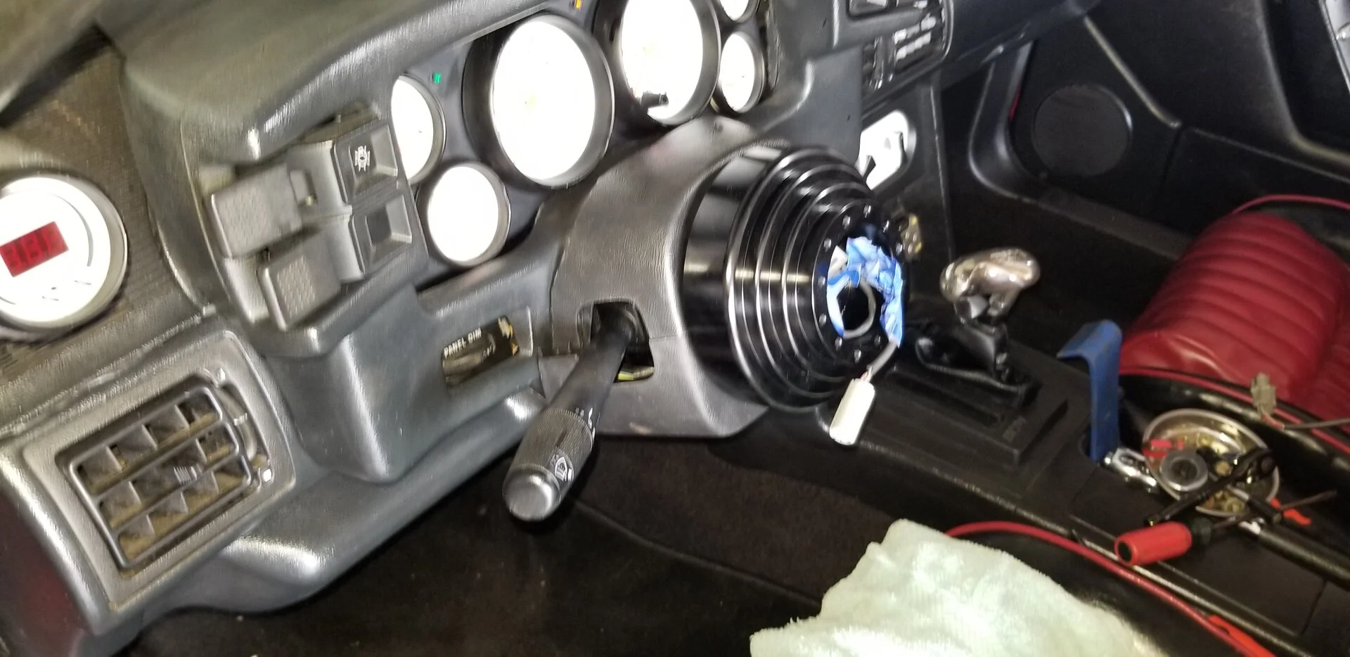

MOMO Monte Carlo Wheel

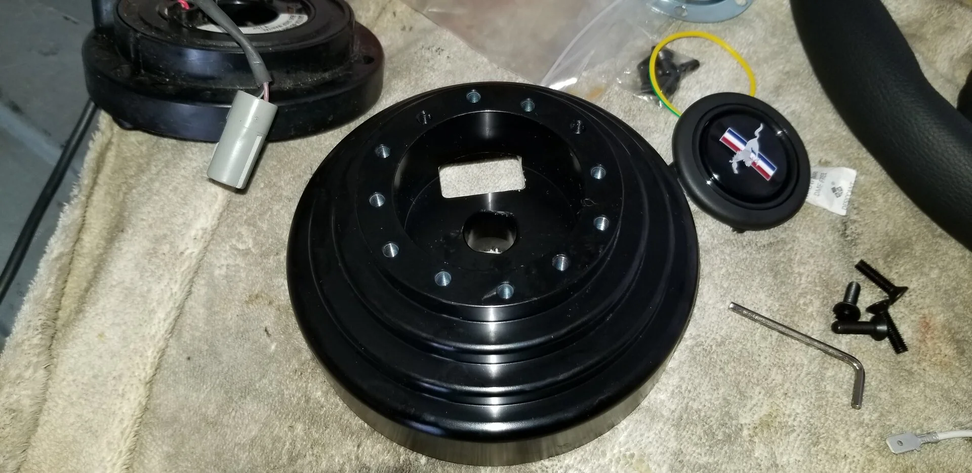

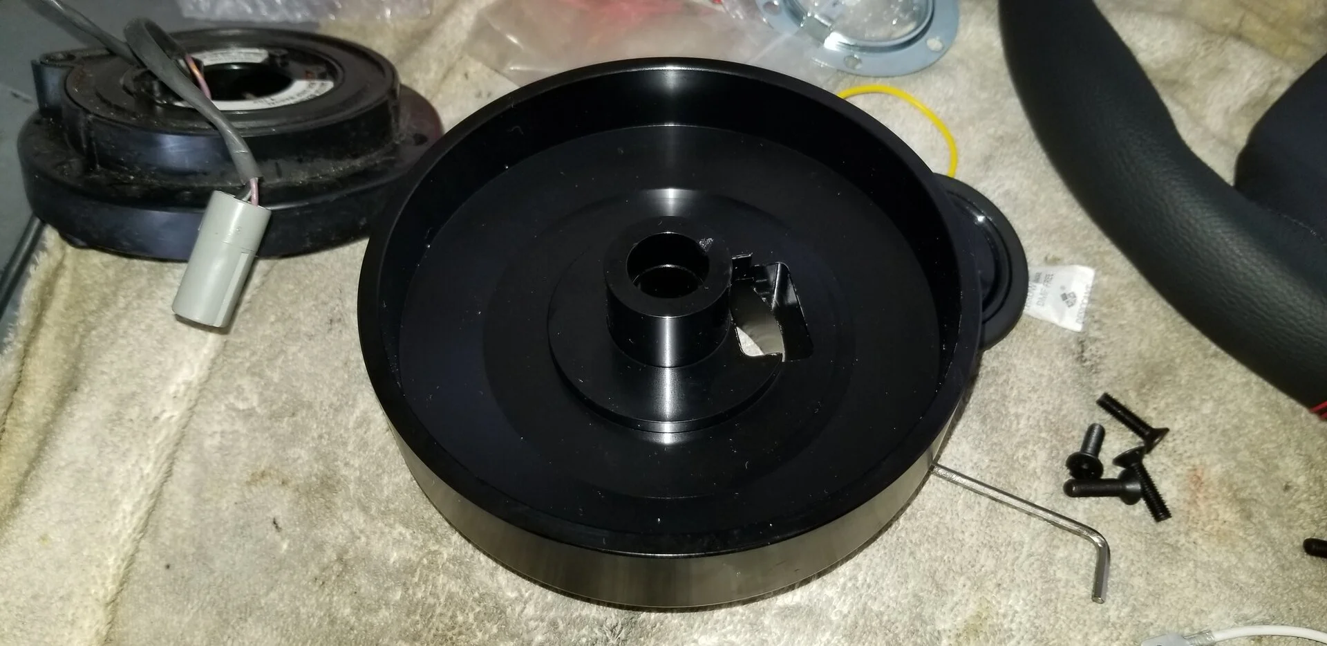

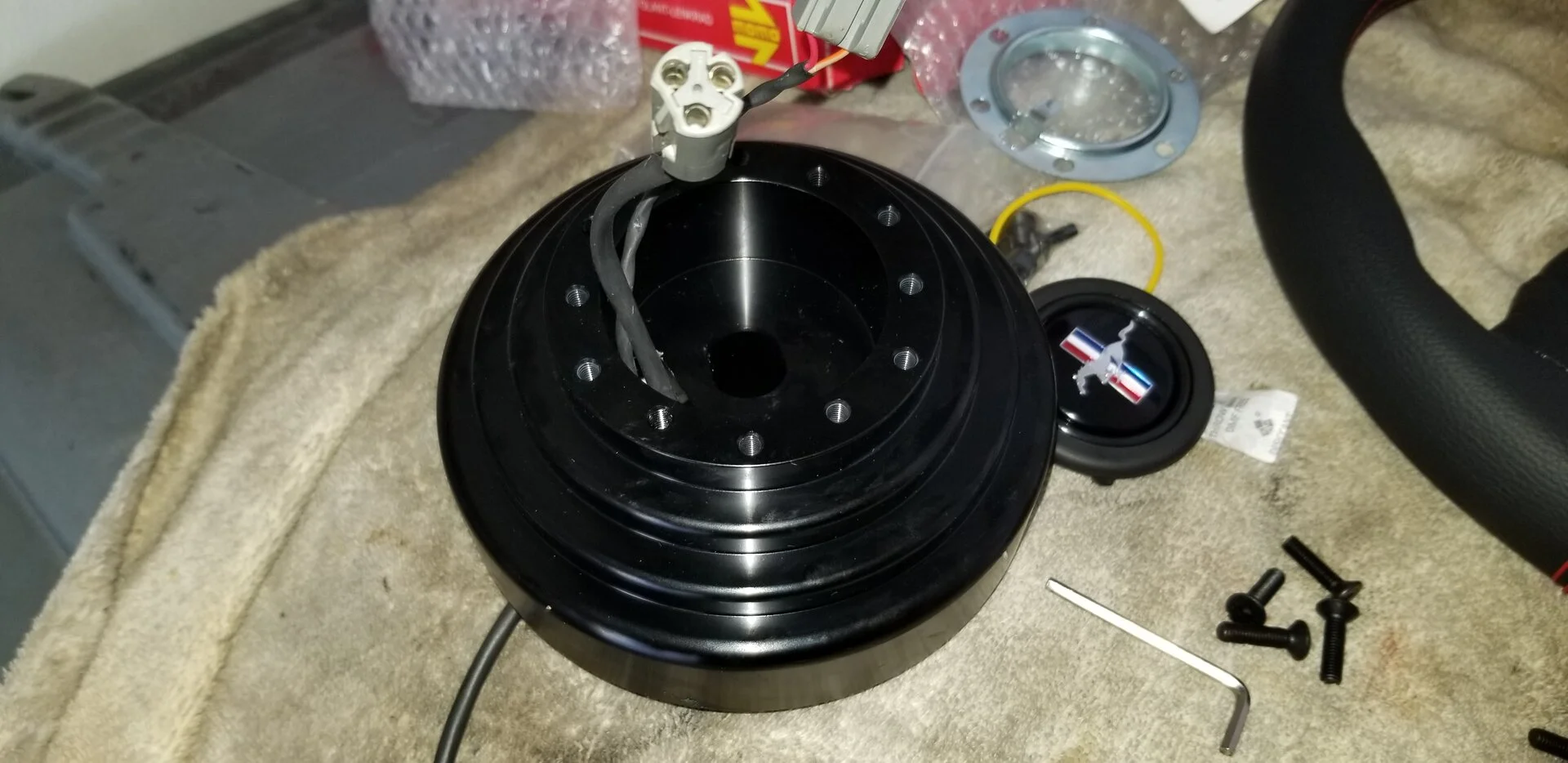

NRG -SWA-001RM Adapter off Ebay

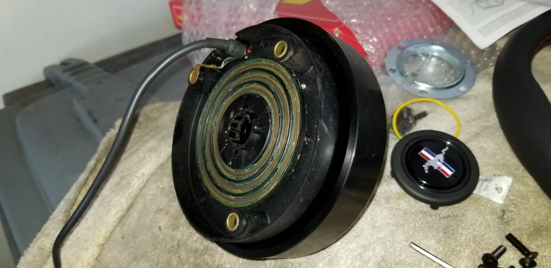

Bolted right on and covers the gaps.

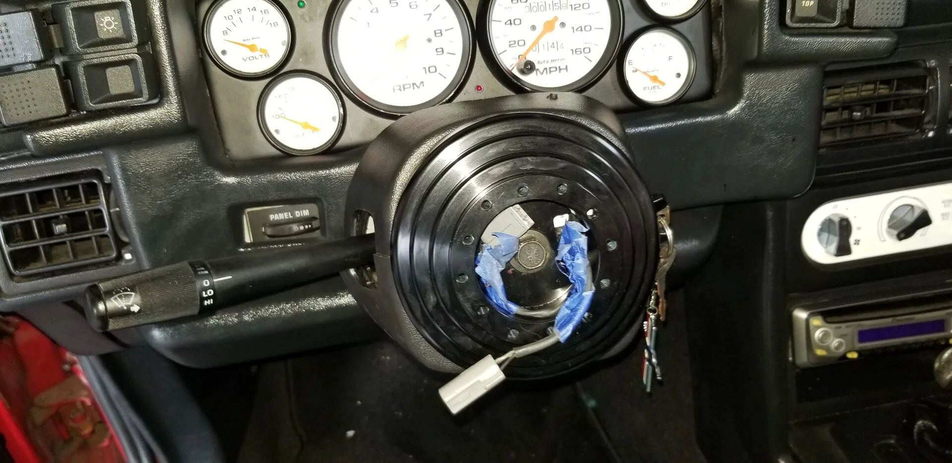

No removing or hacking of the Clockspring

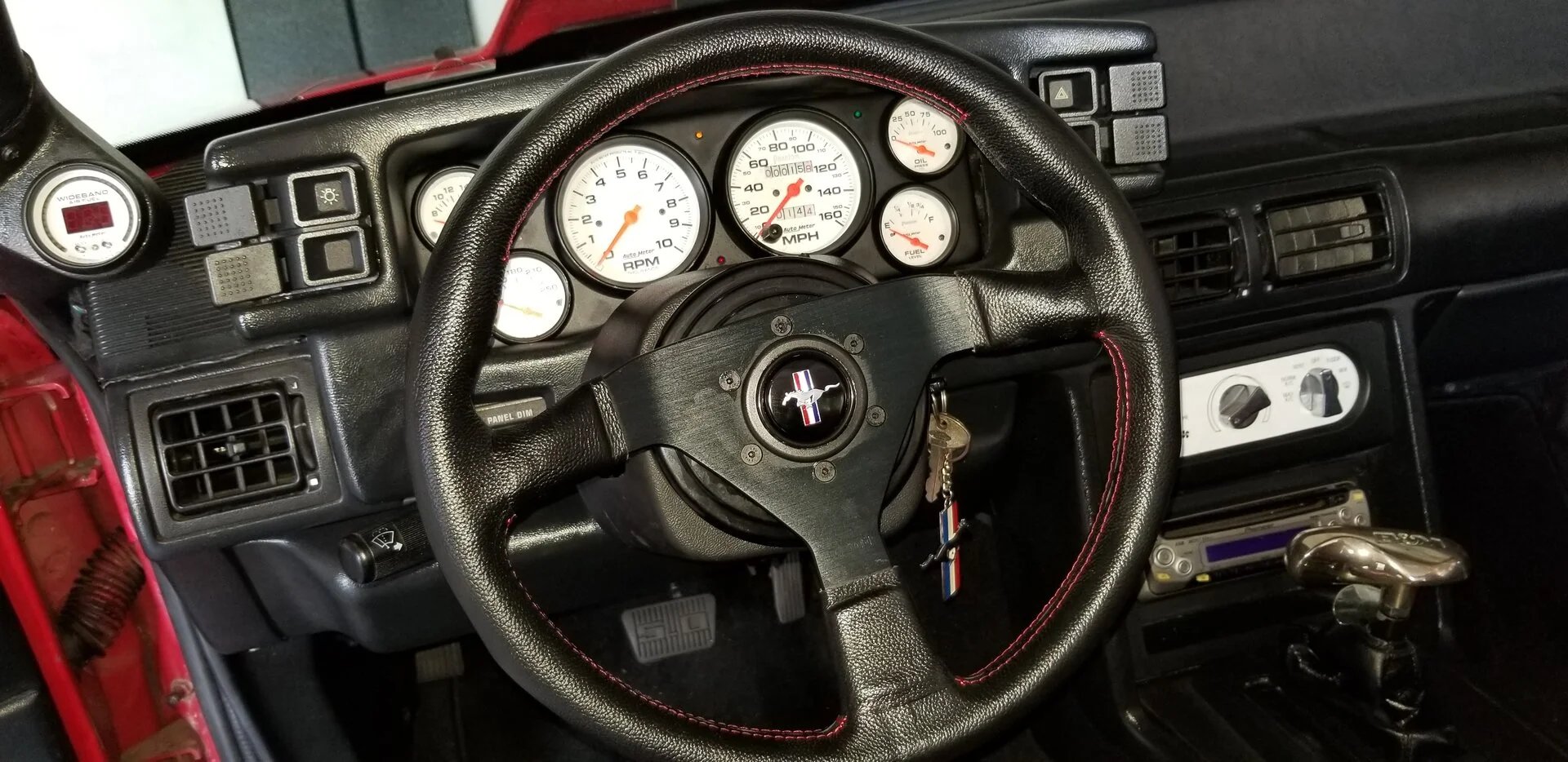

Hooked up the Horn Ground to the I believe purple wire from the factory connector
I did lose my CC but never used it.
Yes, I run a 4r70w controlled by a microsquirt.

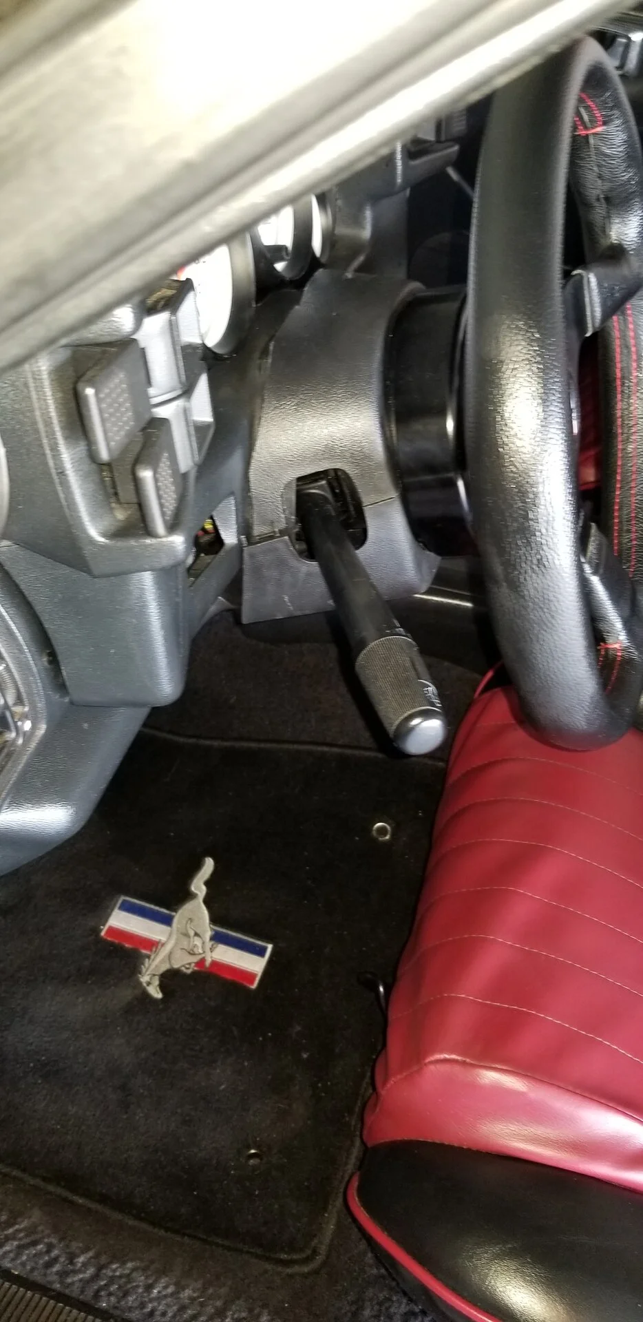

Gotta be a way to put something together cheap like this. Unfortunately putting something together like this seems like it would be ridiculously expensive when you factor in the wheel and column swap as well.
I'd just stick with the 90-93 wheel you have now and call it a day after repurposing the buttons
That was my plan. I have 2 options...
Use the horn buttons and press both for horn...
Or use the on/off or set/coast buttons.
I could of course mount anything I want to the wheel as long as I can make it look right.
