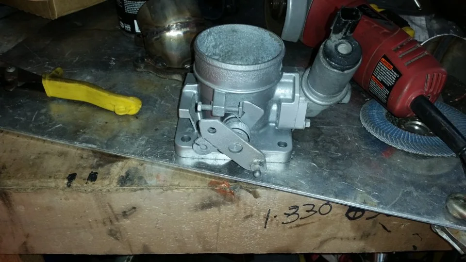

Okay so I tried fiddling around with option 1 to no avail. So today on my way home I stopped at the local u-pull-it and scored myself in Explorer upper with 65 millimeter throttle body I may switch to the Explorer upper from my Cobra just so I have more room we shall see. Right now I'm doing some fabrication I will see if I can make this system work again with two throttle bodies it should it work before. I modified the 65 with a new throttle linkage plate obviously even if I have gotten the Fox throttle body one cable is pulled further than the other based on the geometry of the holes so I copied just the throttle pole and duplicated it this way both throttle bodies are pulled the same distance I'm going to try to get any vacuum number in the supercharger piping it probably won't happen or will cause issues so atmospheric will have to be acceptable here's a pic of my modified throttle body

That's too bad. I was hopeful that it would work. At least you were able to quickly get a second TB quickly. I'm looking forward to seeing this work.

Ha! Already does lol... have do route throttle cables but as of right now, after slapping it all together and not adjusting anything she stumbled to life at 500 rpm.
