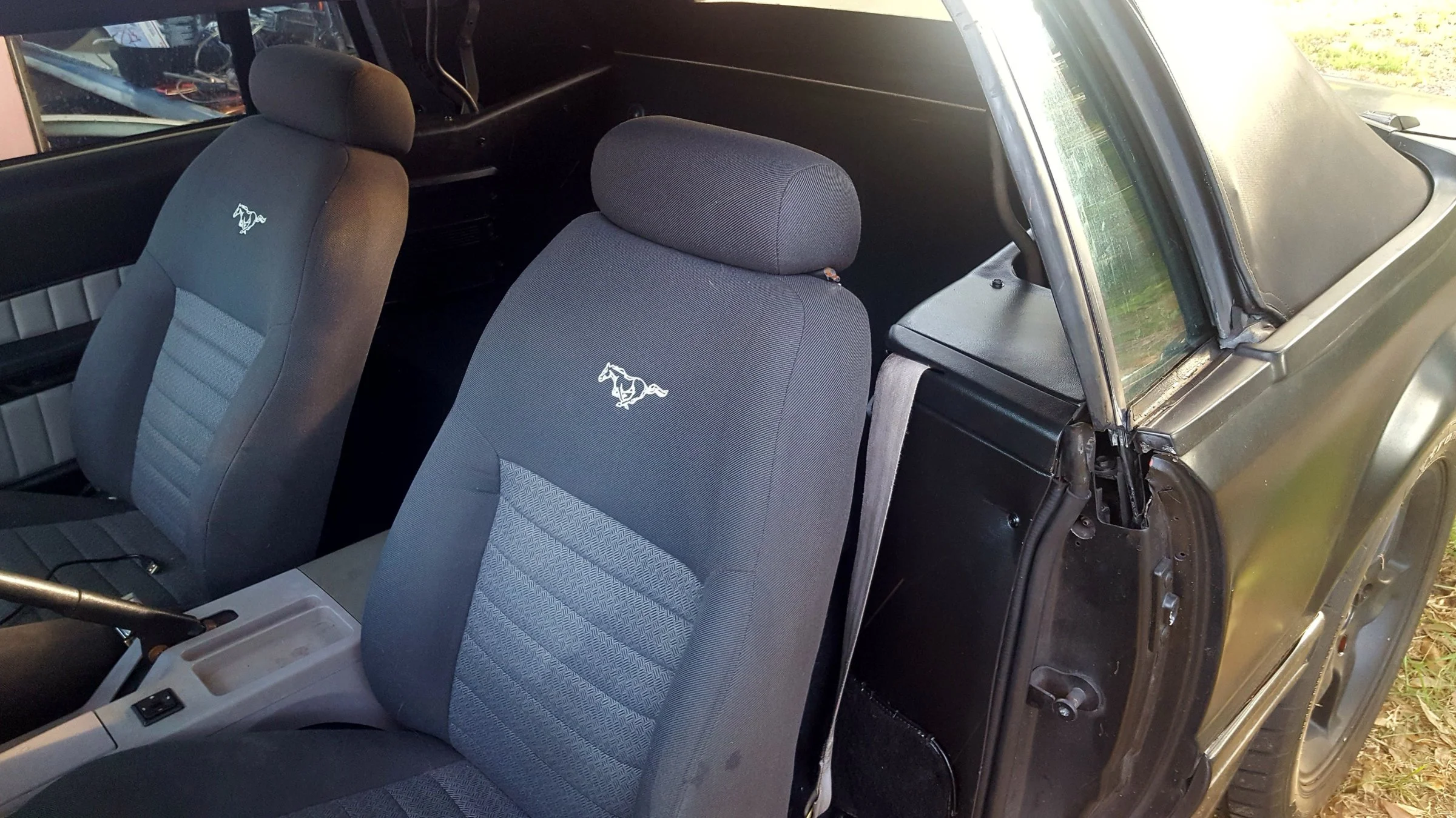

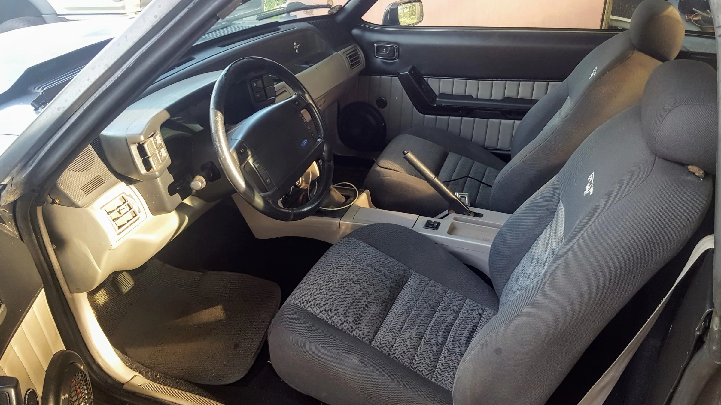

a91what said:
Got the seats in today, wired the driver seat up and was happy it worked. Can't wait to drive this thing.
I need to clean the driver seat up a bit, what can I use to clean it while it's in the car?
