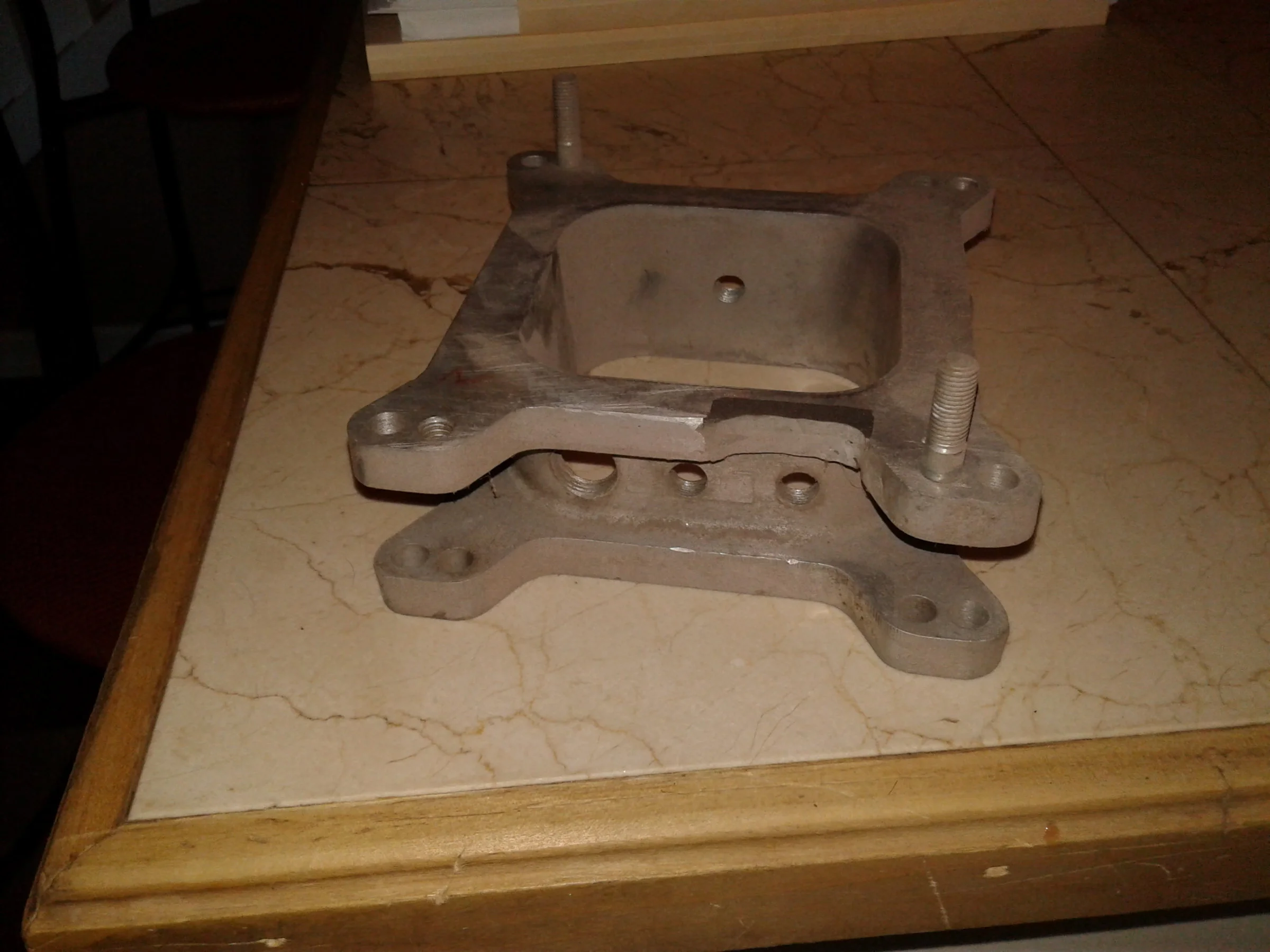

That's how it's getting mounted regardless, I'm not going through all of that ever again. Intercooler is going away, water injection is happening. I just have to find some of the other necessary parts. I want to separate the belts and put a.c. back on the car at some point.
I still need......
-vortech or similar crank pulley
-aluminum plate to build ish with
-1" thick aluminum carb plate (if what i have does not line up this is to weld to)
-parts for diy water injection system this I can consult YouTube about.

I assume that you will be putting EDIS on it then? Wont that thing end up poking out of the hood?
I mean,..not that I mind a huffer hanging out all high and proud,..I'm just wondering if your present hood will accommodate the standoff.
I wish I could help with the stuff you're doing, but you don't need it. Hopefully,you'll get the blower relocated and get this all sorted out, during which I'll have to be content to throw out one liners that leave you unsure about it's intent.
Then I'll fly down there and we'll have a driver side spark plug removal party,... and celebrate the fact that they can be changed completely out in less than 10 minutes.

I have this: it's twice as tall as you want but it's tapped for every damn iat, injector, map sensor you need.
Reactions: a91what
