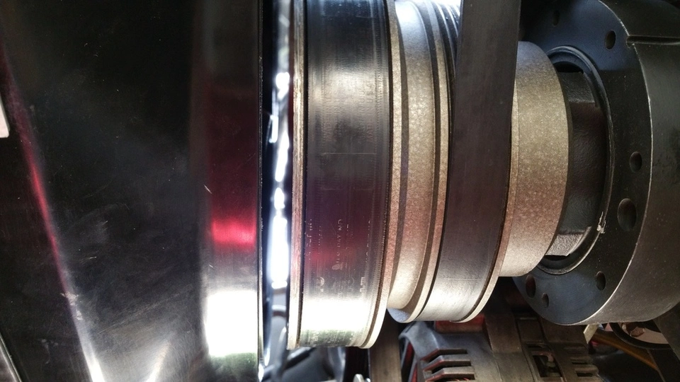

I tried to find a larger crank pulley but no one makes one. I looked at trying to get a 460 serp. Pulley but they are hard to come by and all my options require mod ding the new pulley to fit.:shrug:
If you have a source for one I'd love it.

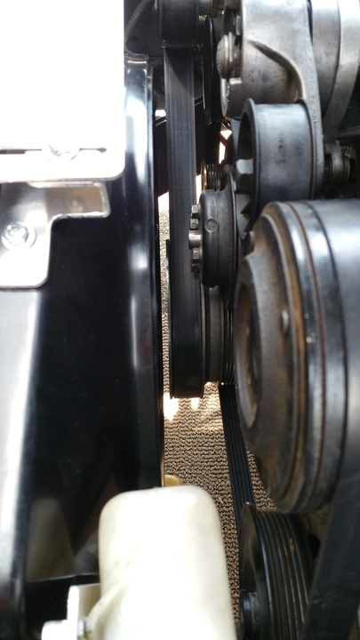

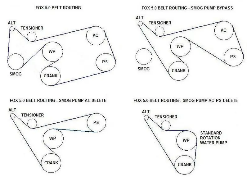

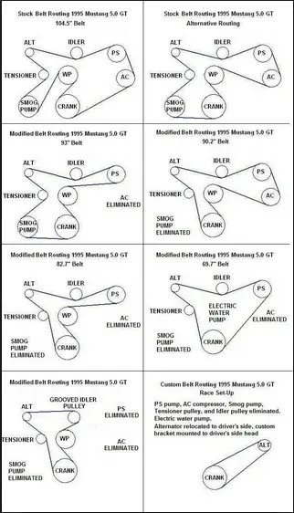

Also, they only way to check your water pump for correct drive rotation is to remove it and look. You might be able to hook up a water pressure guage in the heater hose/water pump line and test the pressure.
Something else about this. You might check your belt routing, its possible you have the correct pump but the belt routing flipped backwards on the pully. From what I could see in your pics it looks correct but you might double check that.
This is stock.
Also found that an f150 5.0 runs a 6 5/8 crank pulley. Might try and source one but it still won't get the charger spinning high enough. Threw my first belt yesterday, so I'm working on getting the pulleys realigned
