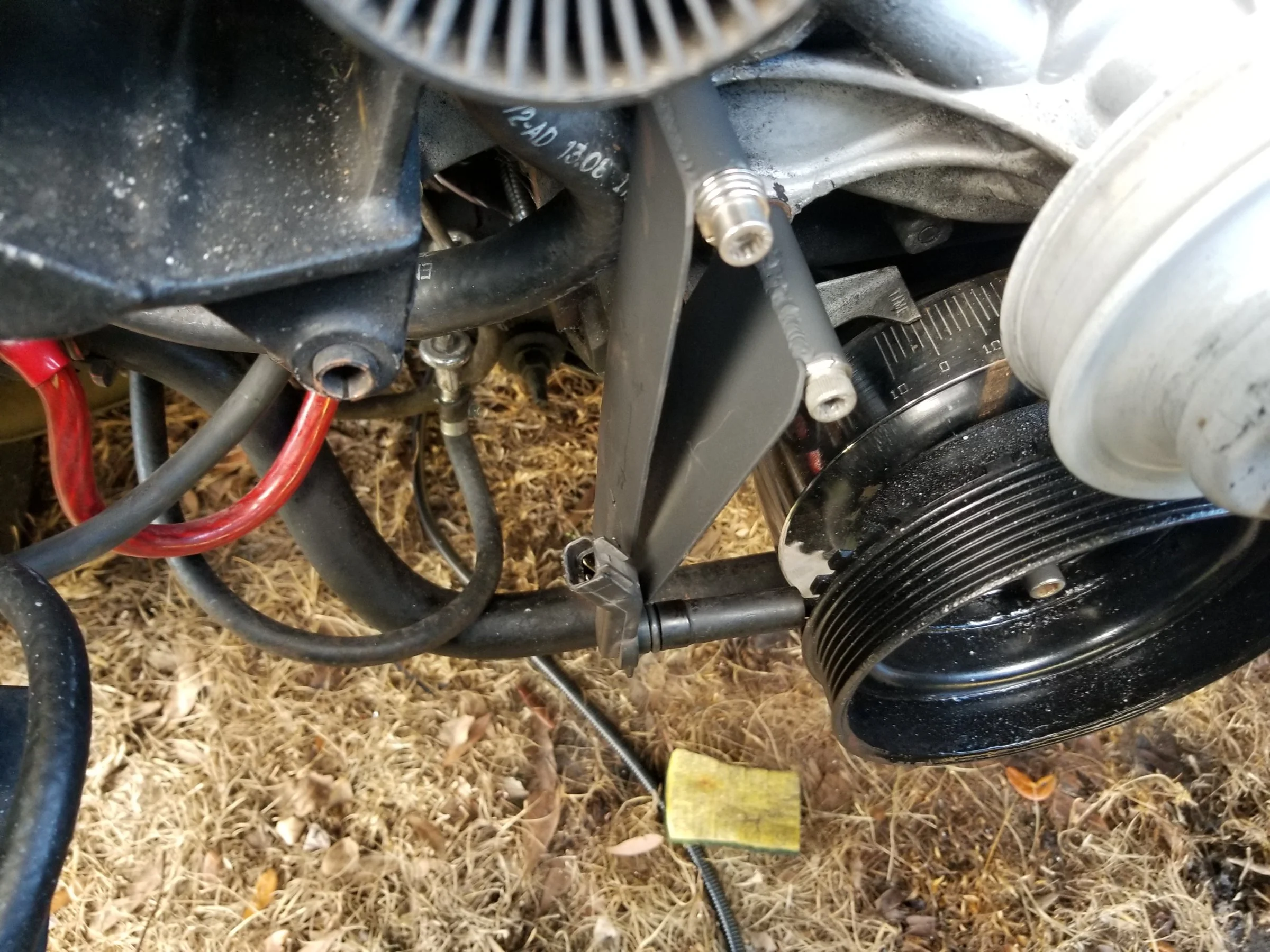

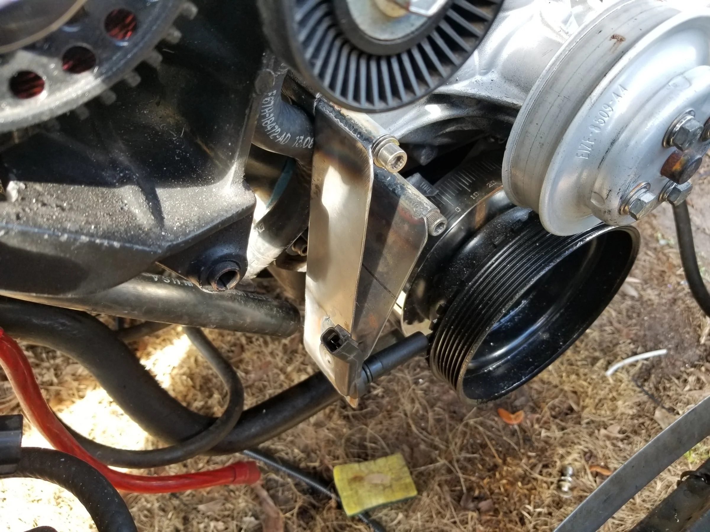

building myself a vr sensor bracket that will 1- work 2-nice and rigid 3-be out of the way of the belt. then I powder coated that sucker black

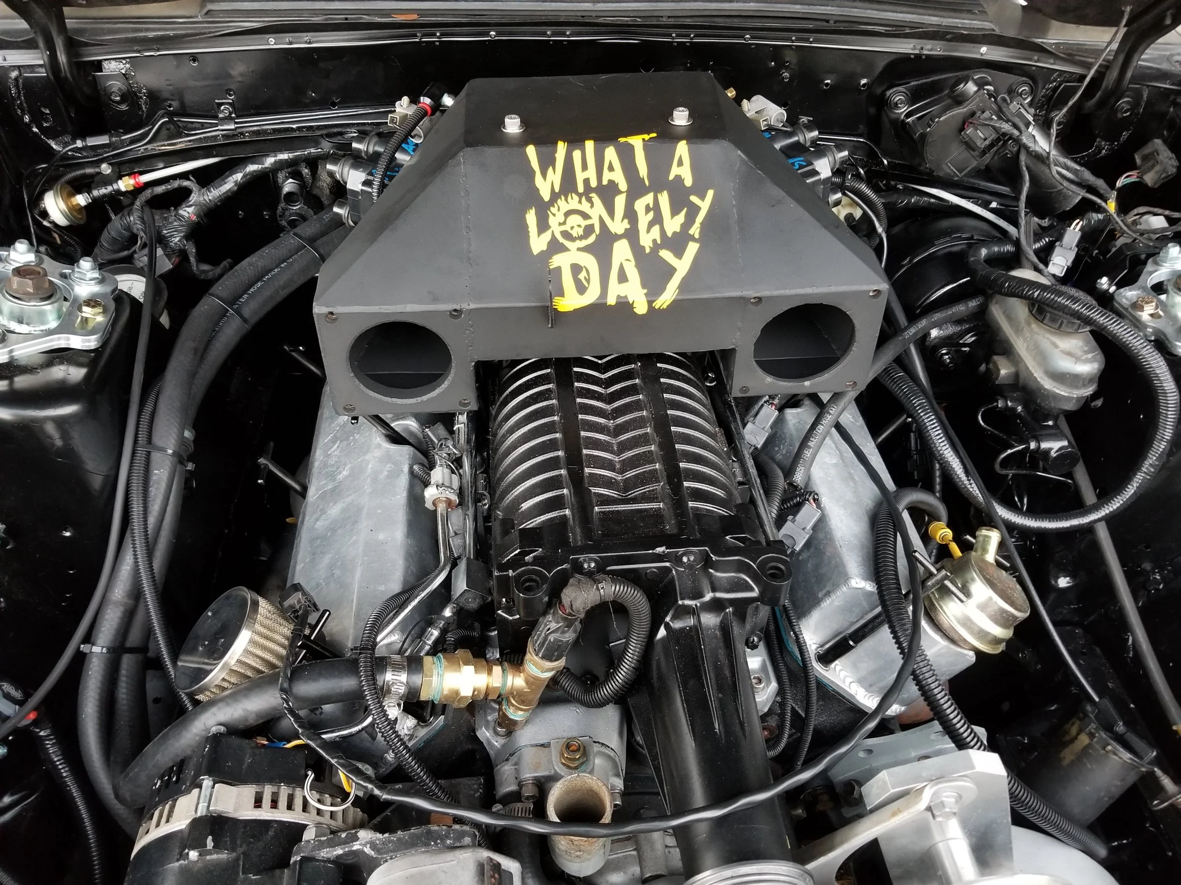

i managed to get quite a bit done today, the manifold Is iinstalled (obviously) my elcheapo eBay powder coat kit has paid for itself many times over....
The wife suggested the mad max sticker I like it alot.
I then installed the meth nozzle and coil packs.
This doesn't seem like much but it took me all day to get this much done.

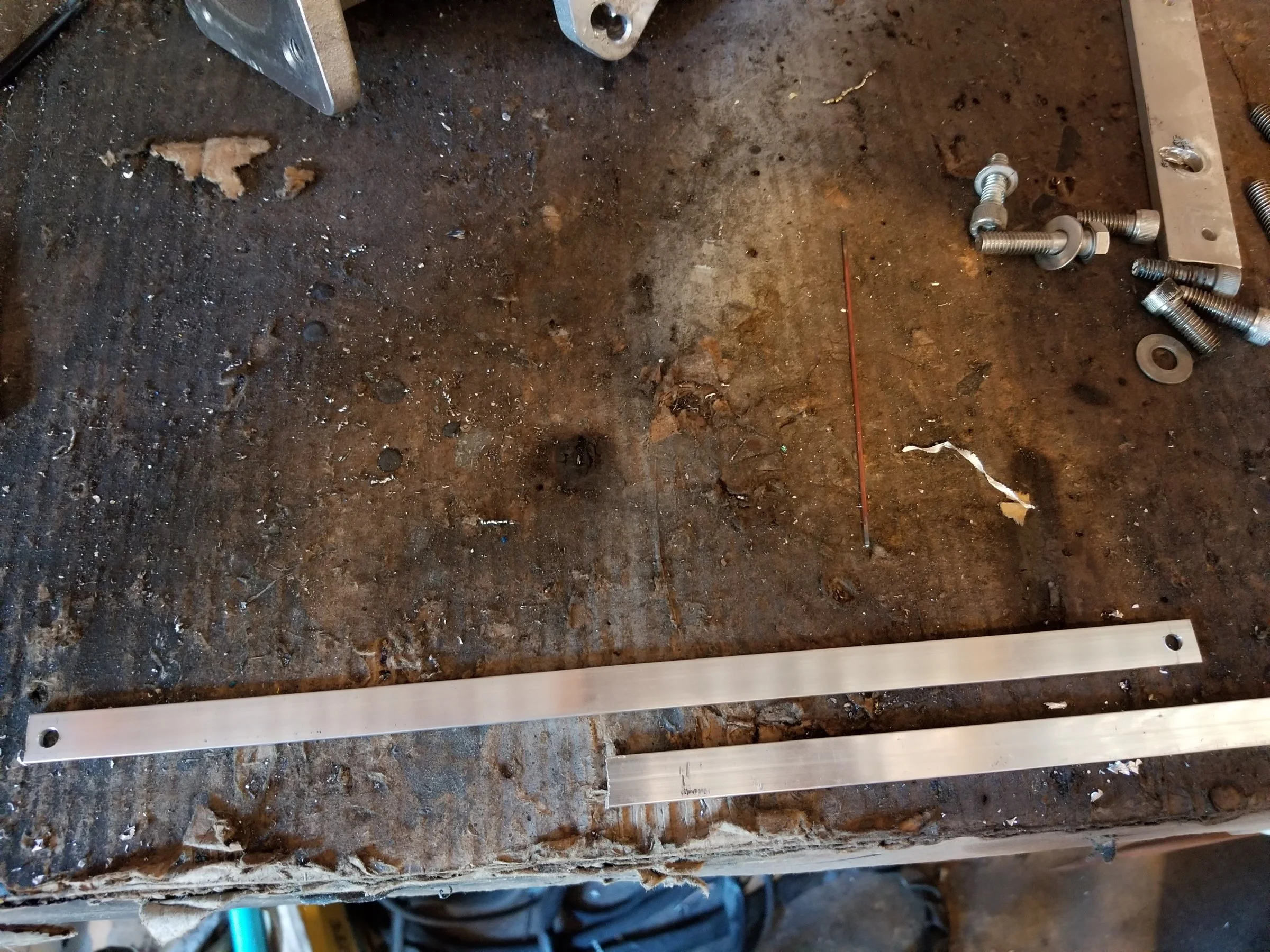

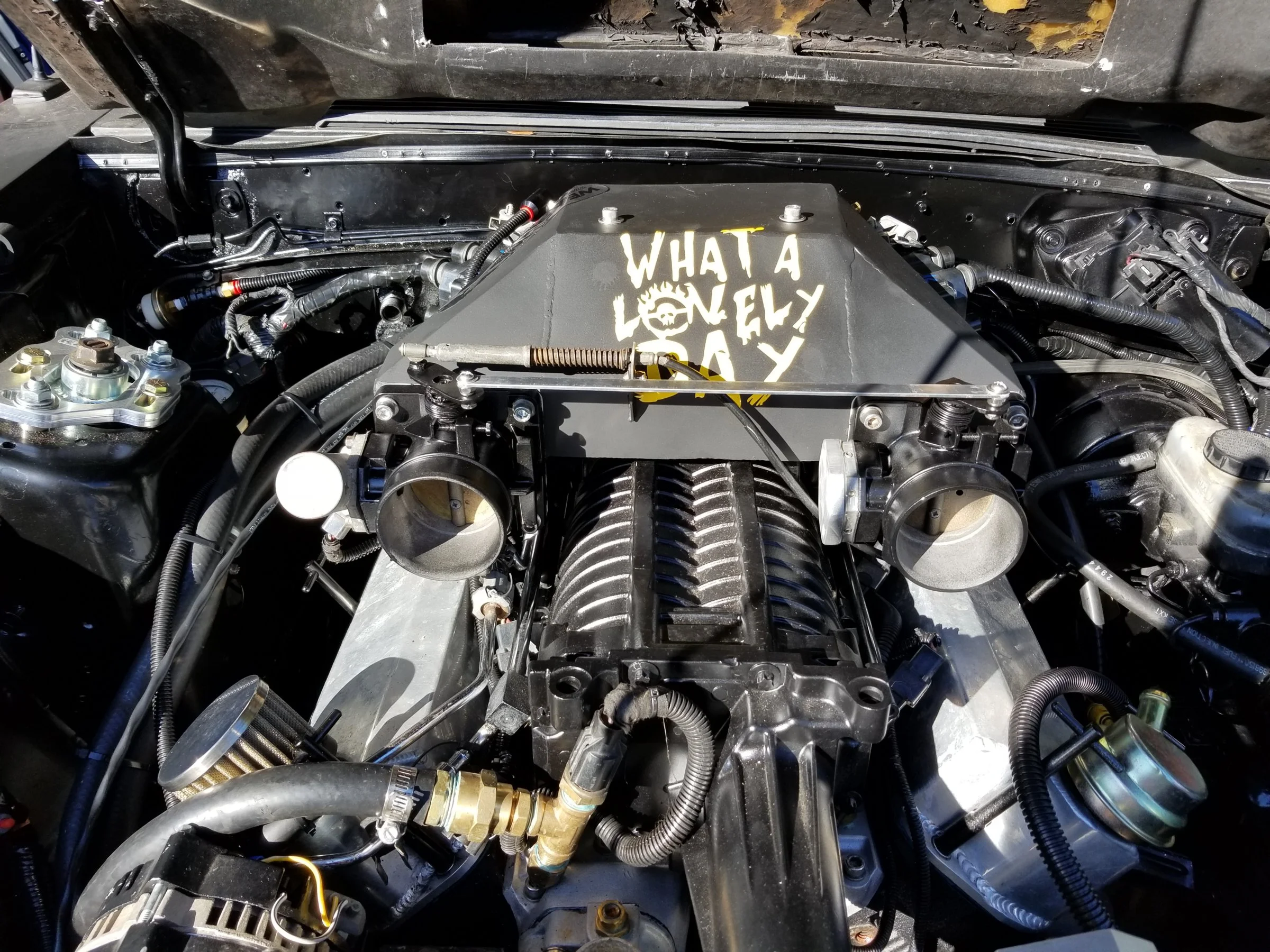

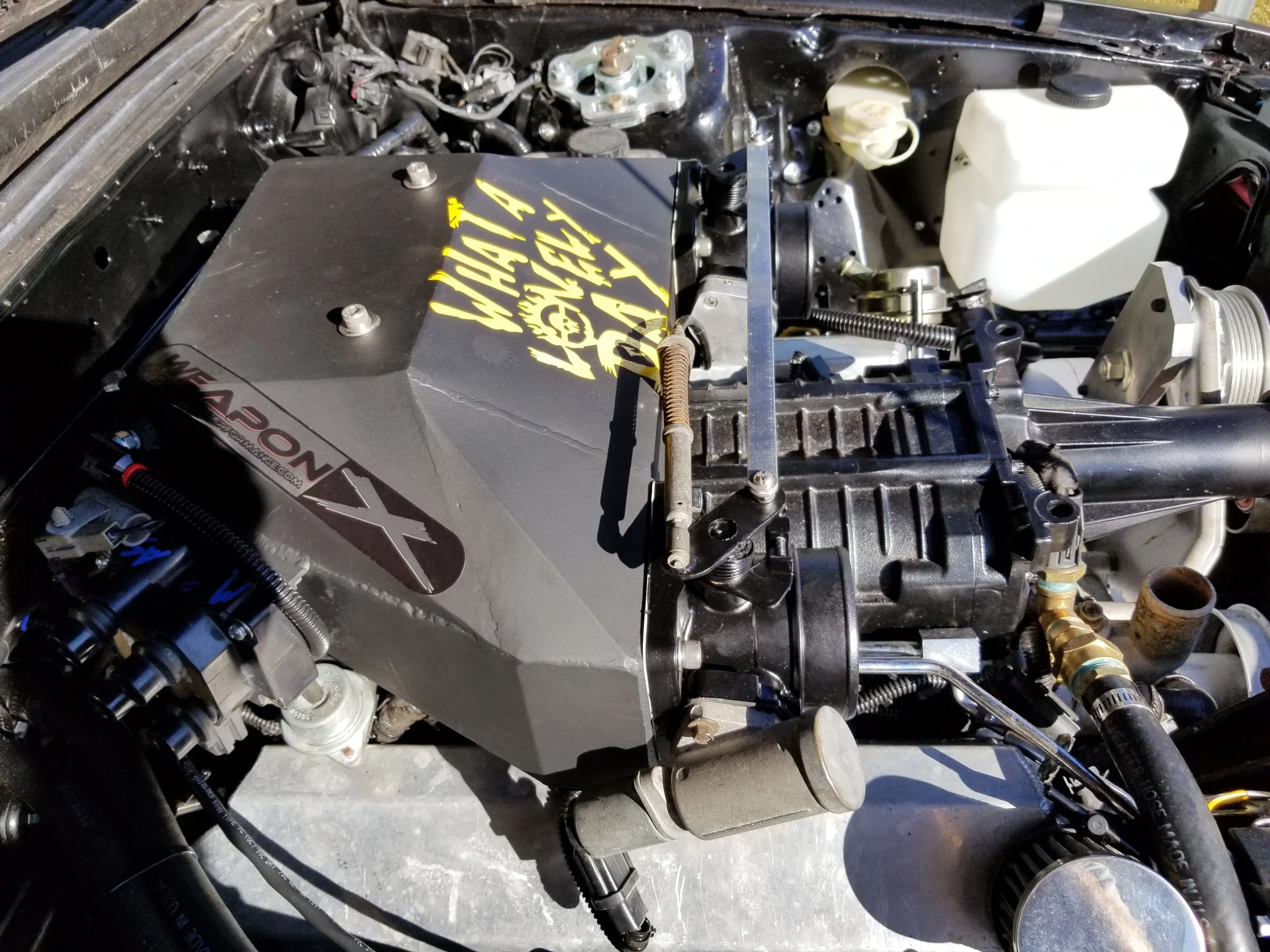

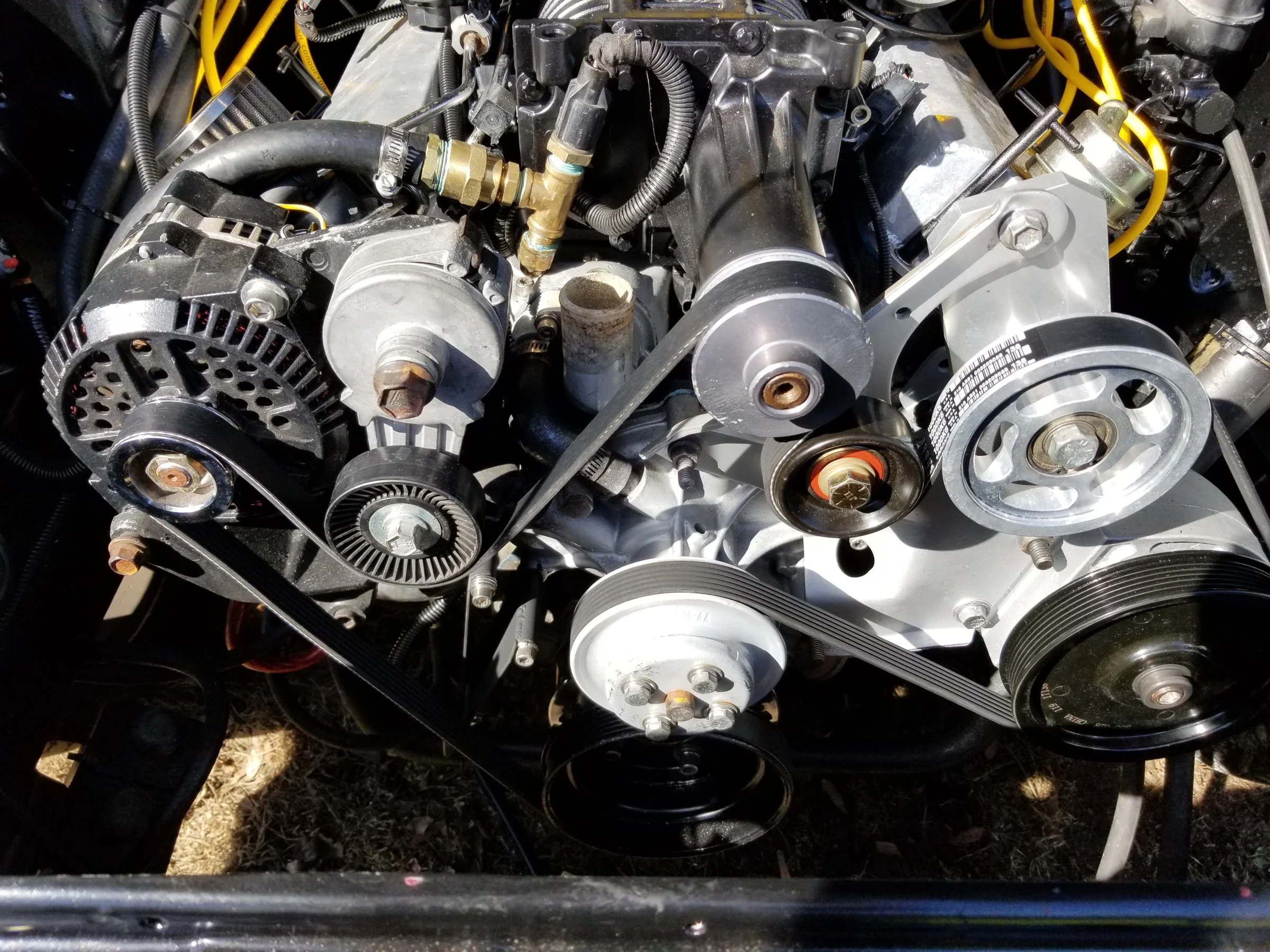

Before setting out for work today I decided to try and get the throttle bodies installed. In proper fashion I also had to fabricate some kind of thingy to make both those dealieo's work in tandem.... linkage kits can run anywhere from 20-100$ depending on how fancy you want..... ahhh no.
Enter the hero of this story a piece of aluminum bar 3/16 thick and 1/2 wide.
BEHOLD! My 1.28$ linkage!
ok ok I lied the 10-24 stainless hardware adds maybe 2.50 to the mix so......
BEHOLD! My 3.78$ linkage!
Not to bad.... problem this is my test belt 100" long... notice the tensioner, I don't think it's going to do a damn thing in that location....
I'm looking for opinions on the tensioner situation possible fixes any input will help heck maybe you see a belt route I dont.

I don't think you have enough wrap around the crank pulley, especially considering the huffer.

same amount the other setup had.... a little over 180* of wrap.

This may sound obvious, but why not a shorter belt. Doesn't your tensioner pivot further to the right like the stock one does? This should also give more wrap on the supercharger pulley too, since the tensioner will be pushing at a higher angle.

I tried a 96" belt yesterday would not fit at all. I have a 98" belt on the passenger seat of my truck, just have to wait till ii get home to try it out. My thought is the tensioner my spring back too far and lock in the position in the picture.. of course I have the option of redrilling and clocking the idler arm but I cannot spring it out very far it will hit the SC pulley... I may have a need to engineer some kind of manual tensioner for the static pulley I added.

My sc engine has three seperate tensioners, there you go, just throw another one in that extra room you have there.

I say to mount the tensioner below the alternator. Put an idler up top to keep wrap on the alternator and the blower and raise the belt up a little bit.

The monsters belts are manually tensioned...F that spring loaded junk.

I will look into this option seriously when I get back to the house, i still have that 04 cobra tensioner and some 3/8 steel plate... maybe leave the stock tensioner in place and add the second one.

Why not run the Ford ac delete kit rather than the delete pulley?

Plan to add ac later so the pulley is there to account for it in mockup.

Air pump delete pully?

wouldn't that pull the belt further away from the crank and make less belt wrap??? I guess I could put a smooth idler on it instead and it would make more belt wrap. wish I had one on hand to see if it would be viable

I was thinking the same thing, use a smooth pully, I have one or two that are used on a 7.3 ps I just have to pop a new bearing in and I even have the bearings already, lets get together and I can dump the ac stuff on ya.
