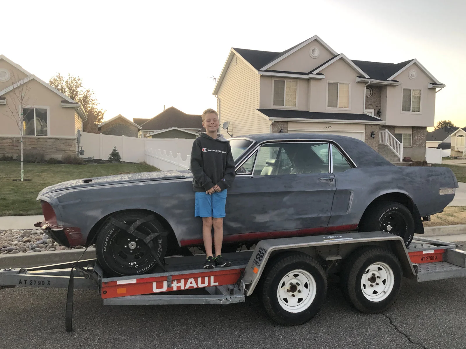

I just picked up a project car in the form of a 68 coupe. Some previous owner swapped in a 351w that I'm told is stroked to 387. That probably means it has 302 pistons, stock rods, and a 3.85 crank.
Assuming that's accurate, what's a general ballpark for horsepower?
Cheers!

That's exactly what I was looking for - thanks a ton! I'm about to take the engine and transmission out so I can start the exterior restoration. I'll learn more about the block, head, and carb during that process. So far driving it feels like it's in the 300+ range. It's a total kick to drive. One of the previous owners put some work into the engine with the stroker kit, but also added traction bars 11" rear wheels, and a few other street mods that make it seem like he was going for a drag race setup.
