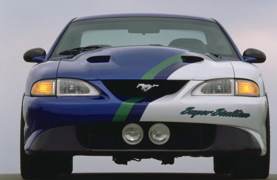

i remember the super stallion concept back in 97, was designed to run on 93 or e85 and would make an extra 45hp when on the e85..
