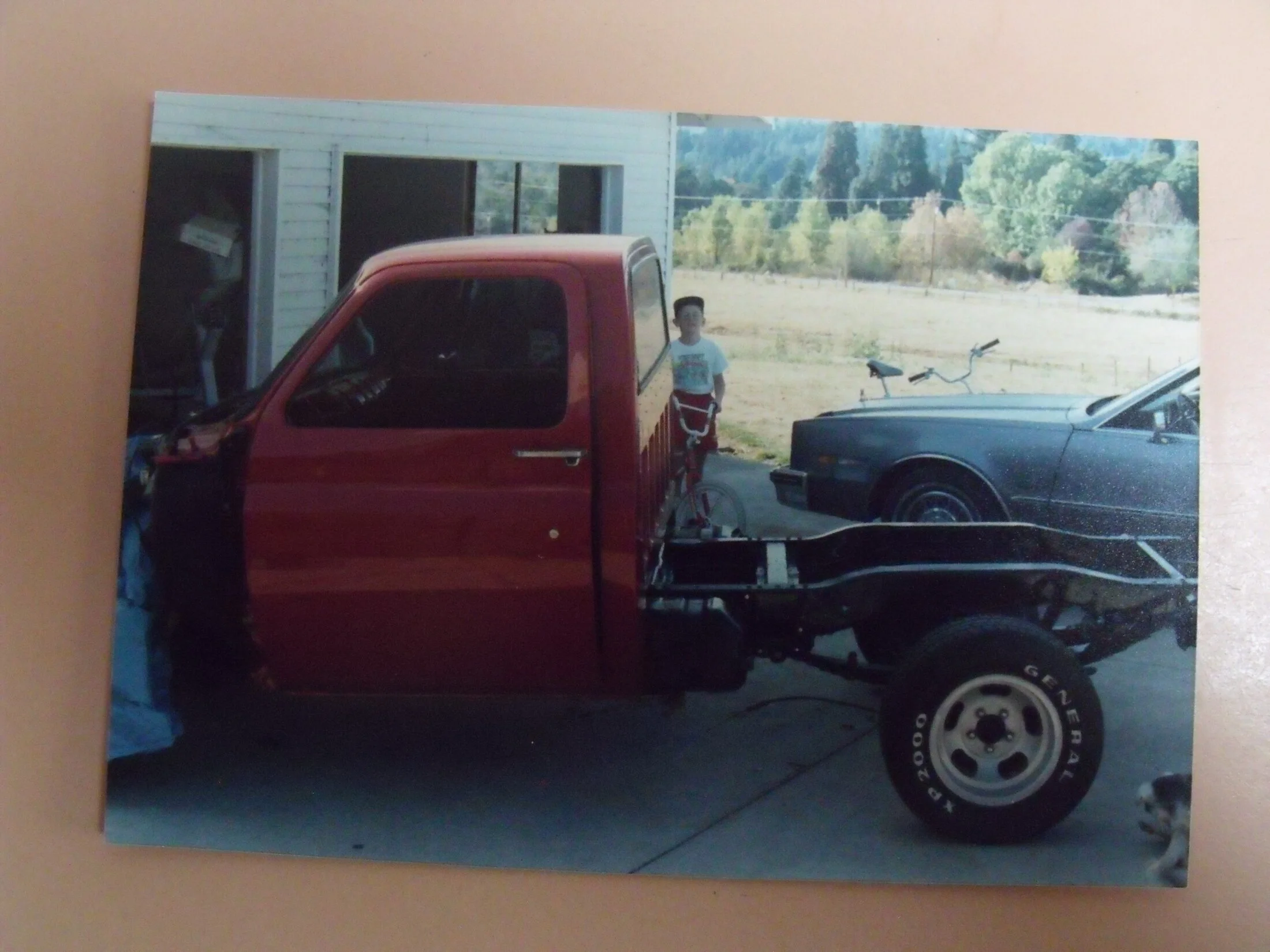

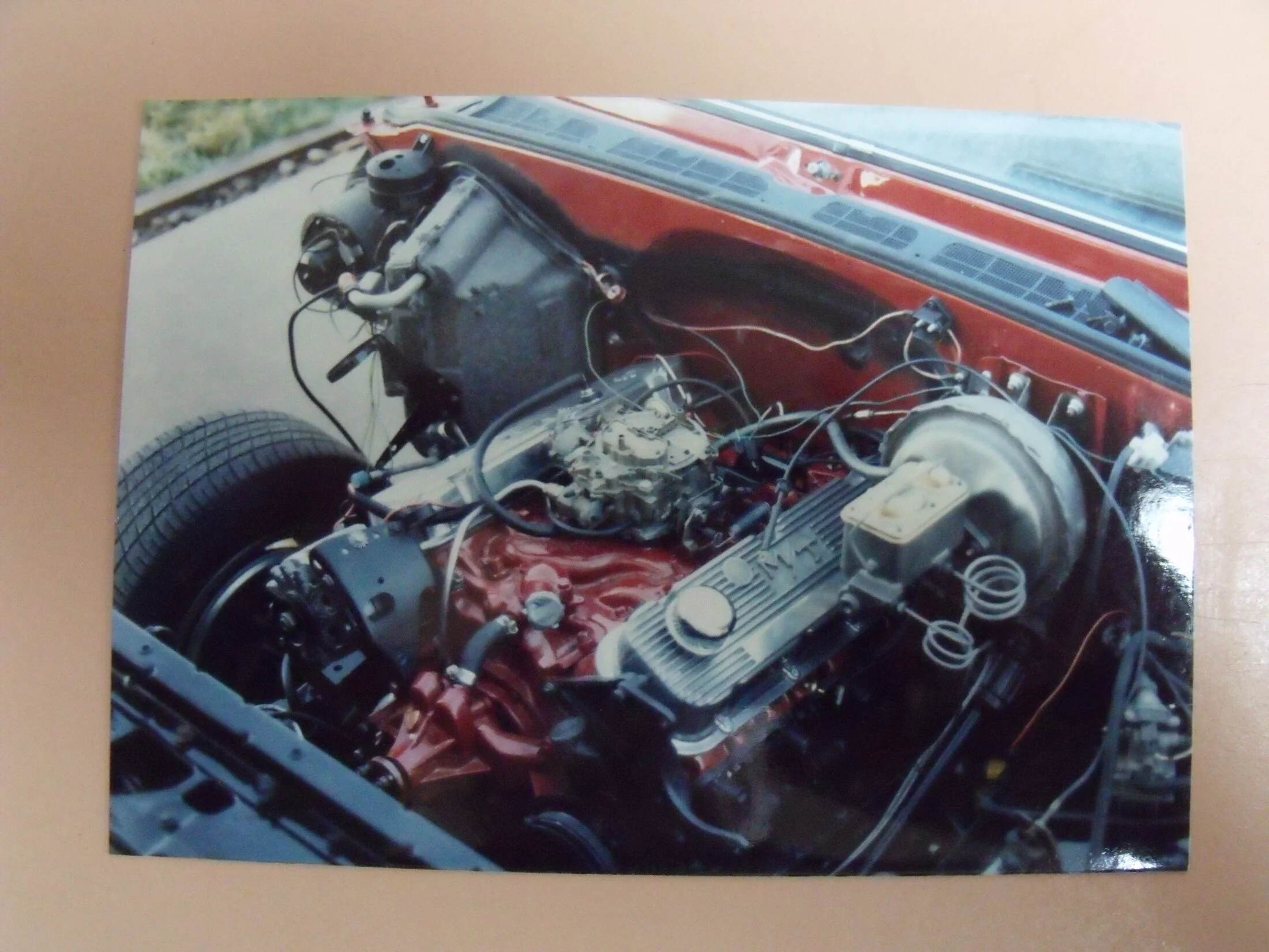

When I did my 77 Pickup ( in the pictures) it had been hit in the front corner and the frame had " diamonded ".. A big mess and of course the truck was being put back together when I found this... The engine fan was sitting crooked in the fan shroud from side to side... It was never done right ( even though I spend a fair amount of money on the local Chevy dealer frame rack) as it really needed a new frame and front crossmember, so I understand what everyone is saying here... TY
Today I would have bought a new aftermarket frame for it... Not sure if they were available back then and there was NO internet to find out.....

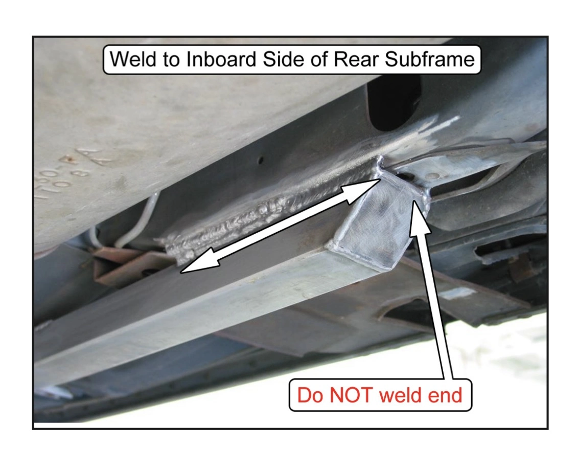

I welded my own SFCs. Theo one spot where the exhaust affect my ability to weld was at the rear inside where the mufflers sat. My flowmasters were pretty close to the outside so I couldn’t get the best angle to weld there. Put a lever in to push the muffler over and made it work.
Later on, when I took my exhaust off to install the Borlas, I got back in there and added some additional weld to that area.
Edit: here’s the spot I was referring to. The install directions show tons of clearance, but I didn’t have this with my cat-back
Edit: this is out of the MM instructions. Not my welds
Reactions: Scrapla347 and limp
