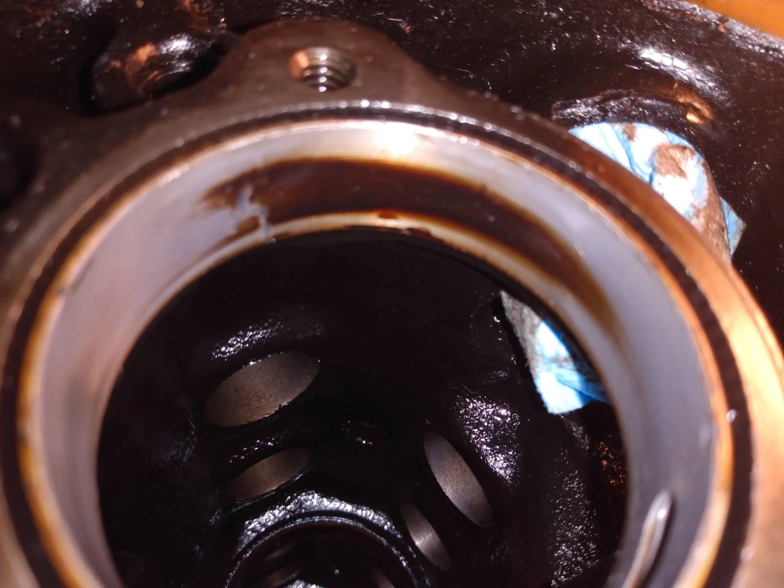

I have the heads off and found a bunch of scratches in the cylinder bores. They aren't very deep but my fingernail catches on them. It didn't smoke and I am beyond my budget so I'm gonna cross my fingers and hope.
One thing I am puzzled over is the oil filter was empty when I removed it. It's heavy and has oil in the filter material but nothing ran out as I loosened it. Dumping it out got maybe an ounce. It's been 2 decades since changing a 302 oil filter but they always dumped about a quart of oil out if I remember correctly. Could my oil pump bypass be bad or am I looking for a problem where none exists?
Well, I am puzzled no more. The pic below is the front cam bearing looking up. I think the filter clogged from gunk that came loose using Marvel Mystery Oil. All the cam bearings were dry but it was running just a couple days ago. Oil pressure was fine. I had good flow in the heads then. I should have gone through it during the swap but trying to save a buck again bites me in the ass. She needs a complete rebuild.

That sucks, but it also gives you options. You could try to find an Explorer 5.0 and swap that in using the heads you have. That would give you the benefit of a roller cam, but the cam you just ordered would be better off being returned and replaced with another. If you're not looking to get maximum power or anything you could hunt around for a 5.0 HO cam and use it, you can probably pick one up pretty cheap if someone out there is building a Fox 5.0. I'd venture a guess that an Explorer engine will cost less than machine work and any accompanying purchases like pistons. It would also solve the problem of the dry rotted damper since it should come with one installed. The only thing to watch out for is the balance issue, I'm pretty sure the Explorer engine is a 50oz imbalance whereas your original is a 28oz, so you'd need to have the flywheel/flexplate rebalanced. But I think even with that you'd come out cheaper than a full rebuild. :shrug: Just something to chew on.....
I found a local shop who is going to work with me. With the low miles, knowing it ran, and it wasn't smoking he thinks it will be reasonable to dip, hone, re ring it and new bearings. I see 040 stamped on the pistons so its already bored out. He ballparked, sight unseen it's about the price of what I am seeing 5.0 motors with the computer and wiring. He will then use my parts and make it a long block for me to dress out myself. That way if valve clearance is an issue he can address if necessary. This saves me from machining the II flywheel for 50oz.
I should have gone 5.0 from the start but wanted to keep this engine for sentimental reasons. I don't regret it although I would have done it differently in hindsight. Now I will have more into it but at least it's going to be new. A used engine that I bought would have ended up a paperweight with my luck anyway.

He is doubtful after seeing the cylinders and it being .040 over already. He said it looks like 135,000 miles with the ridge build up and scoring. I personally opened the crate after picking this engine up at Northgate Ford way back when. I know it only has 35k but obviously they were a hard 35k. Sitting for decades didn't help either. So we shall see.
Flat tops it is! I currently have the emission era dished pistons. One of the first things he said was they gotta go. I don't think I need forged so they are relatively inexpensive. Should bring my compression closer to 10:1 as well. If its rebuildable.
He also said he has seen a lot of sbf front cam bearings look like mine. I was worried I did something wrong but he assured me he has seen it many times. Have you guys noticed cam bearings looking burnt like the pic above?
