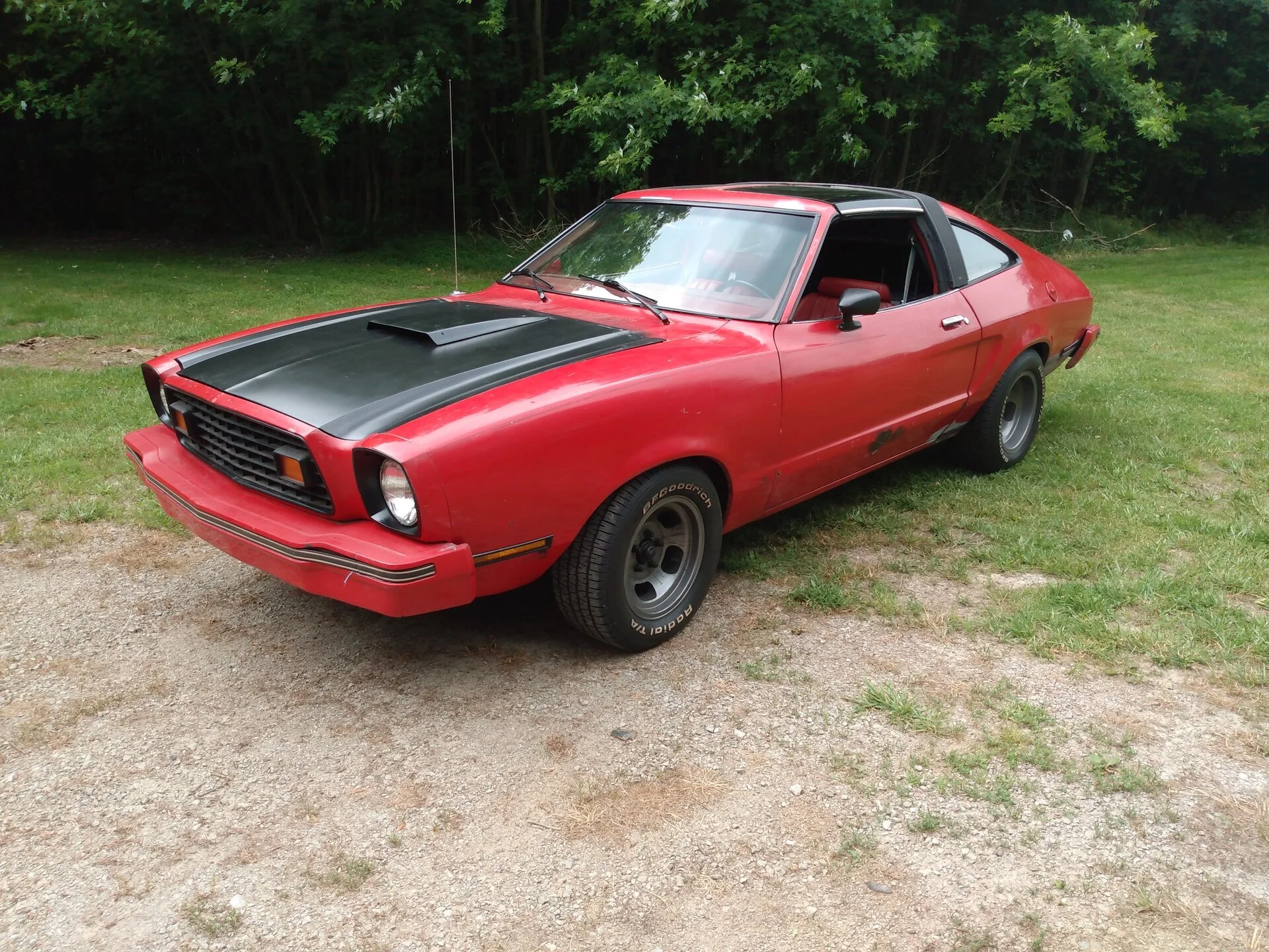

I like your wheel tire combo/stance, Just the right street sweeping stance.
I cut 1.5 coils off my stock 65 coils and it was super low (and soft)
When I switched to the Shelby 1 inch front lowering springs it raised my car 1.5 inches.

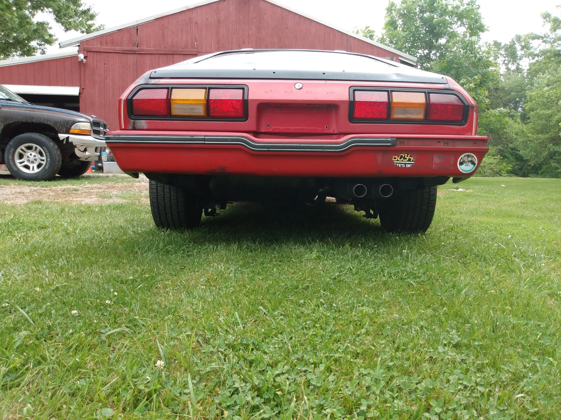

Waiting on front suspension stuff to arrive. Keeping stock coils for now. The ancient bushings have not fared well in the little driving I have done.
Had dual exhaust installed today. Used a single Cherry Bomb Vortex dual in/out muffler. I was not looking for the quiet girl in the corner. Nor did I intend to have the drunk obnoxious gal dancing on the bar. Alas here we are.
She sounds vicious. Like she missed last call and is just getting warmed up. Demanding everyone's attention. Just pissed off and rearing to go. 18 y/o me would have loved it. I am not so sure if today's me is ready for all the attention. lol

I have been lurking on your A/F thread. Just installed one with the exhaust and found out I am running pretty rich. Getting the tune kit and learning to fine tune the eddy carb is on the to do list but I have to be able to brake without diving into a ditch first.
Tomorrow I will get her back on jack stands. Saw some leaks while they had her in the air and I still have to install a shorter trans mount. It continues to shake itself apart above 55. I tried getting the exhaust guy to do it today but it took way longer than he anticipated as it was. The owner and the tech who did it said these are the hardest car to get duals over the axle.
Once these problems are addressed I am probably copying you. It just needs to be toned down but I like the sound.

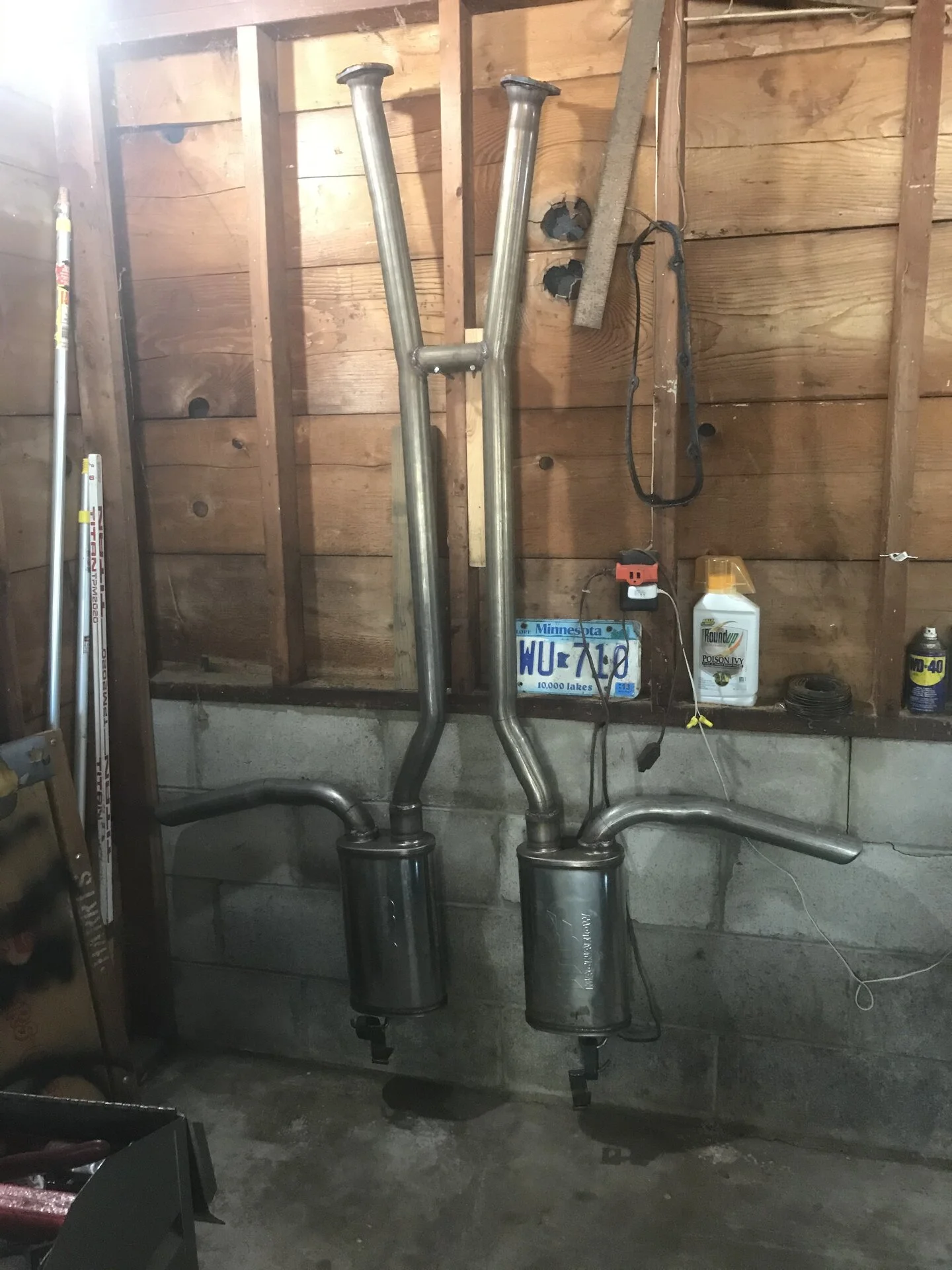

this is what I'm going with

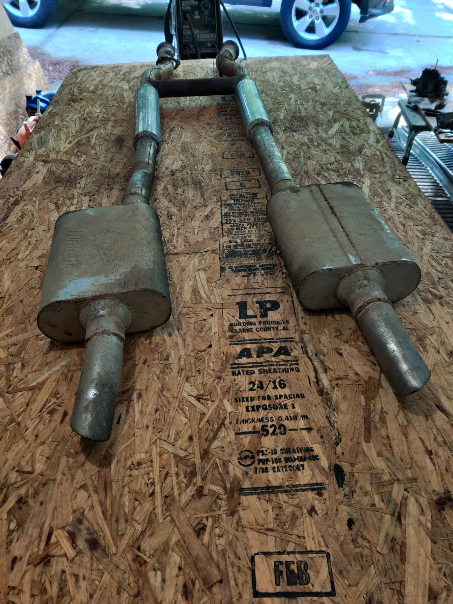

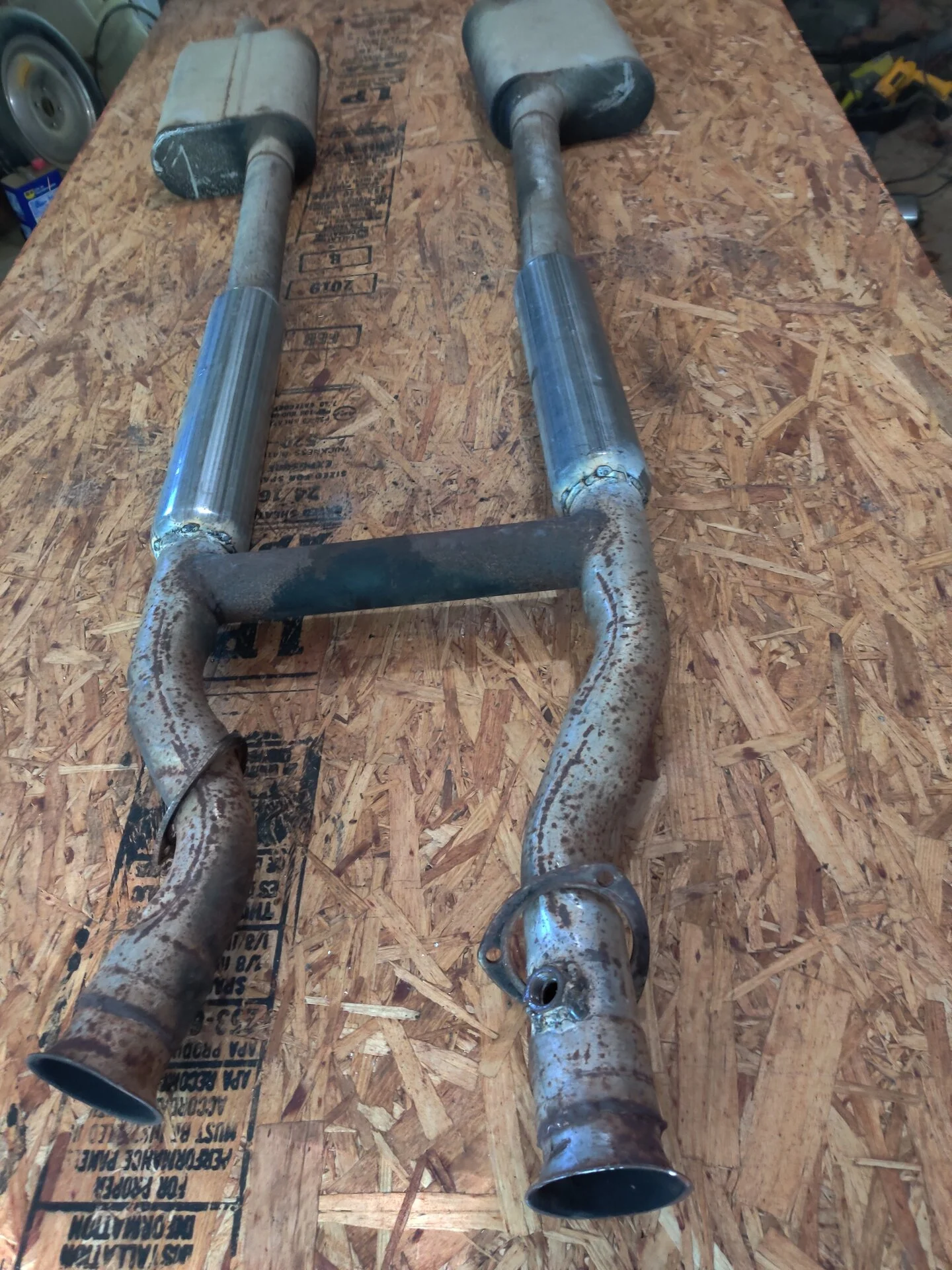

This Vortex Dual In/out should be very similar to an x-pipe I would think… So right and left side are connected?! Can you confirm that by looking inside?
There are a few options what you could do:
- install a valve in one of the tailpipes, that flow must exist only one tip if closed (that was my initial plan on my build: eat the cake and also have it with a button)
- install a DB killer in both tailpipes
- install glasspacks upfront (as LILCBRA did)
I started this week also to build the exhaust. And the tight space around the axle is really a bummer. I kept the old exhaust and did install it again to see how things are looking… I initially planned to do some 2,5'' over axles and use also a similar style muffler (flow trough design with x pipe). Now I'm going the LILCBRA design with option to swap the old over axle pipes in if i get in trouble with law :cool:
At the weekend there will be some TIG action and picture will follow.
I would love to here your car. I posted a YouTube link in my thread where a explorer is running such an exhaust and it sounds awesome with the crackling and rough sound.
You said you like this sound, than try the valve or the DB killer. The DB killer can be done by the muffler shop. Just use a smaller diameter pipe (something around 2 inch, if you have a 2,5 inch exhaust). They should be positioned in the tailpipes, so check which length can be put into the tailpipe and cut this pipe to this lenght. Both ends than needs to be widened so that the outer diameter feeds flush into the inner diameter of the tailpipe. Secure them with a screw if installed permanently.
I would try to keep the tailpipes clamped on, not welded on (in every build) to try different options.
You can also try how the closed valve will sound, if you just put a closed pipe into on exit of the mufflers.
I would love to here our car and also see pictures of the exhaust.

My request was similar to stock exhaust outlets, run in 2.5" and able to remove the pipes near the transmission easily while on jack stands. They ran 2.5" header to the axle, added a flange then had to go 2 1/4 over the axle and directly into the muffler which is in the stock location. I bought nice 8" tips but they stuck too far out and we went with normal pipes till I find shorter tips I like
Looking into the muffler you can see straight through the inlet/outlet on the same side but cannot see light from the other side. They are separated by a perforated baffle and what looks like fiberglass packing. There should be some equalization but.... I imagine it's sorda kinda an x pipe but not a true free flowing x pipe.
I will have it on jack stands tomorrow and can snap some pics then. Today is fixing other stuff, avoid tropical storm remnants and mowing day if I can. grrrr. I took a video yesterday but it's still "processing " 16 hours later according to google photos so I cant upload it yet. My phone does okay video quality but the mic is horrendous for exhaust. I've taken several videos and they sound like crap so expectations should be tempered. I had a nice camera that did 1080 video but my better half decided my kid needed it more. Needless to say it is now MIA. lol
Okay, that is not enough for half of the exhaust flow. And the idea with the valve is not the right one for this muffler.
