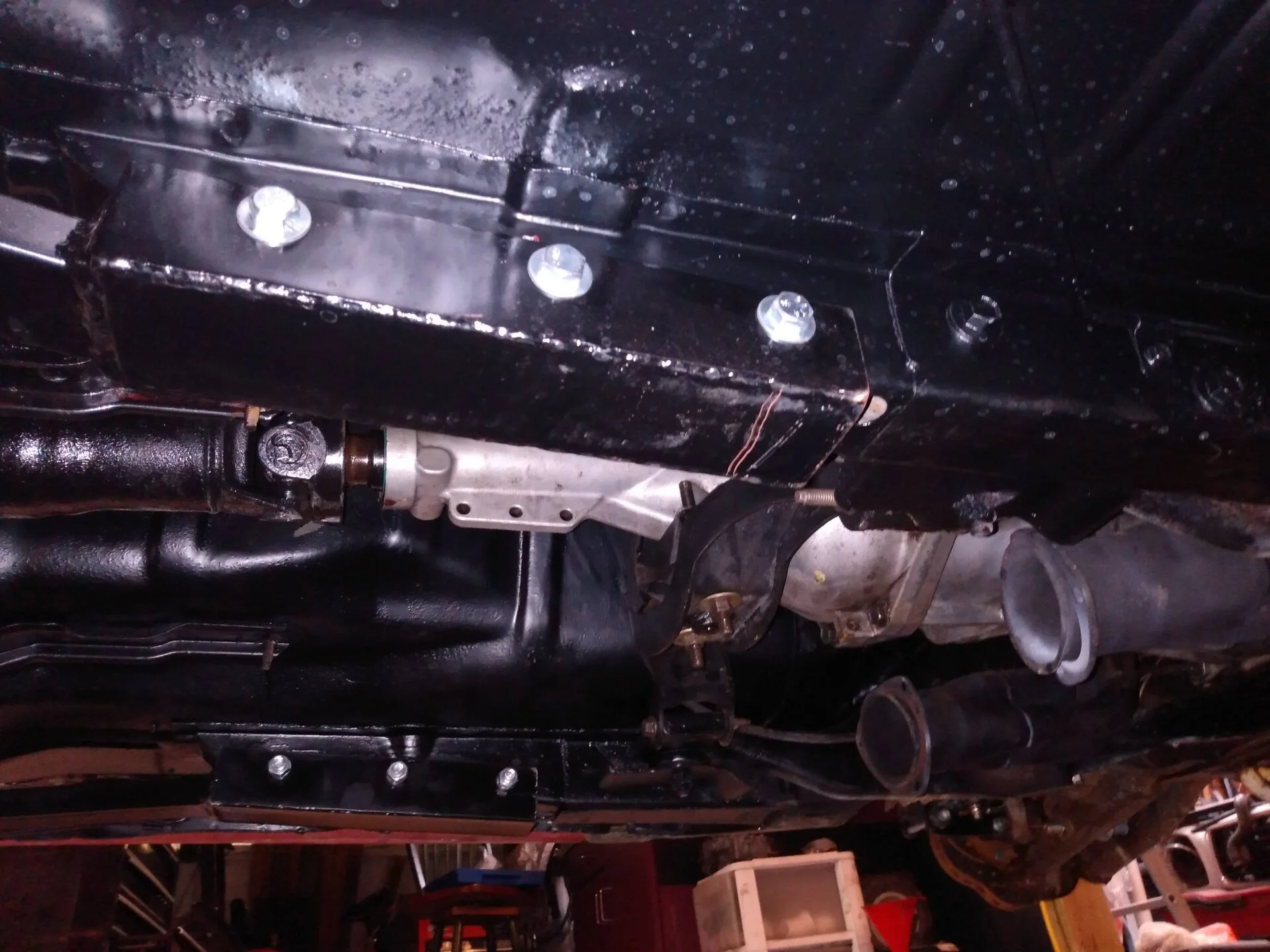

I scuffed the bottom, wire brushed the flaky rust. Then used alcohol to clean the chassis. I then applied corroseal. I was not 100% happy with my results. It did a decent job, 95% converted. I probably fudged something up prepping the surface. Even so, I never want to do this again. When I was younger I didn't mind but my body doesn't appreciate crawling around on the ground anymore.
So I did the next logical thing. I started the process over. I scuffed the surface again, hit the remaining rusty areas with the wire brush again. Purchased the $22 por15 kit. I did need a second 4oz can and the top coat. This was enough to get from the torque boxes to the front leaf spring mount. I used their cleaner, metal prep, the por15 then top coated it with their chassis black. It looks beautiful on jack stands. Hopefully it holds up for decades.

Ps, When por15 says wear masks and gloves they mean full head to toe tyvek suit if doing this laying on the ground. My wife laughed her ass off as I removed clothing to take a shower afterwards. It soaks through clothing very easily. Then will not come off. My back and arms look like me and the tattoo artist had a bad acid trip getting jail tattoos. My grey beard has dark black areas even with a respirator. On the bright side I dont have to worry about my arms or back rusting for a while.

I had a similar problem when I sprayed the underside of my car with POR15, though it sounds like I was covered a little more than you were. And I didn't have a beard back then. But I did have black freckles for a while. :rlaugh:

The wife laughs and takes a pic of the top of my head yesterday. 3 Days post por15 debacle. Then shows me a pic of some guys bald spot with a huge black blotch of what looks like por15 on it. I am not sure what she is getting at by showing me some other guys bald spot but.... Ahh. :poo:. Morale of the story. Wear protection when using this stuff.

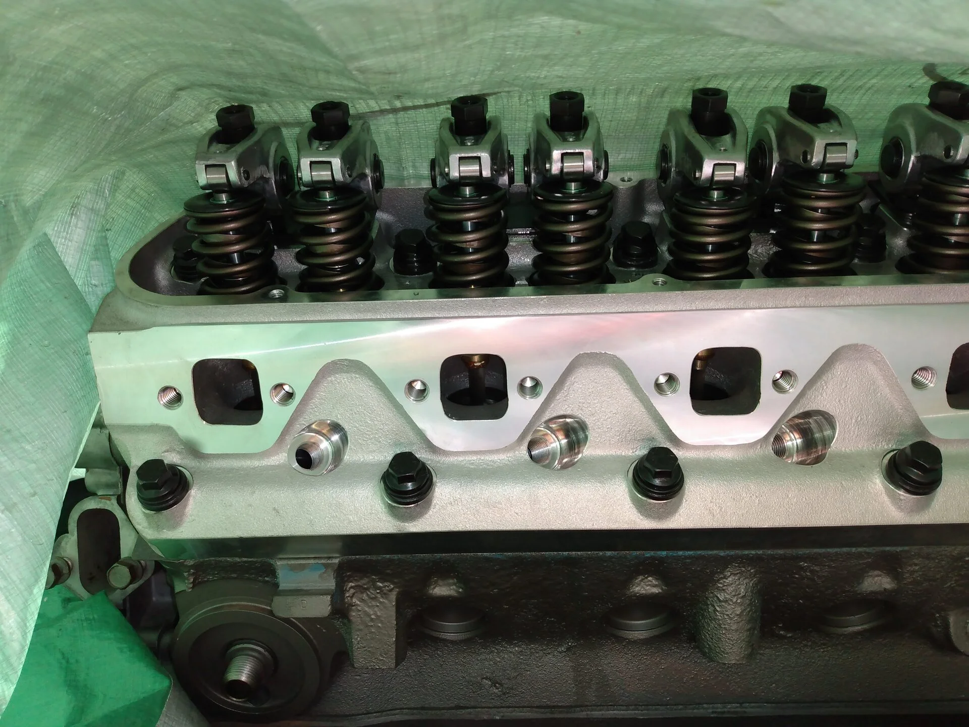

Engine is back from builder and in my truck bed as I write this. Once the ground is dry enough I can get to my barn and temp gets back to a reasonable number final assembly and install begins. I am waiting on a couple odds and ends but hopeful it runs in the next week. It looks gorgeous in my red truck wrapped in a green tarp with a silver chain over it. Only missing the bow. Like Santas sleigh it even includes an old guy with a grey beard behind the wheel.
Engine guy said cylinder walls are sketchy. They turned out okay but he was not thrilled with the scratches that remained after honing. Already being .040 over boring was out of the question. Besides I wanted to save this block if possible. He was confident enough to put it together but said he wouldn't recommend another rebuild. Otherwise he was happy with the combo chosen. Everything went together nicely and he estimate well over 300hp. Said 350 or a little over was possible.

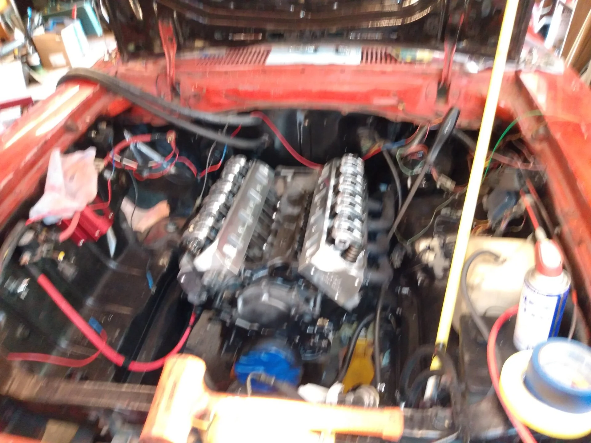

Engine is in place. Still needs plumbed, intake and water pump ect but the block is in place! I could not lift the damn trans myself or it would be bolted in too. Usually I do these as a unit but this time I was lazy and didn't turn the car around. I only have side access with the hoist so I planned on installing the trans and engine separately. Next time it's going in as a unit. Headers and all. That way is so much easier. This t5 is considerably heavier then my old f150 4 speed trans or I am just getting old. Tomorrow I will get the jack involved. After I clean the mess I made tipping the trans on its side.
Disregard the pilot bushing. I think it was installer error. I thought it was seated but after using the proper tool this time and smacking it firmly she is now seated.

Didn't realize how blurry it was until just now but here is today's progress shot.
Sucks getting old...I used to lay under the car and raise the tranny up and into the bell through the clutch into the pilot by hand.
Now I wouldn't even think about it. I'm using a jack for removal and install.

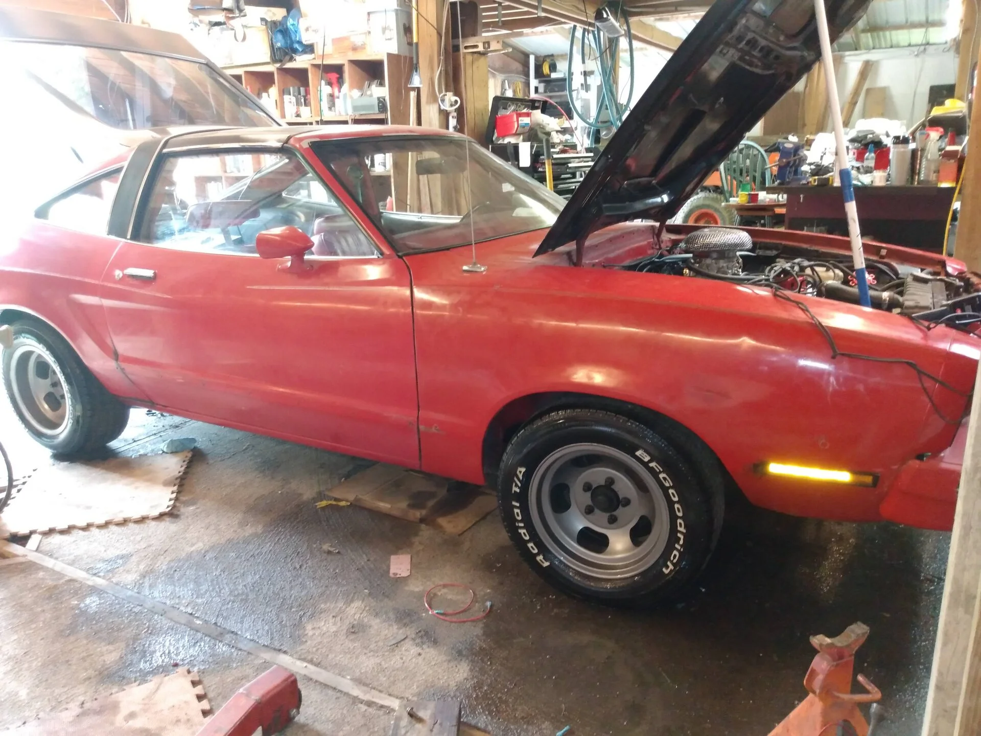

It's mothers day so I only played around for a bit this morning. Trans is still sitting on the floor.

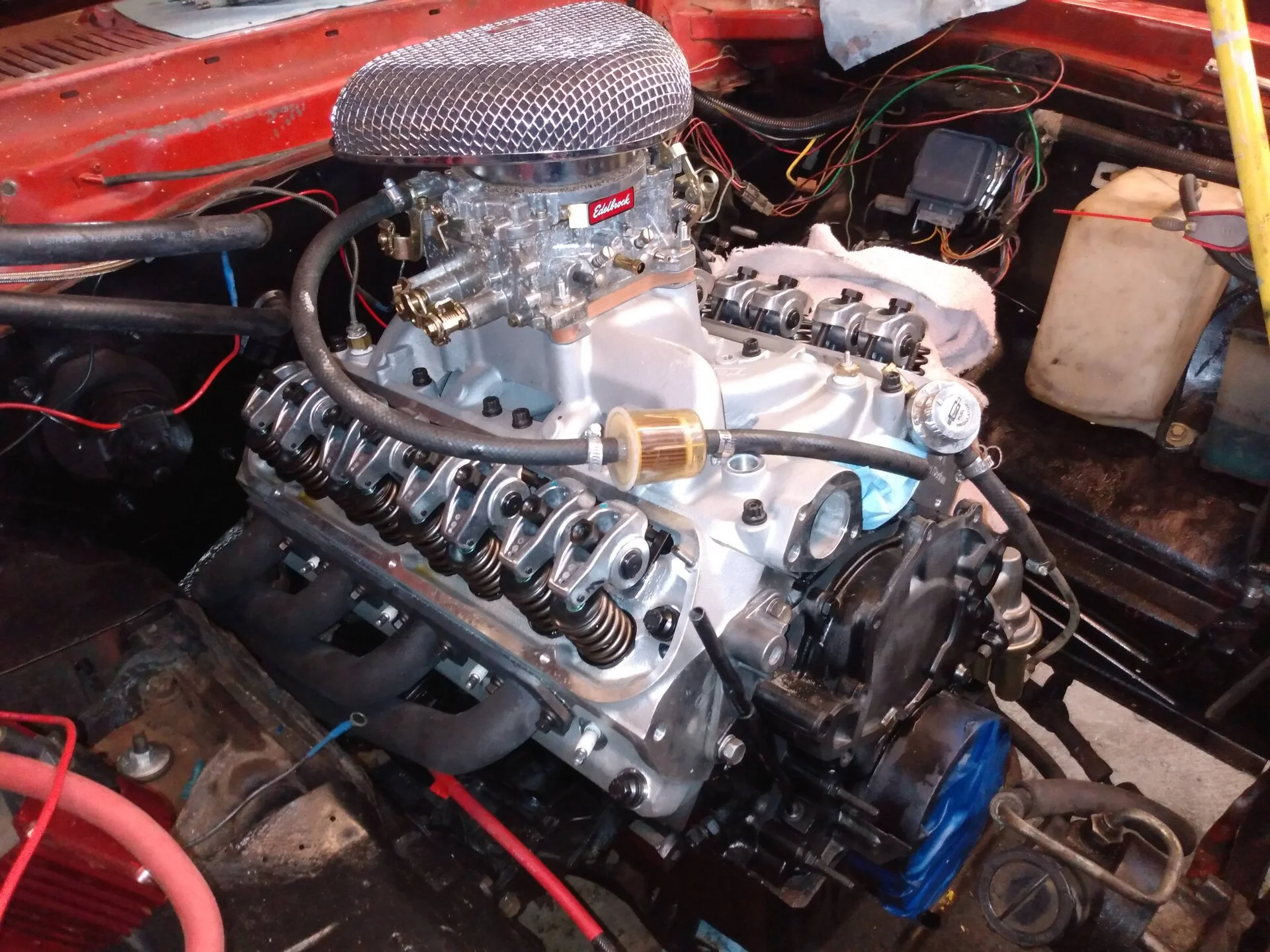

I have to say that fittings just suck. Change one thing and you need all kinds of different fittings. The fittings are as much as the bolts which are as much as the actual go faster parts. Then they are boxed wrong. I could get it running tomorrow but I discovered my 1/8 gauge adapter I ordered and waited a week for is actually a 3/8 in the 1/8 package so oil pressure gauge is inop for now. Can't start a new engine without that. None of the 4 heater hose barbs I have fit this intake. I don't want to reopen the cooling system and make a mess on the new intake so waiting again on parts.
Here is a clearer progress pic.
Transmission is in. One problem I had is the fill plug on the transmission is frozen. It was empty when I got it so I just poured in the right amount via the shifter. Since I spilled a moderate amount I wanted to top up and check level. That plug is so tight I'm afraid it will rip out the threads so I guesstimated and topped up via the tail shaft with a cardboard funnel.
I primed the oil system using an old distributor with the gear removed and hammering an impact socket and copper tab to the shaft. Then electric drill. Engine builder said it wasn't necessary but it was ohh so beautiful watching nice fresh oil pour out the sender hole. I had it hand tight waiting on fittings. The push rods having oil was nice too but making that first mess on a new engine is priceless.

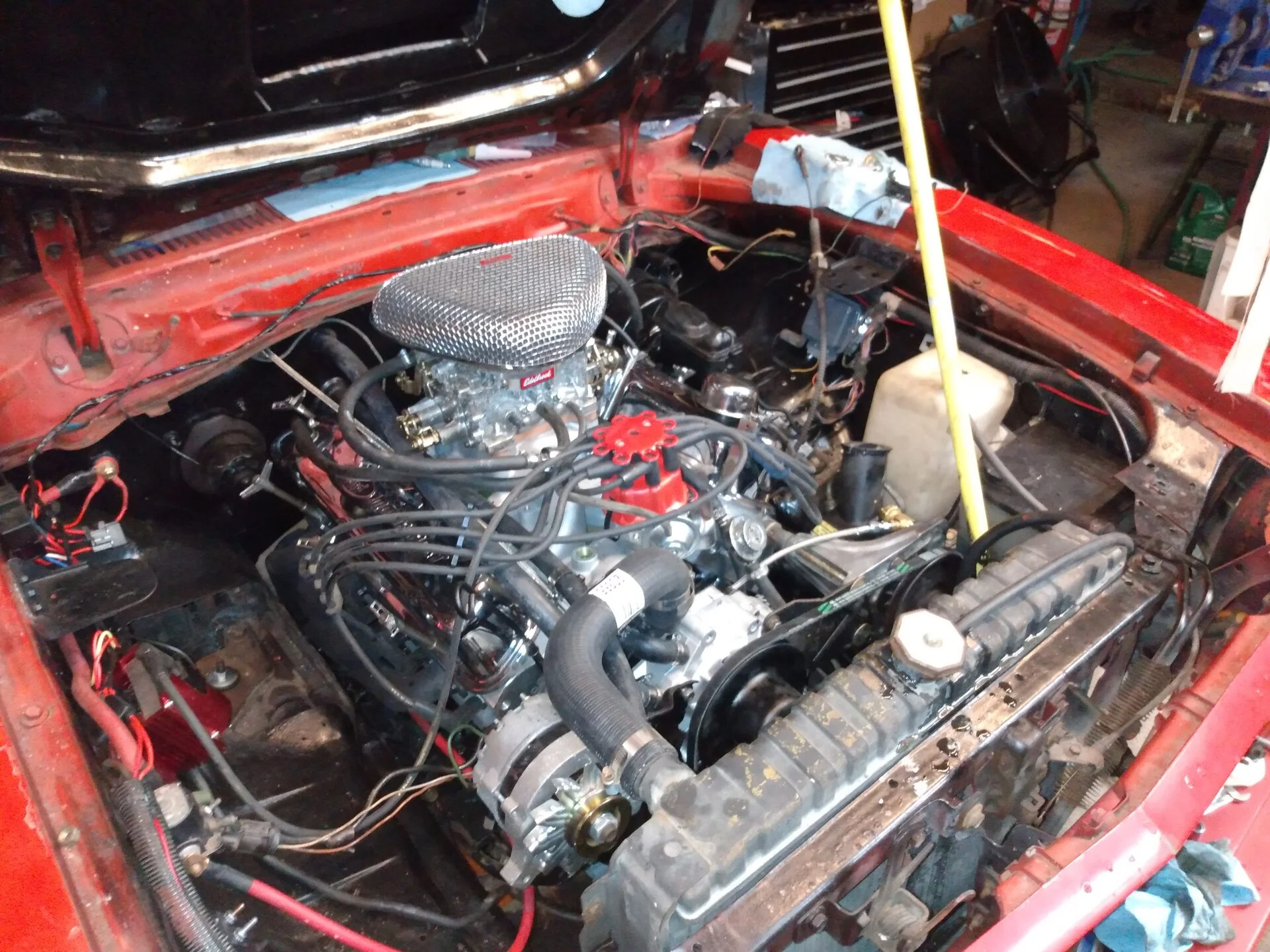

I apparently have changed pulleys over the years. This engine spent some time in the 1990's powering my F150 and I'm guessing it was then. The new water pump and harmonic balancer had my belts out of alignment. Luckily I was able to find the old pulleys. Now my belts don't fit. Explains why I was having a hard time getting the right belts before. lol

Thought I was ready for a short test drive. Alternator doesn't line up yet but everything else was ready. Battery fully charged. Went through the gears. Dropped her off the jack stands. Rolled forward, all was well. Put in reverse to back out. Let off the clutch pedal and it stayed on the damn floor! I pulled the cable loose at the pedal but it's jammed. Hoping it's the cable but fearing it's the pressure plate. I had just dropped it off the jack stands after testing the clutch a couple times. It felt good then poof. Story of life though. All is well....then it isn't. lol

I just placed an order for ceramic boot plug wires and a double grove alternator pulley to correct belt alignment and I may be set. Well until I actually drive it further then the stop sign to see what else is broke. lol

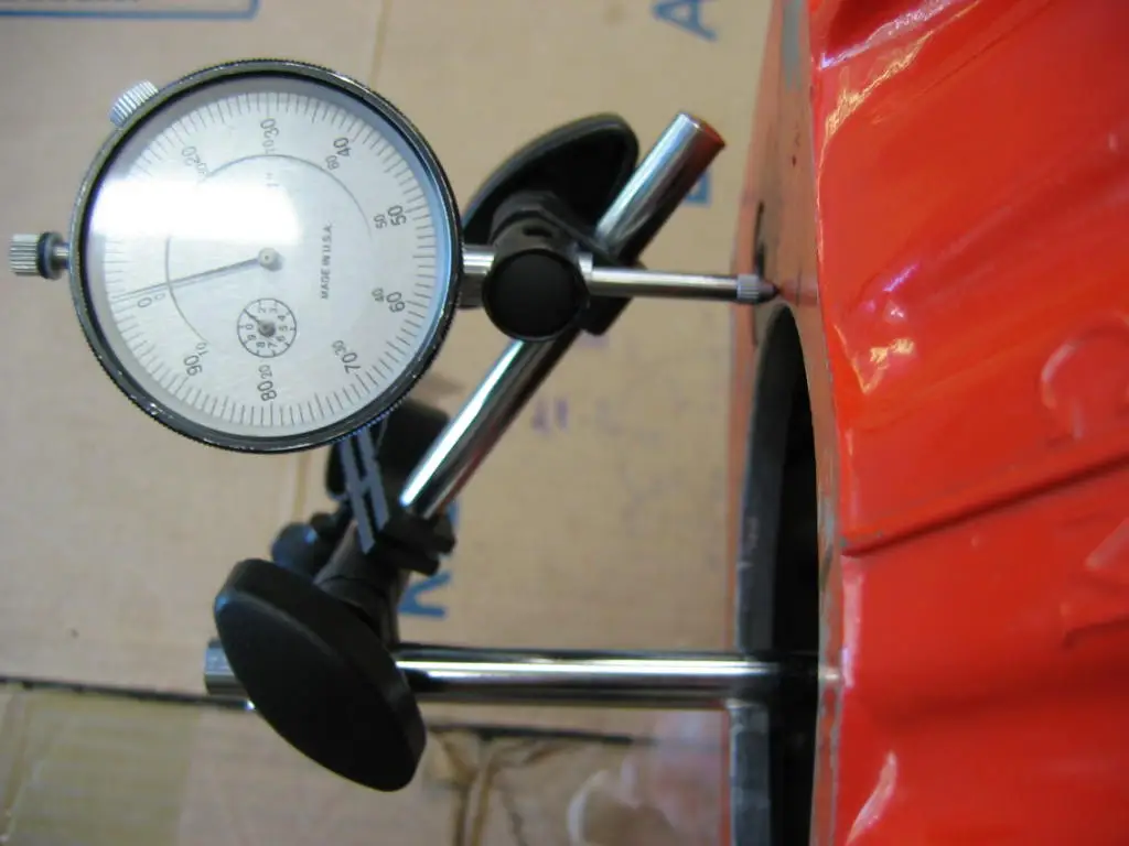

The T5 was $300. It pops out on decel all the time and on accel occasionally. I can hold it in 2nd on accel till it catches but holding the shifter on decel results in grinding. I will pull it again sometime but hopefully it lasts for a while.
I had the same issue. In my case the bellhousing was wraped. A friend milled down the plane where transmission attaches. How did I detect this? I did get a hint that the bellhousing alignment should be checked like this:
https://www.hotrod.com/articles/ctrp-0404-bellhousing-alignment/
You also need to check the parallelism (which was my problem) of the mounting surface, where the tranny bolts to. Like this:
I had a PDF where was everything described with specs, but I can't find it anymore... But all the tremec specs are similar.
