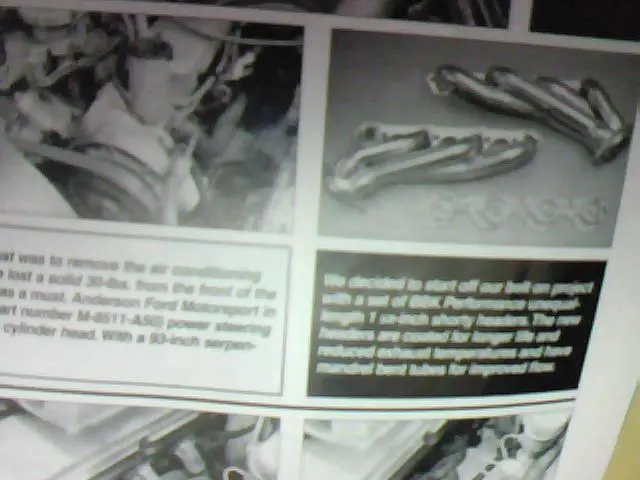

Cool. What do you think about the BBK shorty headers. I've heard stock 5.0 videos with them, and they sound great. There chrome, but it has coating to improve it's life and reduce temperatures. I have an old Muscle Mustangs and Fast Fords magazine January, 2003 edition. There's an article, which is about a stock AOD high mileage LX, that they are experimenting with. The article is called, simply EXHAUSTED. On a stock engine, the bbk headers, with x-pipes that have two high-flow catalytics, it gained around 15 to 20 hp. It only gained 3hp in the first run because the timing chain was very loose.
