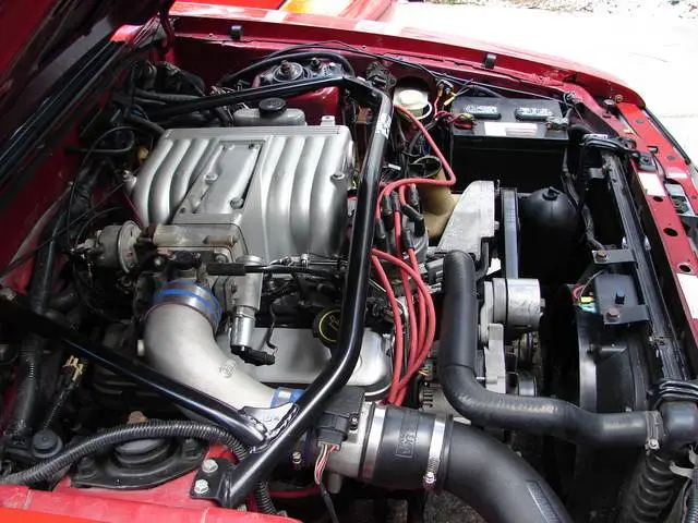

What are the downsides of not having a functioning EGR? I just baught a car that has an explorer intake on it and I noticed that the vaccum line going to the EGR is plugged.
I'm guessing they used an intake without EGR passages in it.

You probably have a late 97 or later Explorer intake. You can feel under the intake behind the throttle body or use an inspection mirror and see if the passage is cast into the intake (see pic). Not having the EGR functional can cause some part throttle driving issues.
Hmm, what kind of issues? I've only had the car for a little bit but I haven't noticed anything.

reports seem to be hit-or-miss, some do notice pinging and some idle issure comming off-throttle and some don't. Count your blessings.
