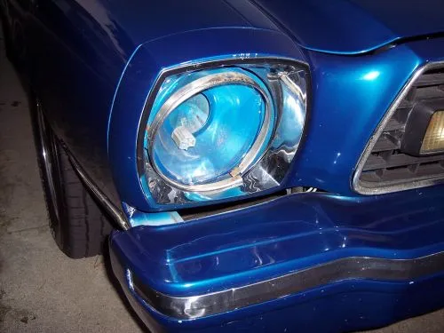

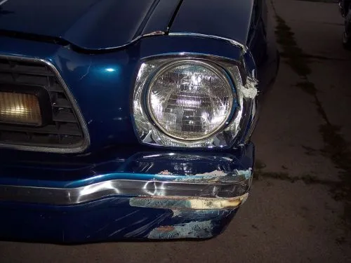

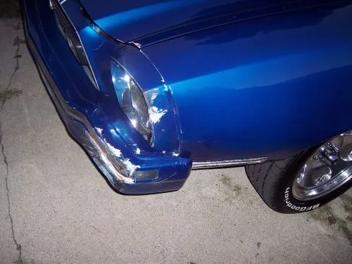

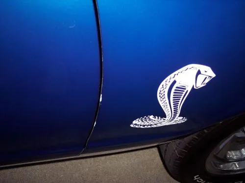

finally the truck. It looks like it tore up the corner pretty good. The bottom of the core support is bent, the fender has 2 good sized buckles, the bumper struts are bent, both doors are chipped, both fenders are chipped, the hood scoop broke a stud and wrinkled the stripes, the hood is pushed back to the firewall. Who knows what else, it pulled like hell to the left driving it home Oh and the left front tire rubs when you turn to the right. I will have to get it into a body shop and get it looked at.

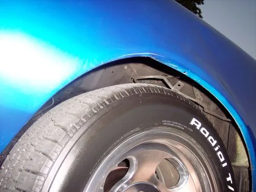

The big thing that scares me about it is the left hand pull and the tire rubbing when I turn. It rubbed a little when I first put the wheels on but it was just hitting one of the tabs the the inner fender mounted to, i cut it off and it was fine, but now it is rubbing somewhere.

Sounds to me like the front is around. Bent bumper shocks means it took a pretty good whack. When they check it out (preferably on a nice bench system), the area to look closely at is near the engine mount brackets. My rails were bent pretty good, but the wreck was a lot worse than yours. Everybody I've evr talked to that actually had a claim with Hagerty had nothing but good to say, so here's hoping the Cobra will back in top form soon!:cheers:
