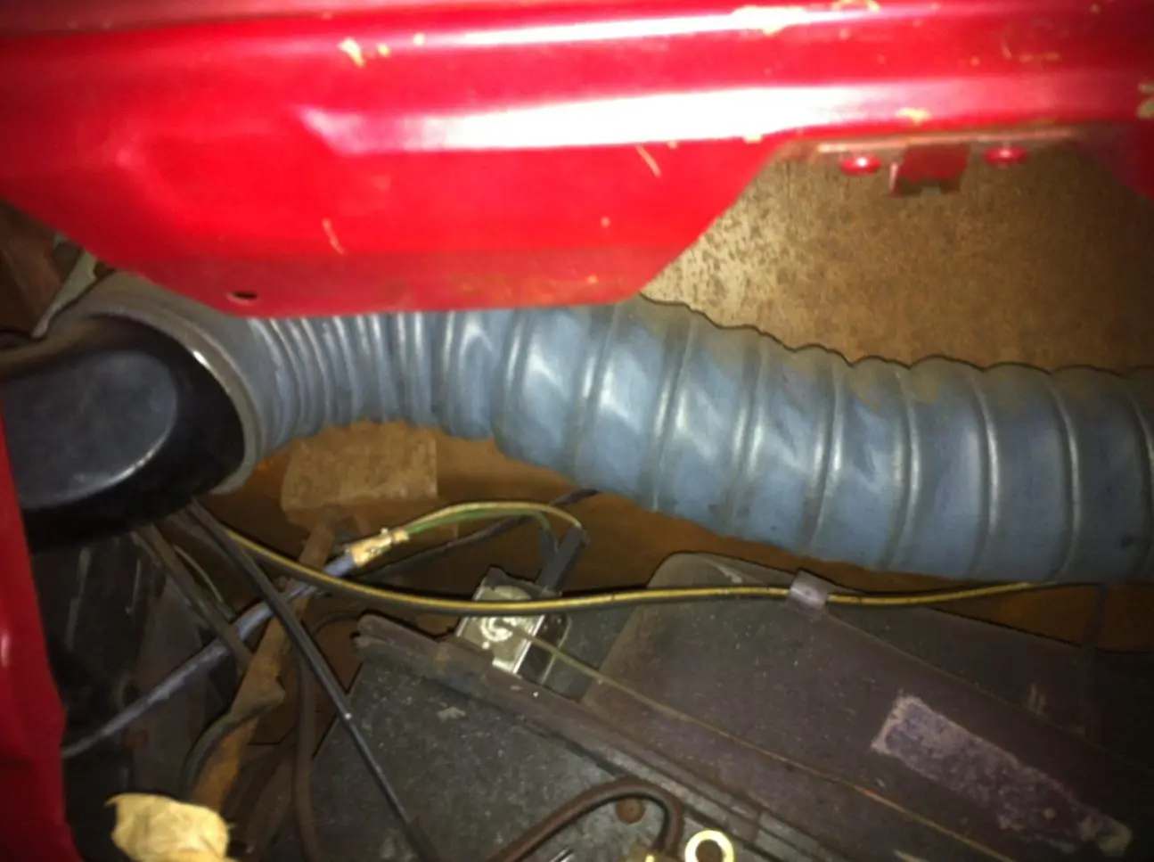

My 67 coupe has factory A/C, the parts under the hood are missing but I have the H/VAC unit in the dash and the passenger and center duct, the drivers side is long gone.
My question - is there a company who sells the ducts for A/C cars or will I just have to buy the black heater ducts that are listed in most of the catalogs and will that work ok once i get the parts under the hood?
The material seems different in the catalogs that what is under my dash - mine seems insulated...
Classic auto air has the parts only when they are available. It depends on the amount that you have missing. They have a full functional 'after market' style that is very nice. Just talk to them and see what they say. I had too many of the original parts and working switches, dash parts, etc so I went with the factory parts. If you buy the whole kit off of them, they will buy the original parts off of you, so it still works well.
Good luck
My 67 had the original ac....i still have all the underhood parts, brackets, compressor, one of the hoses, anyway, my hoses were full of crap and were half rotten. After pricing all it would take to fix the a/c i just went ahead and dropped the same amount of cash and got a new vintage air unit, works great and looks factory, uses the factory controls. Anyway, that's just my 2 cents.
