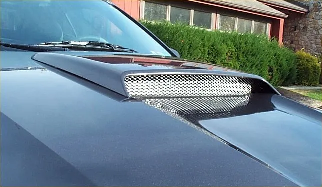

SANZ said:
Any suggestions greatly appreciated.
Hood Scoop Inserts :nice:
Black2K1 said:
I would like to find some way to make the scoop functional. I would be willing to pay a couple hundred dollars for a kit.
KarKraft use to sell that exact kit. There website doesn't show it anymore, but instead, they are pushing their Shaker Scoop (ala Mach 1).
You might want to check with KarKraft to see if they still have any of those kits still lying around.
Kar Kraft Engineering functional ram-air system for 1999/2000 Mustangs
Review of KarKraft Ram Air for 99+
I took the honeycomb off and drilled holes in it then I cut open the hood where the V6 insert is on mine that portion was fiberglass so it was pretty easy cut it with a dremel.
I then made sure to reseal the scoop with liquid weatherstripping so I don't have the problem with water marks on the hood. Now if I could just do something about the rear bumper and rear quarters from the C pillars.

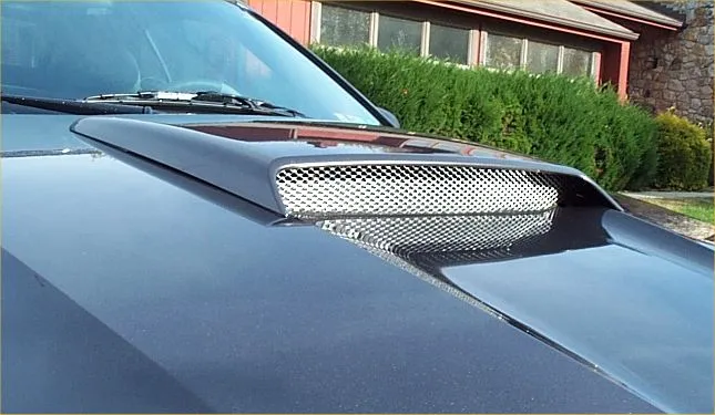

00s281sc368 said:
I've been in the research of a nice hood for over a year before making my choice. Scoop, vs Ram air, vs ...
I loved the s281E hood look but it's not for sale. I went for the 03 cobra hood, it's actually a nice looking hood, cheap enough, and has functional reverse vents and agressive look!
whoa
i really like that pic
the deecals in the vent area looks really cool....
more pics??? side shots?
