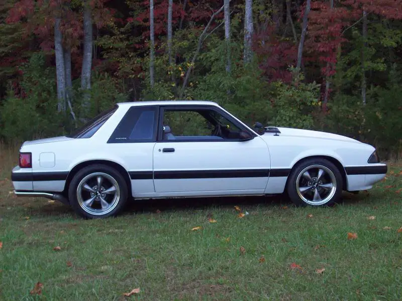

Just took the Mustang out for a Spin...Nice Cool Weather this weekend. Had to Take a few shots of the car before I start into the Winter Project of Single Turbo. Might be a few weeks/months before I get started. But.......We shall see...
Plans:
Got a Single Pony Down Turbo Set up
Precission 76mm turbo
UPR Tubular K Member
ARP Head Studs
Cometic Gaskets
Complete Fuel System upgrade
Coil Overs front and Rear...
What Am I Thinking??????? Wish Me Luck!

Those rear wheels are bad ass. What are the specs on the rims and tires. As far as what are you thinking, your thinking in the right direction. That coupe is going to be nasty. Good luck with it.

I've run both 17x9's and 18x9's with mine, it's got coil overs. I run the 99+ brakes with good clearance between the wheel and coil over.
Which brand coil over do you run? I asked the dude at MMR about his and he said he has never heard of an issue with their coil overs and foxes with 9" wheels up front. Ackbar said on turbomustangs that his UPR coil over kit he just bought has about 1/4" clearance up front with his 9" wheels.

Coilovers...I done a little reasearch on this and my coilovers are the old company X2C Motorsports....same as MMR? not sure but thats what I was told...also told only a few companies making Coilovers had problems with the 9" wheel up front? we shall see. I am sure I can work something out. Running 95 Spindles up front maybe a spacer will help?

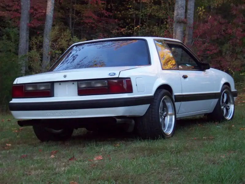

the rear tires: 17x10.5 315/35/17 tire
T76 turbo...the car is a stroker? Not sure if its a 306/331/347 Car Made 355 rwhp no tune, never put a timing light on it. 359 tq like it is. Yea its a stock block so I know I will be limited and not sure how long it will last? I have be really thinking about a block upgrade as well. Motor has 1" steel Gridle, Eagle H-beam rods, Eagle Crank, Victor JR. heads.
