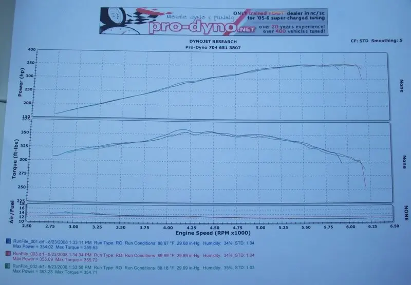

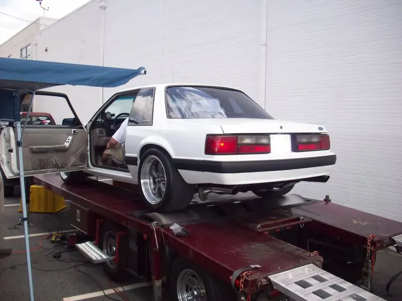

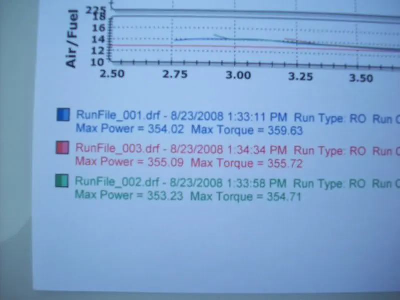

Cool that it's a stroker, best of luck. I feel sorry for your block if you are making 350+ N/A
:lol:...............:rlaugh:................:D........................:(

go boss block. it would be bad ass. :D
if your going to go with an aftermarket block, i would advise against the boss block, the largest stroke they will fit is a 331 crank. which means that the most cubes you will see is 347(big bore 331). where you can get 360+ from a dart or an R-block.
and if the tune is good and you dont get greedy with the boost controller you should get at least a summer out of it... :D nice car, its gonna rip with that turbo kit
turbo ftw...boost is addicting though :D...i found out the hard way... :( atleast it was just head gaskets!
you will be able to make some great amount of power. but like everyone has said. stock block will hold you back. its gonna split!
Want be the first block.....split...
You know A funny thing one of my friends told me was that if I split the block it probally would hurt anything.......just could not understand his thinking?
I am not looking for 600-800 hp just get in the 500 range and I don't race just cruise to local car shows.....I might spin the tires some just for fun but I am just too old to go all out again....
maybe it will last......but you guys can just say..........I told you so.......

de tune for 460-480ish with a hell a tune and A/F dead on and i think you will make it last. needs to be tuned really well.
Ive been reading up on turbos. i need more knowledge!!!!! :shrug:
Motor has 1" steel Gridle, Eagle H-beam rods, Eagle Crank, Victor JR. heads.
Those are some pretty nice parts to risk when the stock block lets go......
Hmm guess I should pay more attention, you are right. I would still think its safe around 500 rwhp should make some monster torque also. Just have it tuned pretty good and don't be john force at every stop sign.

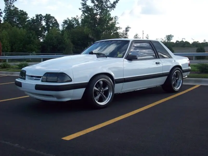

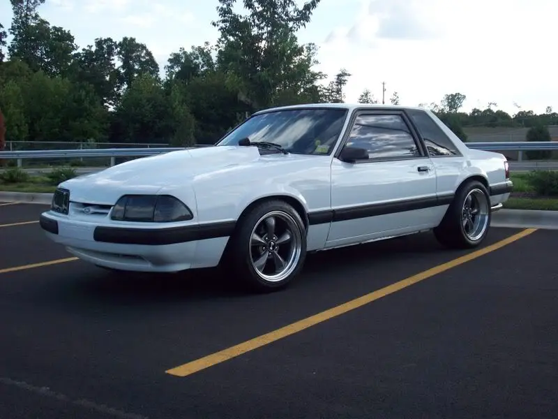

Nice lookin' ride. Good luck on that build.
I love the huge tires out back...I think my car sits too low for something like that, but sure looks mean.
