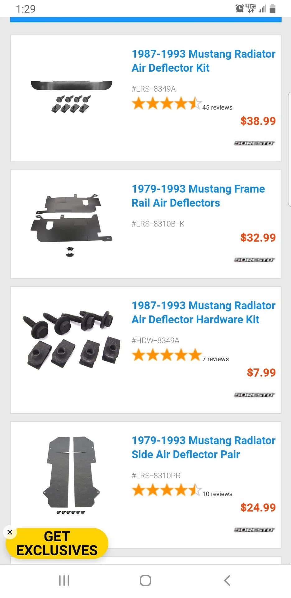

Ford Contour fans are best bang for the buck. Check and make sure your air deflector is at the lower core support. If that thing isn't there the car temps will creep up while driving....the deflectors that are between the bumper support and sides of radiator are important too. Without them the air will bypass around the radiator and not through it at highway speeds.

Im pretty sure none of that is on the car anymore. Would LMR have some?
Yes..
