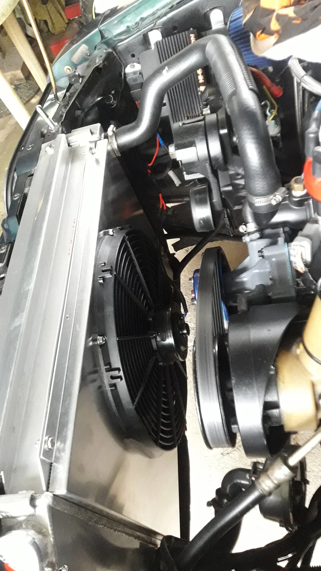

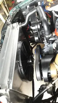

the last I did ..taking out the Contour fans and sold them ... by the way ...excellent cooling ..no question ..but for a NA Car just overkill ...I bought this set .. and its all my 331 cu needs ... cools down perfect .....and its not expensive 99$$ and easy to install ....
https://rover.ebay.com/rover/1/711-...0001&campid=5335821607&icep_item=272978814361..

I live at the pacific Coast in Costa Rica by the way ...maybe 25 deg Celsius or 77 F is the lowest we have here.. normal is 30 to 35 and more ...:coff::coff: that cooling stuff is like sience...since I changed the Engine to more powerfull but using the same Pump and Radiator etc..engine runs cooler then befor, using a Hyundei 82 deg Thermostat... ..i dont know why....:chin:chin:chin

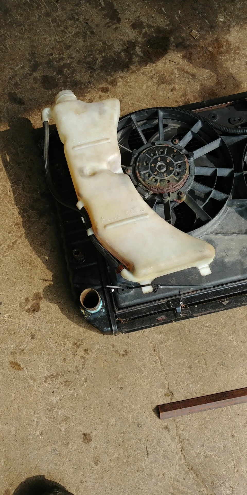

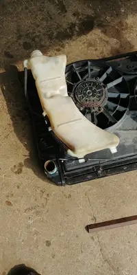

I have the dual Contour fans running off relays (the way Ford did it - actually took the whole Contour wire harness off an old DD of mine) and use a dual speed fan switch from a VW, low on at 192 and high at 210 (I think those are the numbers).
My rad is a 3 core OEM style (copper or brass or whatever they are made of). I have a 180* thermostat. Was out last week for a 20 minute cruise. Outside temp as about 85-90* and fans never turned on once. I manually turned on both low and high speed when I got home just to check they were working.
Overflow bottle is not an issue unless you go with a big 3 or 4 core aluminum rad. I mounted my stock bottle to the rad/fan shroud (with zipties for a year and half before I built a bracket).
Given the capabilities of the Contour fans I personally would have no issue or worry running them with a stock 2 core rad. Clearance to the engine pulleys would be amazing.
