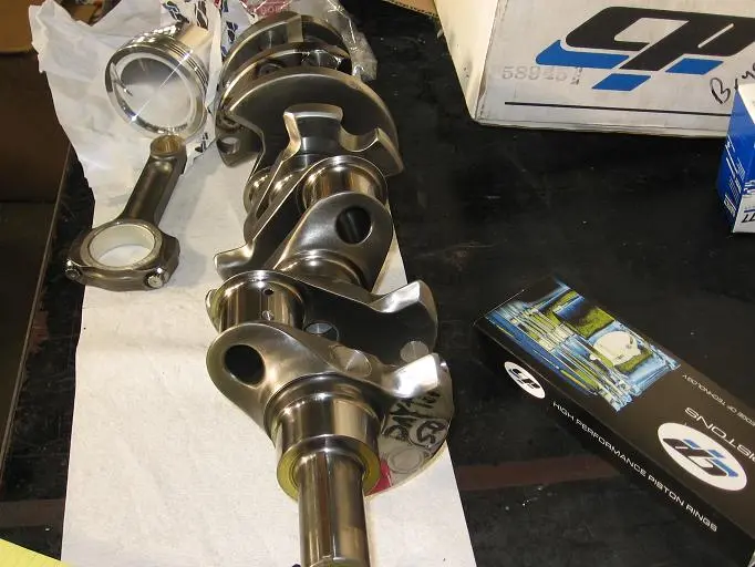

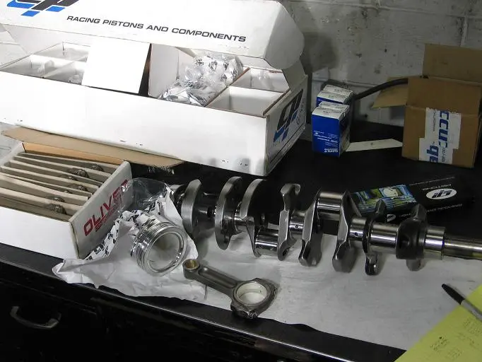

Add a sonny bryant billet crank, Oliver billet rods, and custom low comp CP pistons to a Dart block:
standalone
standalone

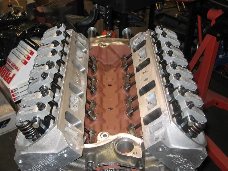

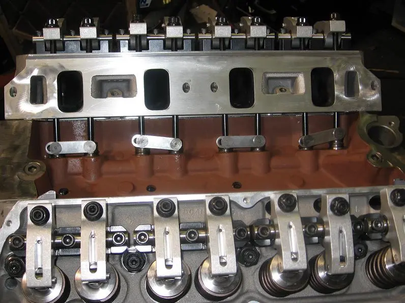

Slap on some big heads with shaft rockers and a custom cam:

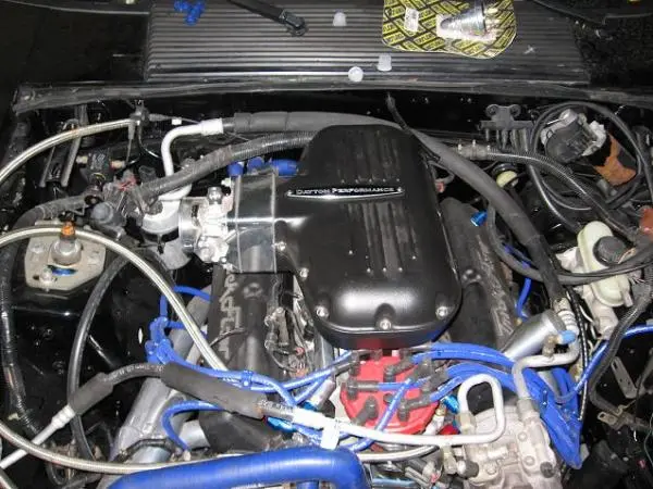

Throw on a TFS-R with box upper for good measure and the engine is in!

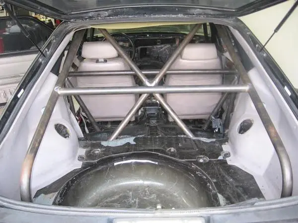

The new custom chrome-moly roll cage with removable door bars:
standalone
standalone

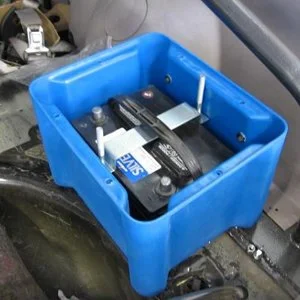

The battery box:
standalone

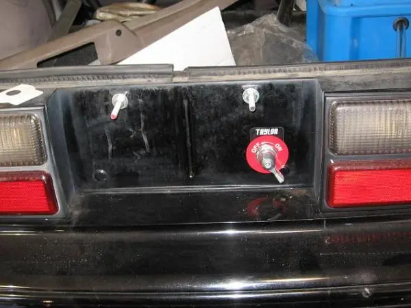

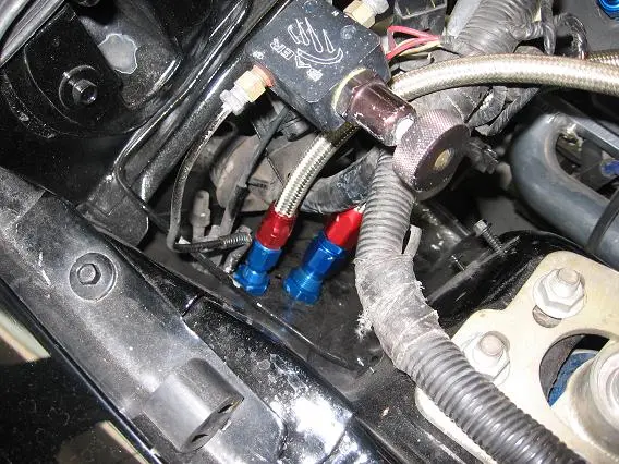

Battery shut-off switch:
standalone
standalone

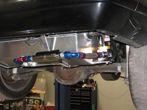

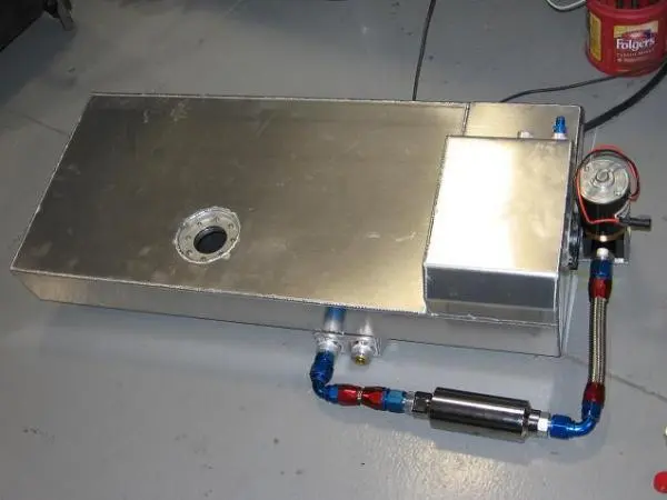

The behind bars race cars (a beautiful unit) sumped tank, 10 micron aeromotive filter, and Weldon pump:
standalone
standalone

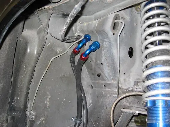

A bulk-head connector was mounted in the passenger fender well and the fuel lines go from the rubber hose along the body to braided steel in the engine bay, and you can see the new coil-overs in the first pic:
standalone
standalone
