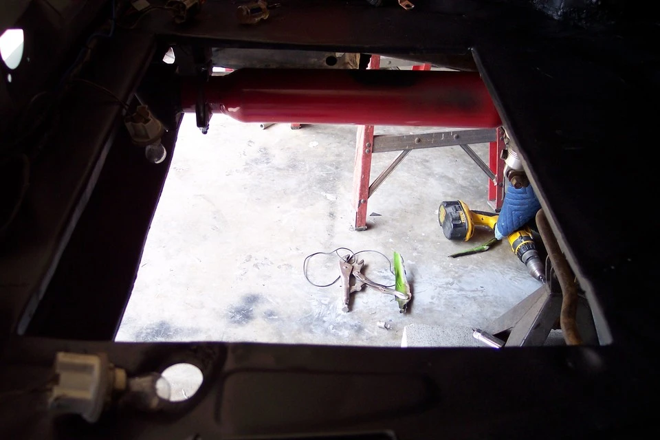

Earlier in the week, I posted a different thread trying to decide whether to buy an aluminum cell, or cheap out and buy a plastic one. The concensus at the end of the thread was That I was gonna build one out of steel instead.
I cannot Tig aluminum, my machine won't handle it, and I don't have the experience to make it look decent.
I can mig my ass off though, so I decided to call my steel supply guy and have him cut and bend the necessary pieces out of standard cold rolled mild steel.
I wanted 15 gals. I did some math and figured that it would take a rectangle 10"H x 23L x 17 W to get that volume. So that is what I had him cut.
Unfortunately he was swamped and I didn't get the stuff until yesterday, but I prepped the trunk so I would have that behind me.
(stupid camera. Always has a problem w/ backlight)

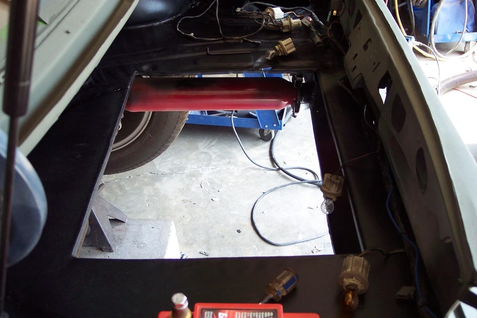

What we're seeing here is where I cut out the spare wheel well, and patched in a piece of 18 ga sheetmetal. I hand rolled a 3/8 lip to add structural integrity to the cut out, as I intend to mount the future tank just like they did in the older fords, through the bottom of the trunk floor.
Thursday afternoon I get the call from steel dude, so I go get my junk.

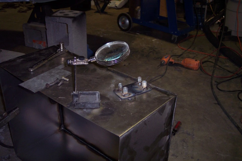

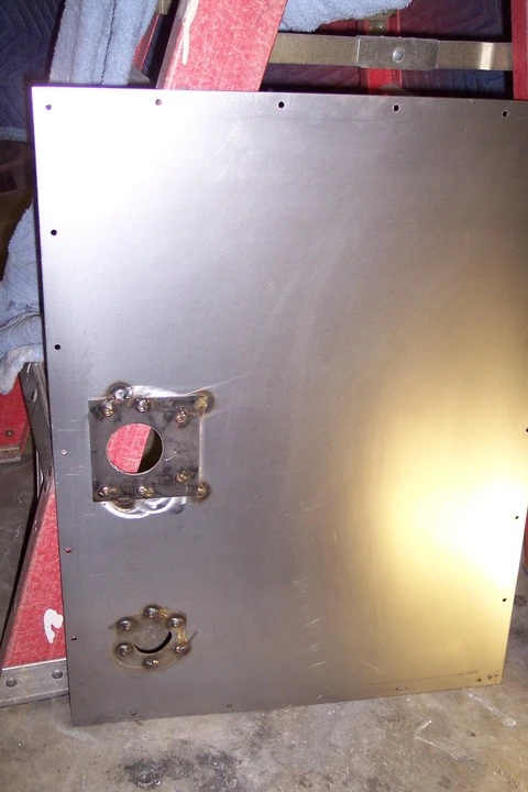

A top, bottom, and a folded side Total invested so far........$35.00
So I set out building the thing. It's still 18 ga., so I gotta weld it in sections at a time to keep it from warping.
If you'll look closely, you'll see where I started and stopped every weld. I only went about 4" at a time, and then would rotate the box to the next side.
What tha?
When you are concerned that they weld integrity has to be as good as it can get, and you have a damaged eye, sometimes you need a little extra uhhh "magnification".
Whats that doo dad next to the ant burner? It's the bulkhead that I welded to the inside of the tank that will allow me to bolt my fuel pump to the tank wall. Why did I have to make it an "inny" and not just weld some bolts to the out side of the tank wall?

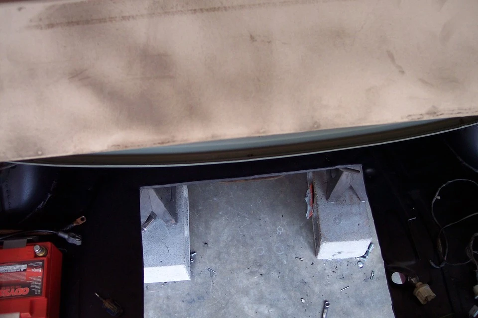

Well, when you have to drop the tank through the floor, the opening is only big enough to allow the tank through it. Any bolts hanging off the wall would not let it slide by.
There now. Glad we got that out of the way.
Another shot of the weld quality. I'm pissed that I had to stop and start, otherwise it woulda looked like it was tigged.

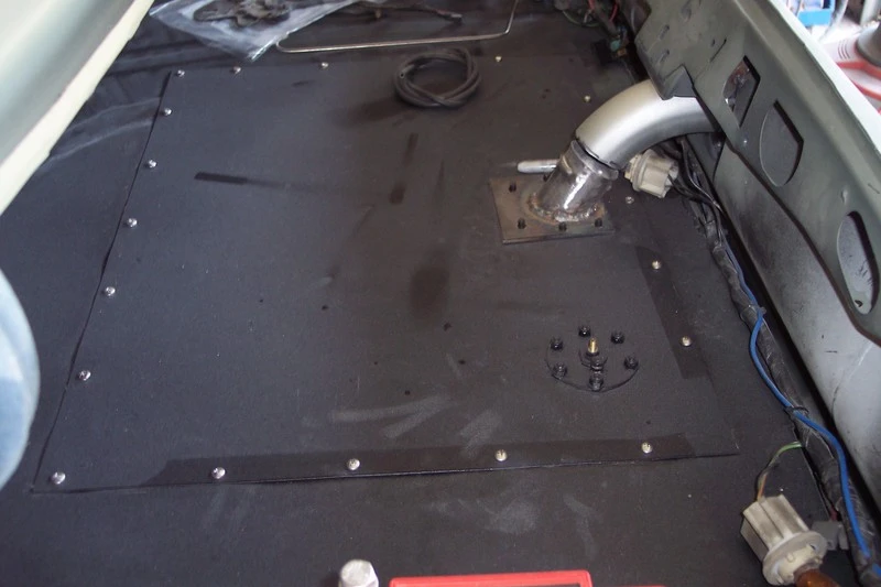

The top w/ the sending unit and filler holes reinforced.
The "box", Complete and ready for red kote.

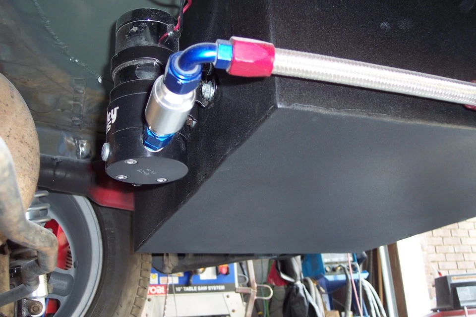

The total I have in the tank is 60.00. I reused the sender out of the factory tank, and I had to custom make the filler neck anyway, so I think I'm in it pretty decent. I'll paint it and hang it tomorrow, and the fuel system will be done.

I've been working on installing the tank and fuel system. I started on the other side, It's about 80% done. I removed the door in anticipation of sanding the full jamb and prepping the door itself for paint. Now that it's off, I can repair the worn out hinge assy.

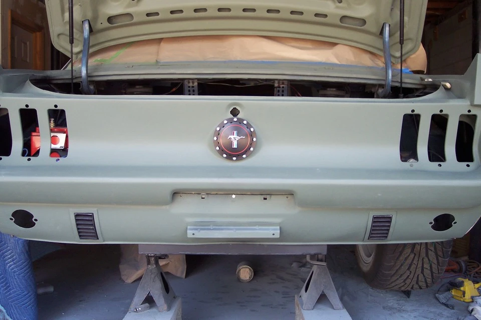

Black anodized billet cap w/ red detail and stainless button heads.
All that I need is a piece of rubber hose to couple the upper filler and lower filler necks together.

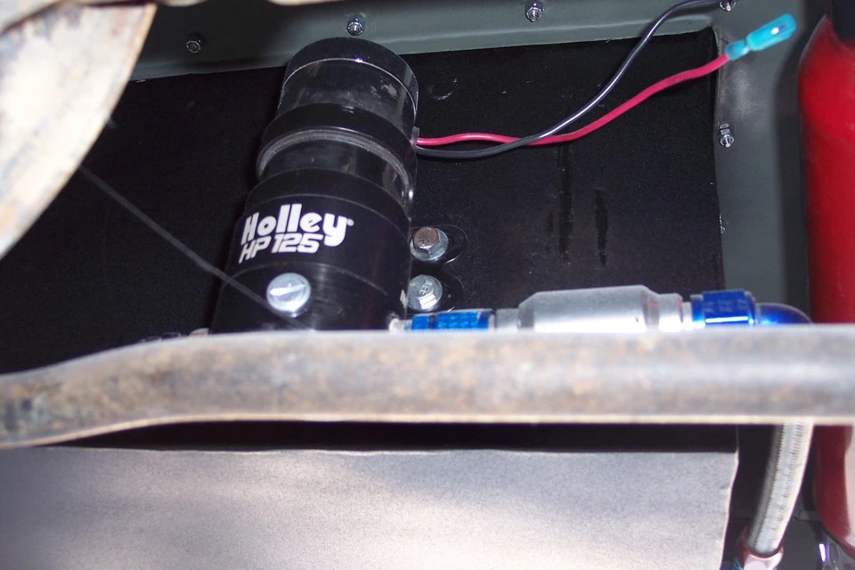

Pump bolted to tank wall.

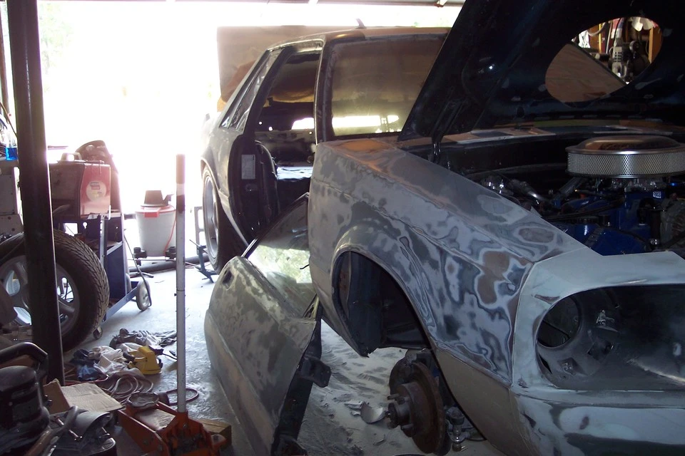

My personal hell.
I also have been consumed w/ the fact that the nose was actually "tweaked" up higher on one side than the other. And whether or not anybody would've noticed it, I have been dicking with it trying to even it up, so I added a bunch of body work back to what was basically a "finished" area.
