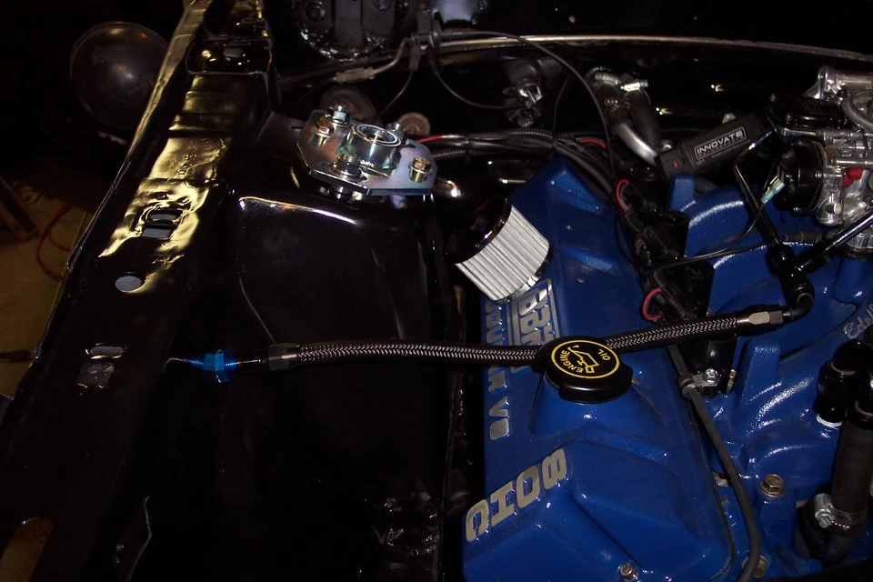

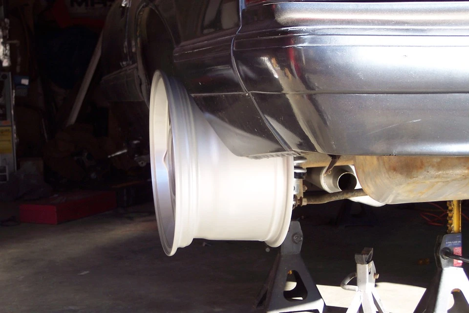

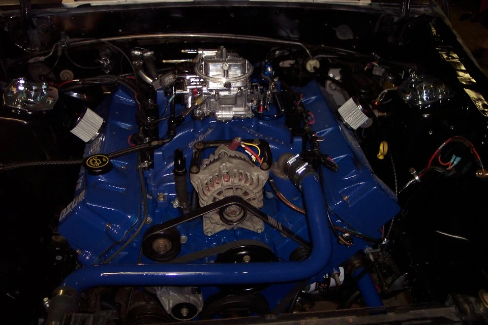

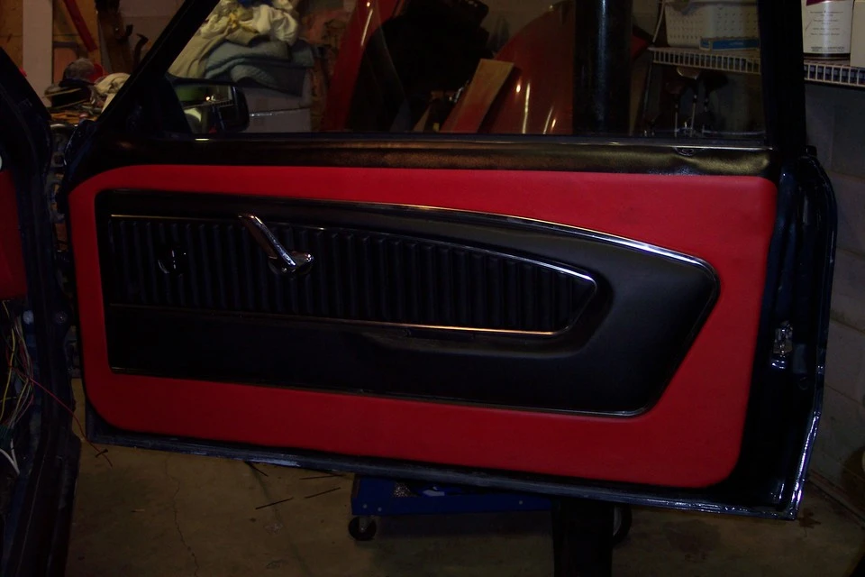

Plans are to use the 2v motor and Tremec 3650 I had out of a wrecked 02, keep it as old school simple as it would've/could've been i.e manual brakes/ manual rack/carburetor.... re do the interior in the mach1 upholstery that can be bought now, redo the aero front (slightly) and change out the tail lights;bumper;rear valance w/ new 1968 units. Put Mavromont 17 x 6.5 pony R's on front and 17 x 10's on the rear (after modifying the rear tubs to accomodate the special 7.2" backspacing) Use Nitto 215/50/17's on front and 285/50/17's on back then paint the thing white w/ a blacked out hood and Tail light panel and adding the commensurate 69 mach1 reflective stripe kit to the sides and rear.

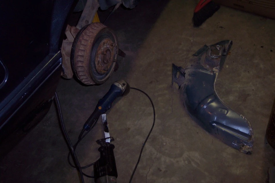

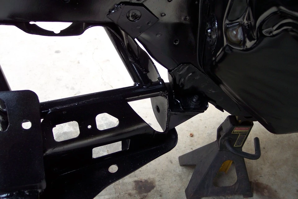

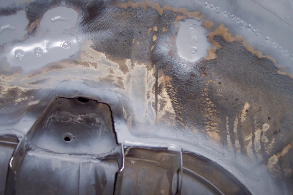

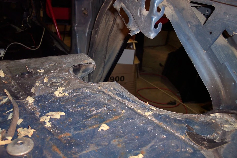

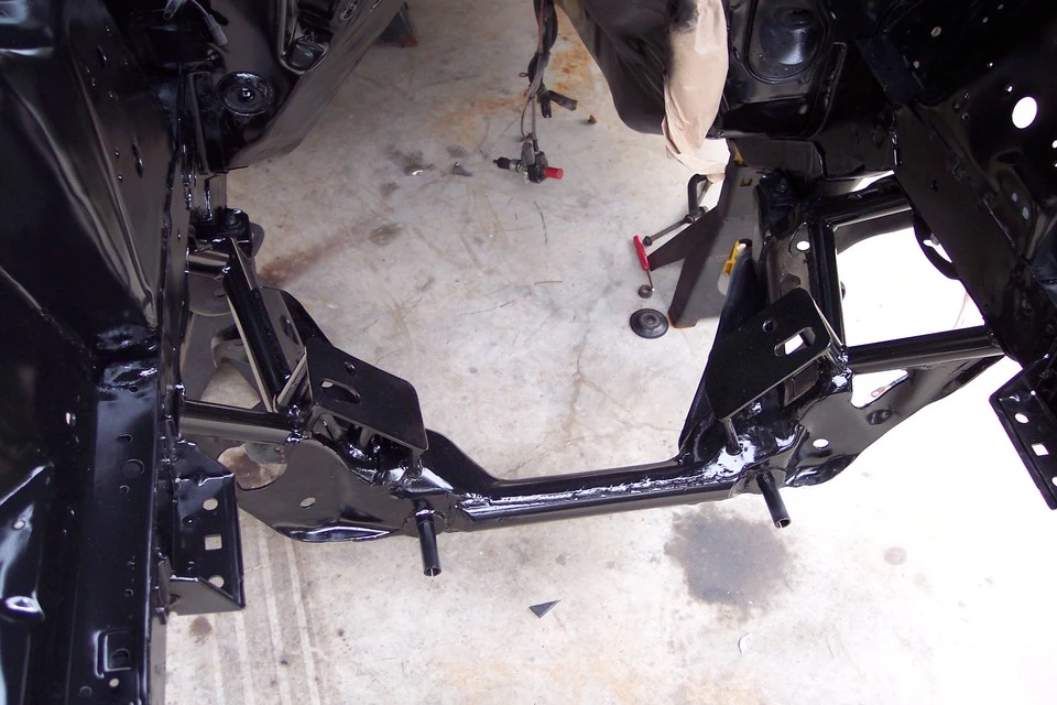

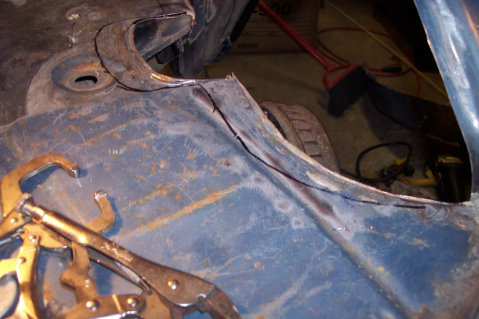

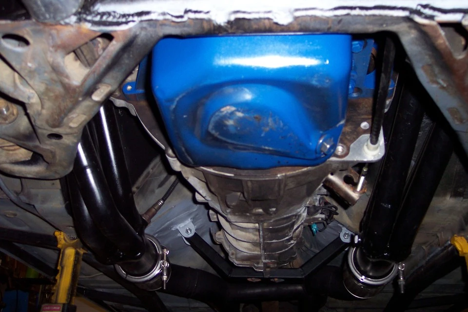

Ive modified the stock K member and fabbed a new trans mount. The engine is in the car and mounted. The interior is completely done, but unfortunately is mostly out of the car so I could fit the trans, wire up the necessary stuff in the dash, and cut my rear wheel tubs in half to add in the 1"1/4 extra width to accomodate the fat-assed tires. Once I get it running, I'll put the full interior back in and post those pics next.

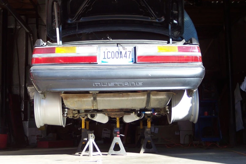

275's on 10 inch wheels? You might want to double check that. Kinda narrow for 10's. Sure you don't mean 295's?
They're 10's but they look freakin HUGE! Guess it's the backspacing that puts them so far underneath the quarters that makes them look so big.
I get the tires tomorrow, (275 50 17) they'll be 11.5" wide and a tick under 28" tall. he fronts will be 225 50 17's (26" tall)
Those do look huge. I'm with SSeater on the tires. My Cobra has 295's on 10" wide rims and I wouldn't go any smaller then 285's.

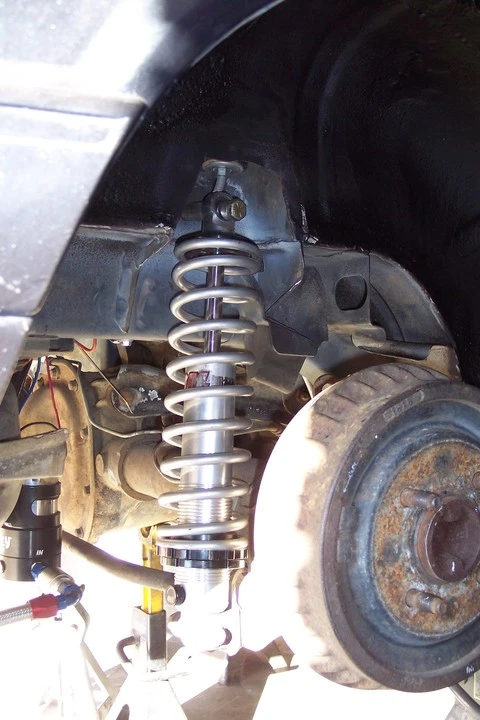

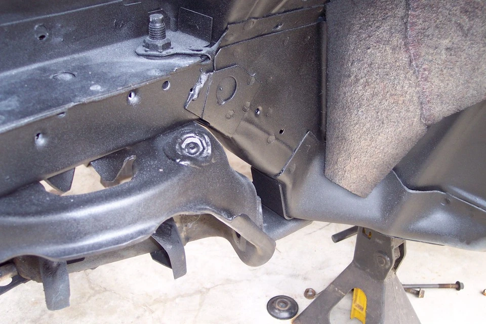

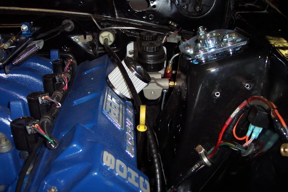

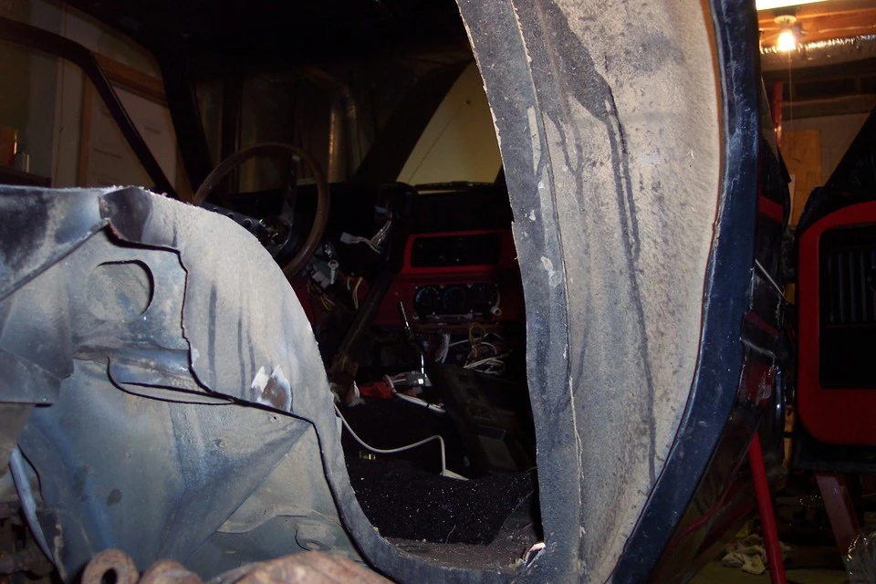

Great work, very clean, I have a question on this picture:
Is this some kind of matting? I cant really tell what part of the car this is, looks like a spring perch but some matting like that would look clean along the firewall, like it comes factory on some new cars.
