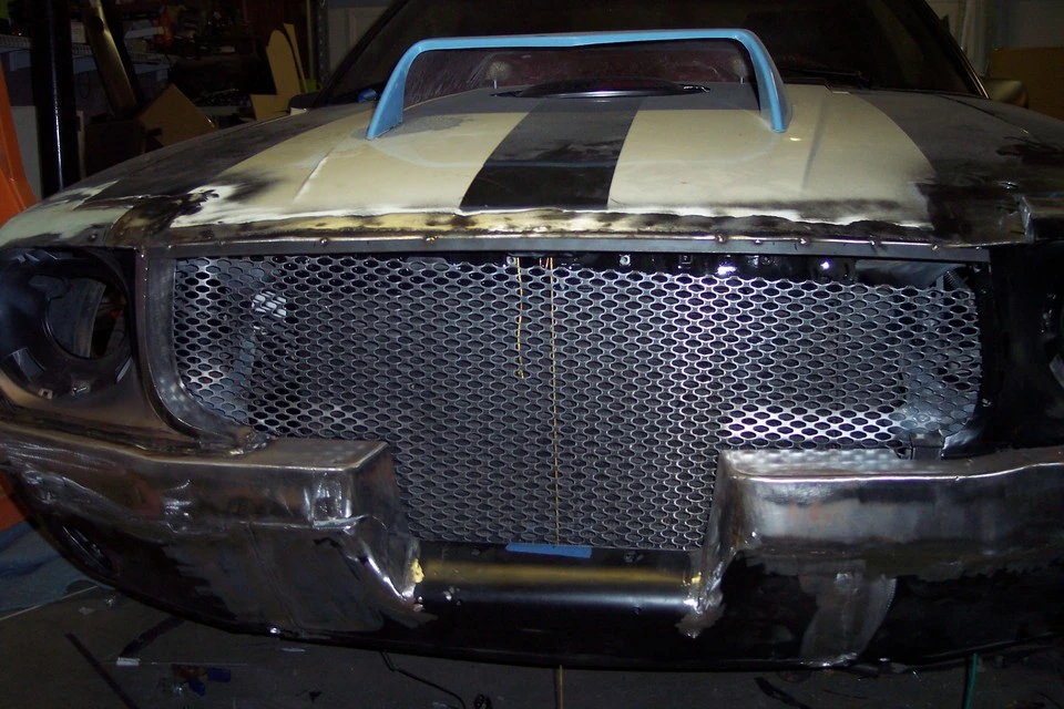

well working w/ one eye sucks. I did manage to rough in the hood, and start on the one side of the grille . I also found the aluminum grille material that I'll use. So I guess I'll update:
The grille is obviously just sitting in there, and I'll end up painting it black. But it's better than the usual ricer "x" mesh.

Is that the final grill? Like I know its just sitting there but I was curious..
I like the horizontal style grill myself.
