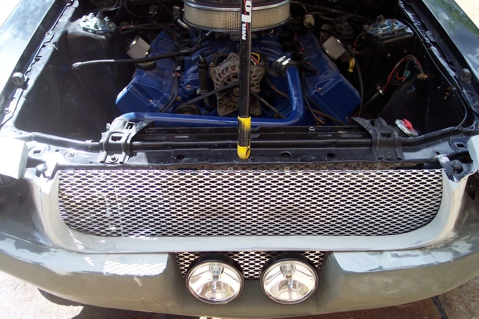

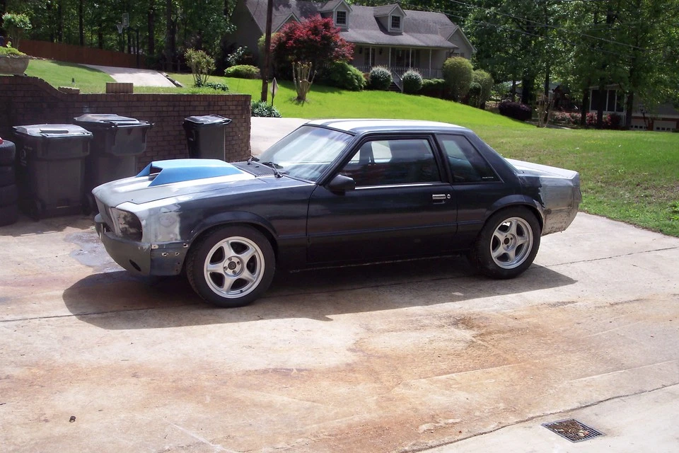

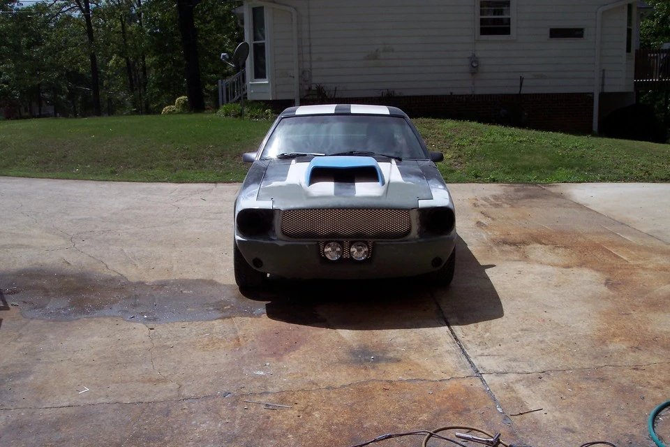

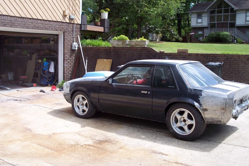

I figured I'd add the front end progress to the thread, (just to be redundant),since I've already posted separate front-end pics earlier today.

After 150.00 in materials, (and about 12 hours) the horizontal grille is out. I don't have the grille depth that a regular 68 has, so the grille was pushed all the way even w/ the front edge of the grille surround. It looked like a flat, slotted block of aluminum.
You can look at the grille pic, and see I don't even have room for the latch w/ the piece of grille material that's there. The grille surround tapers, and setting it back from the bottom front edge makes it end up behind the surround at the top. I didn't want to step the horizontal grille either, so now I have a whole bunch of 1/4" aluminum bars sitting in the corner.

Thank you sir. And to everybody for that matter. Now that I'm having to do all of the bodywork to finish, I'm not sure how I feel about this build now.
The horizontal grille hid the depth of the surround. The surround will be painted white(like the rest of the car when I paint it) and the grille mesh will be blacked out w/ the exception of the running horse grille emblem mounted "69 mach 1 style" on the drivers side of that mesh. That contrast will give the front end the depth that the aluminum bars hid.
(I think the damn thing kind of resembles a new challenger as flat and stubby as it is already)
So contrast, in this case is a good thing.
I want the opening to be simple, like the Bullitt car where Mcqueen actually had them remove the running horse and corral from the grille on that car. There really wont be anything shiny on the car, so a billet grille will kinda conflict w/ that. Besides, regardless there was no way the bars would fit w/ the driving lights in the lower opening, and that was pretty much the death nail for that idea.

Chrome_Rust said:
Simply awesome!
But too make only a small observance... Is there a smaller scoop to put on the car, that one seems a little dispropotionate to the rest of the car.
But still, simply awesome
Thank you again.
Well of course there is another scoop to put on the car........,
Hmmmmmmm.... I did pay 100.00 for that thing, AND I do need a 14" diameter 4" high space so the air cleaner will fit when the spacer is on,..AND I do kind of like the thing,...
I know! I'll take it off, seal up the front end, flip it over and I'll finally have a place to give that filthy dog we own a bath. Yeah,...thats the ticket!
Like the grille, the hood scoop is a like it or hate it part of the car. I'll agree it's a little "obnoxious". The fact that there is a completely different front end on the car is obnoxious. But it fits my smart ass to a tee. I said on the other thread that I think that once it's painted the same flat black color as the hood, it'll disappear.
