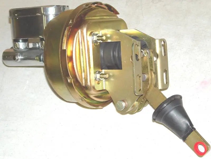

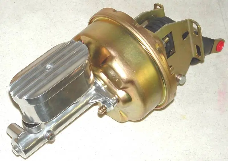

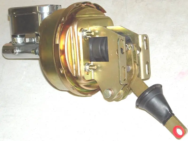

I just completed the install and plumbing of a Scott Drake bell-crank booster/MC setup, together with a JMC MC for a McLeod hydraulic throwout bearing, on my kids' '65 with 289. The engine has no exhaust on it at the moment. It has some generic FRPP chrome sheetmetal valve covers, which I would guess are probably incompatible with roller rockers. The export brace is off too. If there's anything in this combo that you'd be interested in a dimension, I would be happy to measure it for you. I could also take pictures, again, if you're interested.
Here's some pix of the MC/booster:
The reason I mention it is because this is probably a unique combo that I'm installing on this car. Even though you might think a booster would be a bad idea when you're trying to make room for a turbo exhaust header, it may be that the upward offset that the Scott Drake bell-crank gives you creates a void right where you need it, right where an unassisted MC would be sitting. There's no doubt that a hydraulic clutch clears out a lot of room in this area.
