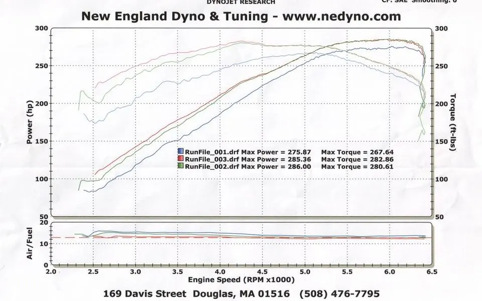

My car has been running like crap for years and as a result, I never drive it. Well I finally decided to get it tuned by Eric Laferriere in Johnston, RI and here are the results...
blue line is initial, green is first tune, and I beleive red is with 2 more degrees timing.
Also had 3.73's installed while he had the car...What a difference everything made!

any advice on what to change to get her over 300rwhp? I'm going to ditch the flowmasters and pro chamber for some magnaflows and an OR H or X, so that should pick up a few hp.
he tried advancing the timing 2 more degrees and it didn't help, so that is out.

HP looks right on for the combo but the TQ values seem a little low...might be the lower compression. However looks like she'd be fun on the street, congrats and keep us updated with the additions!!!!
just curious do you know exactly why the car didnt run good without the tune? i dont see a reason that it should have acted up it was all pretty basic stuff, you havent added the boost yet so to me it seems like it should have ran decent on the stock untuned ECU, assuming your MAF matched your injectors
DMAN, thanks for the feedback! I think foir the compression ratio, it did pretty well.
Foxfan, the MAF is matched. Problem was that the car had no O2's and I didn't realize until recently that the computer can't really do anything without them. When I had the initial work done, I didn't really know much of anything about Mustangs and didn't think much of it. The car ran like crap, and as a result, I drove it less than 3000 miles in 4 years.
That baseline was done with the O2's installed and the motor had run for an hour or so over about 30 miles.
now it runs like a stocker again...I can cruise at as low as 1000-1200 rpm and its butter smooth. I'm really happy about the 50+ lb ft bump down low
did the car run better? at start up then started acting up once it got warmed up??
the ECU doesnt pay attention to the o2s until it enters closed loop mode, which means all it does is look at o2s to maintain 14.7:1 AFR and before it gets to closed loop all other parameters must be in range.
i am not sure but if you didnt have o2s connected to the harness at all it may have gone into limp mode upon start up all the time and ran like crap.that seems like what may gave happened, hardcore EEC tuner dude would have to chime in on this
