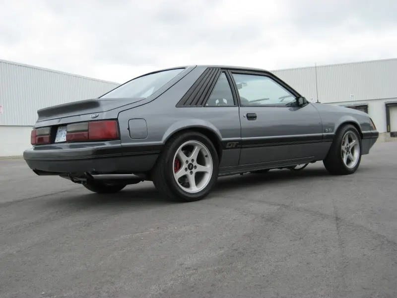

Finally finished my car....pictures

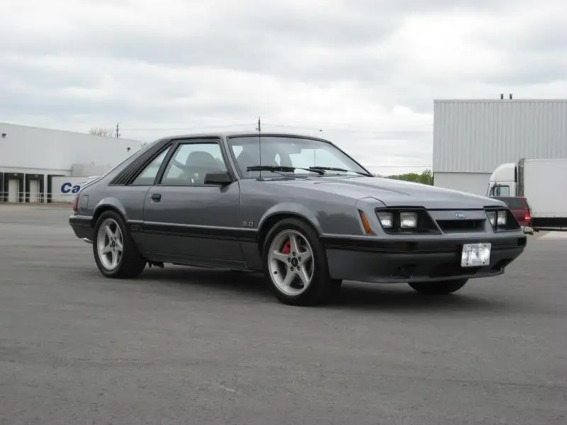

I had started a build thread on here a while ago (before there was 50 build threads on the first page). Long story short almost two years later I finished the car. Ended up building another motor for it too. Its still a 306 and should be well into the 11s.
Enjoy.

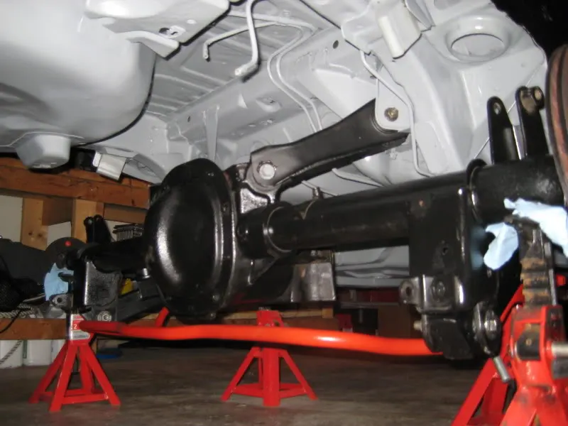

Its even cleaner underneath...

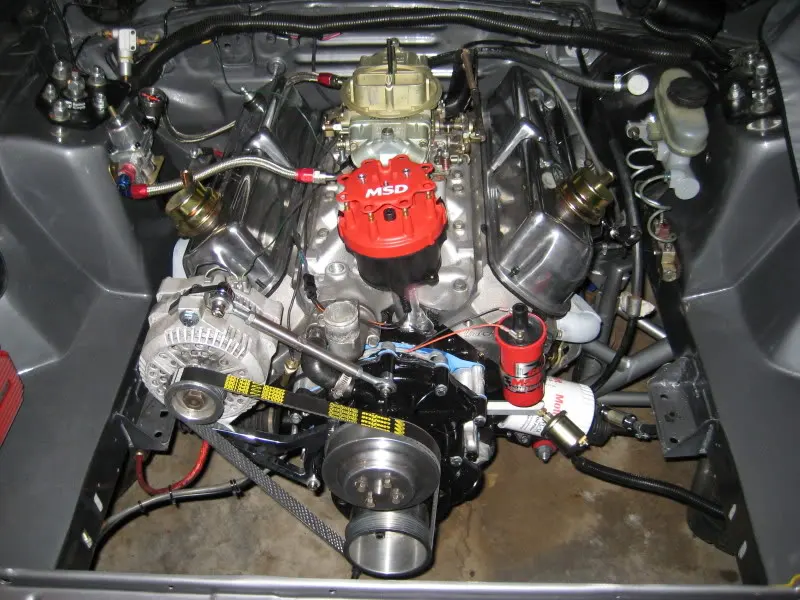

I see you have a sumped tank. Whats the fuel setup? Planning on nitrous or another power adder?

No other poweradders. Ive got a custom CI billet cam so it should run very hard N/A. The fuel system is just -8an braided line to a holley black then up to the regulator where it splits off to two -6 lines to the carb. Pretty standard stuff.
Im just having charging issues I have to figure out and then I will go dyno and tune it.
