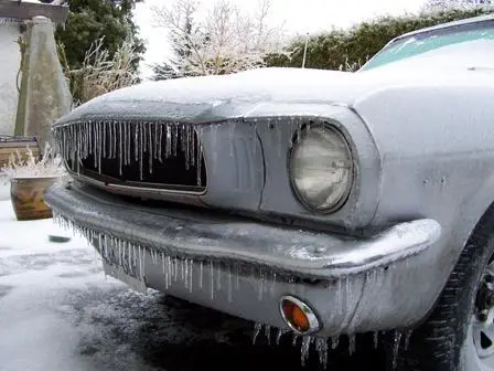

Try working on your car in this crap! Hell, just try freeing your car from it's icy tomb after after a freezing rain storm so you can get to work! I'd rather have it snow or rain, but we get more and more of these every winter it seems.

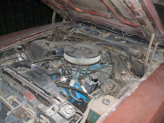

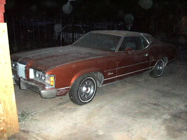

The Victim

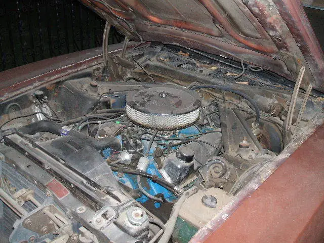

Inside The Victim

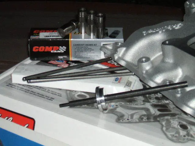

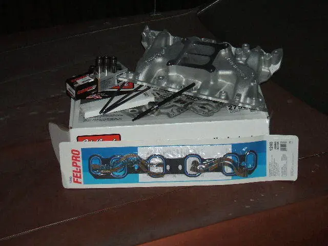

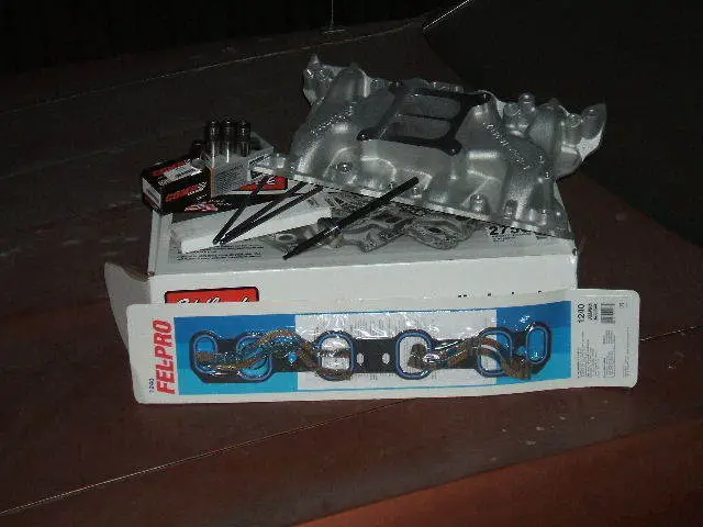

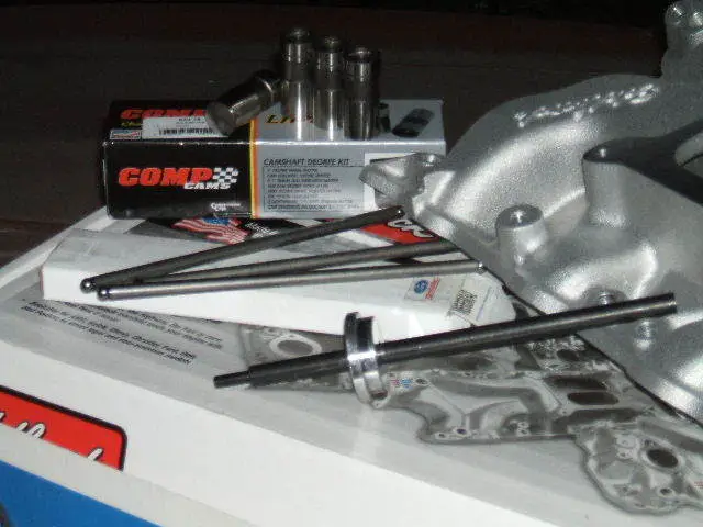

The "Transplant Organs"!
Edelbrock 2740 "Performer 351 4 barrel intake for 2 barrel Cleveland heads"
Fel-Pro #1240 Intake Gasket Set (Last time, I had good luck with Permatex Gasket Sealer holding the cork end gaskets in place. This time :shrug: )
Comp Cams hydraulic Lifters
FRPP Pushrods
Summit "Pre-Oiler 5/16" Driveshaft"
There's a Holley "0-1850C" 600 CFM 4160 already in place; on top of a "4-into-2" spacer. The intake fixes that problem! Original lifters on a new OEM cam... sat around for almost a year, CLACKCLACKCLACKCLACK!
pUSH RODS: NoKitten though he was having troubles with sizing. Seemed like a good idea to put that to rest. The pre-oiler? The car has been sitting around for a year without being cranked over; seems like a good idea (especially since the Distributer is coming out to make space to install the intake) to get some oil moving around before the crank and cam start spinning in their bearings :nice:
