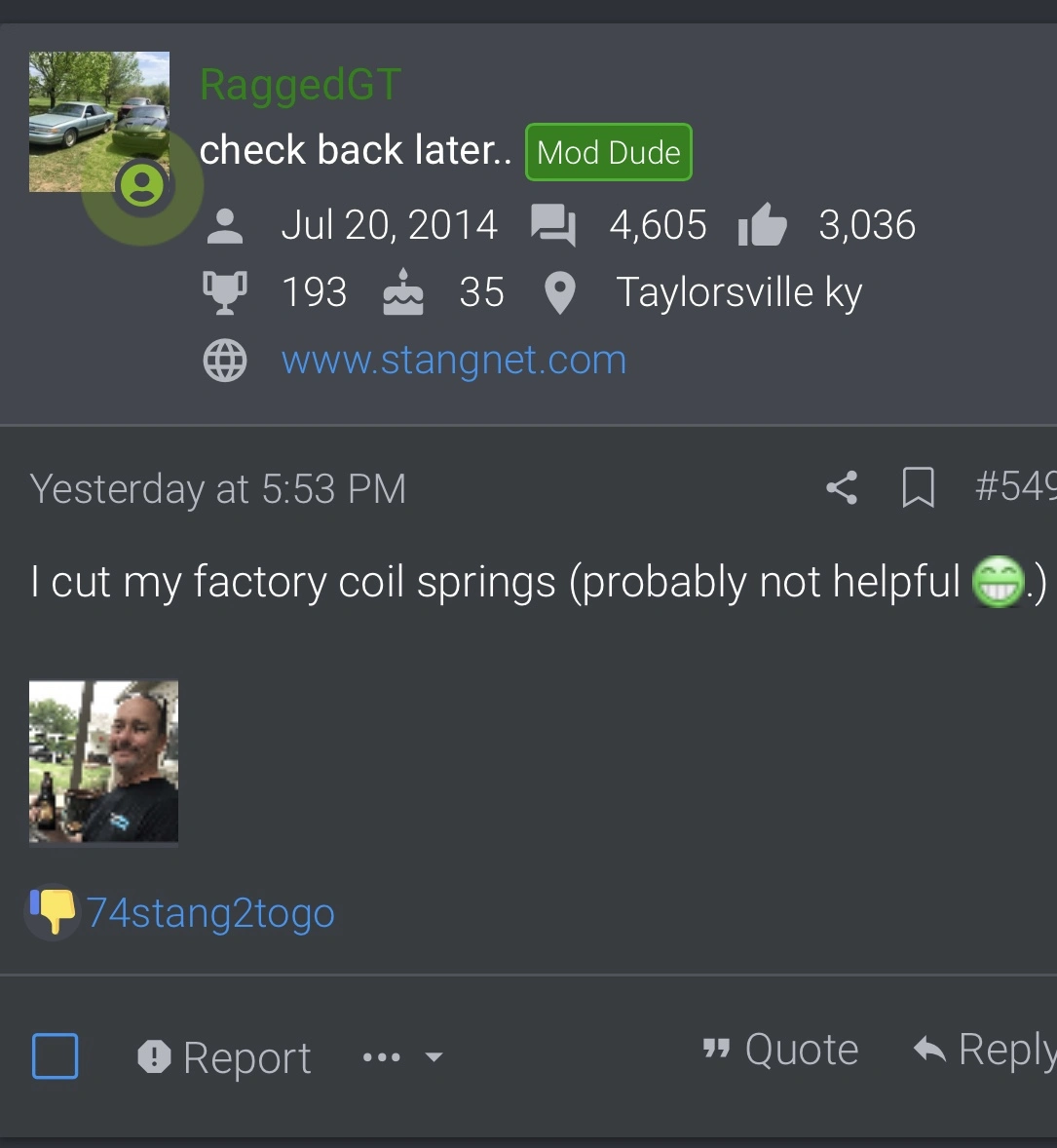

I cut my factory coil springs (probably not helpful .)

Yeah I know that's one way to do it @RaggedGT. That's what my brother in law said to do. Its free.

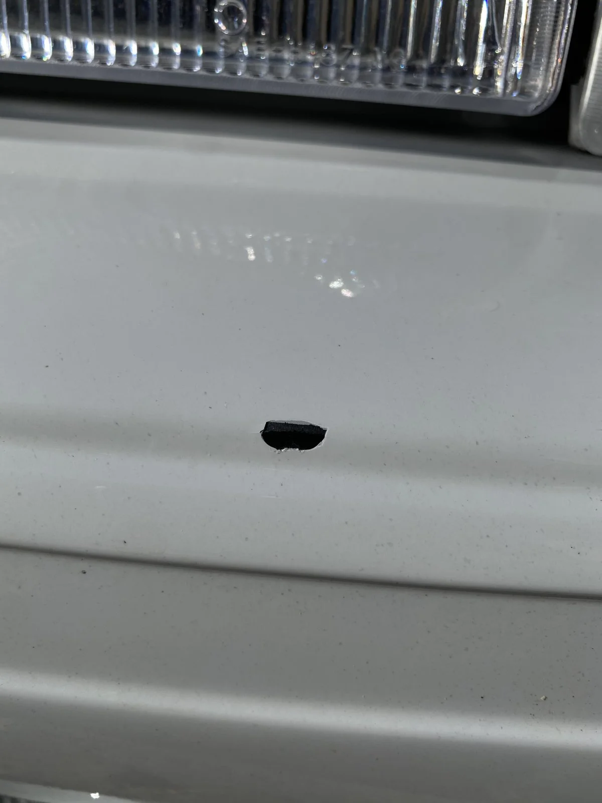

I drove my car to work this morning and got a nasty chip in my front cover, and a little one in the new windshield. I work 26 miles away from home and really have to take the interstate or local city highways to get to work. There was a truck that was dropping rocks and I heard them hit the car And windshield but that’s the only one I found that damaged the paint. Well, I managed to go a year without any. Ive been driving it quite bit lately so I guess it’s no surprise. It’s a big one though. I think I have some left over touchup paint at home. Taking city streets home.

Somehow I knew, that when I posted about cutting coil springs-you would be the one to dislike it....

Agreed lol. For the record,I’m not spouting off saying it’s the correct way to go about lowering etc. There are far better ways. But for me,I trim a quarter at a time until I get the height I’m looking for while retaining the isolators and have had zero issues

Yeah @CarMichael Angelo I see your point. The thing that worries me is its chipped on that aftermarket front cover. I'm hoping it doesn't get worse. I don't know if you remember but that bumper cover was peeling all over the place when I bought the car. I'm hoping it not the coating underneath all the materials that's peeling. I don't think it is but time will tell. I prepped the out of that bumper when I prepped it last year. I touched it up and hoping that it'll hold up. Really don't want to pull that bumper off again and redo it.

The Monster has all kinds of chips on him ( mostly because I’m a clod). I just dont see a way to keep it from happening if the car is driven. Even more so if it’s daily.

Well, our business is still considered essential. (Collision industry.) I've been taking advantage of the light traffic, so driving the Mustang lately has been fun. Im not too worried about it. Like you said, its not a garage queen or a trailer queen. Crappy thing is there isn't a radio in my car.
