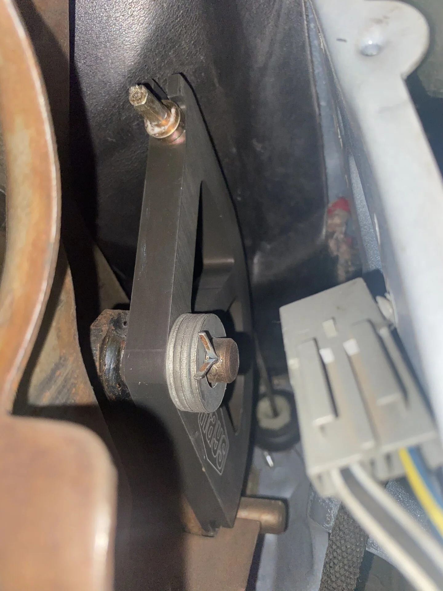

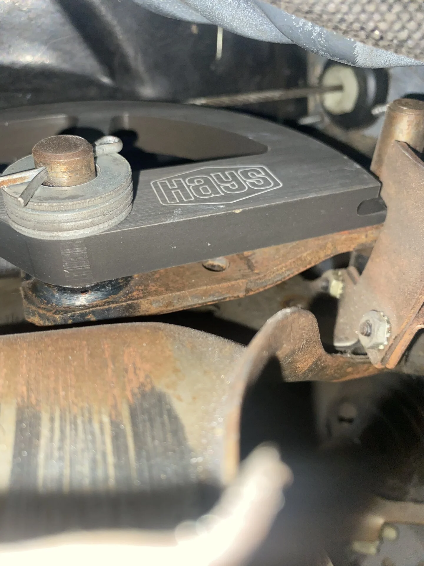

I received the parts in the mail yesterday. Hopefully Ill have some time to install this weekend. Its been probablt 15 years since I installed these things. I think the last time was in my 88 convertible. I remember the quadrant being a pain in the ass. Going to pull the seat out. Im 6'2". It supposed to be sunny and in the 50's Saturday. Looking forward to getting that clutch were I want it.
I’ve never looked to see what was up under there but look like there a single hook Hays quadrant already installed. I figured the car still had the stock quadrant.
I did buy the UPR adjuster. I might just start with that and leave the quadrant. What do you guys think?
I’ve done it in the past, I know it’s just hard to get up in there. I can’t find much info on that brand online. Would the double hook Steeda quadrant I bought benefit me at all over this?
From what I understand the Steeda allows for use of different type of cables or adjusters.
As far as strength, that Hayes one looks like it’s a lot stronger than stock. Id probably leave it and just do the adjuster.

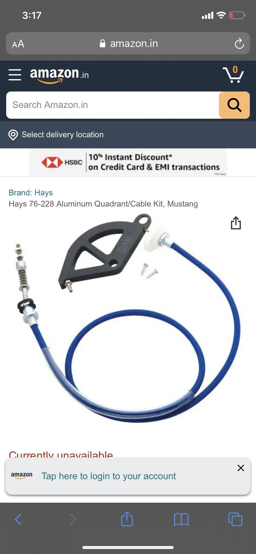

Found a listing for it on Amazon. Jegs sells the Hays cables. Looks like the quadrant that’s in my car.

Probably right. I thought for sure that my car had the original quadrant. I’m surprised. I bought this car from a one of my friends dads in 2016-17? I’m the third owner. He had that car forever. Maybe my friend put that in for him after the stock quadrant broke.
I shouldn’t have a problem with using the existing single hood quadrant with my stock style cable and firewall adjuster, right?
Reading up on single, double and triple hook quadrants, adjustable and non adjustable cables has me a little confused. Anyone have any suggestions? I just dont want to have to do this twice .
