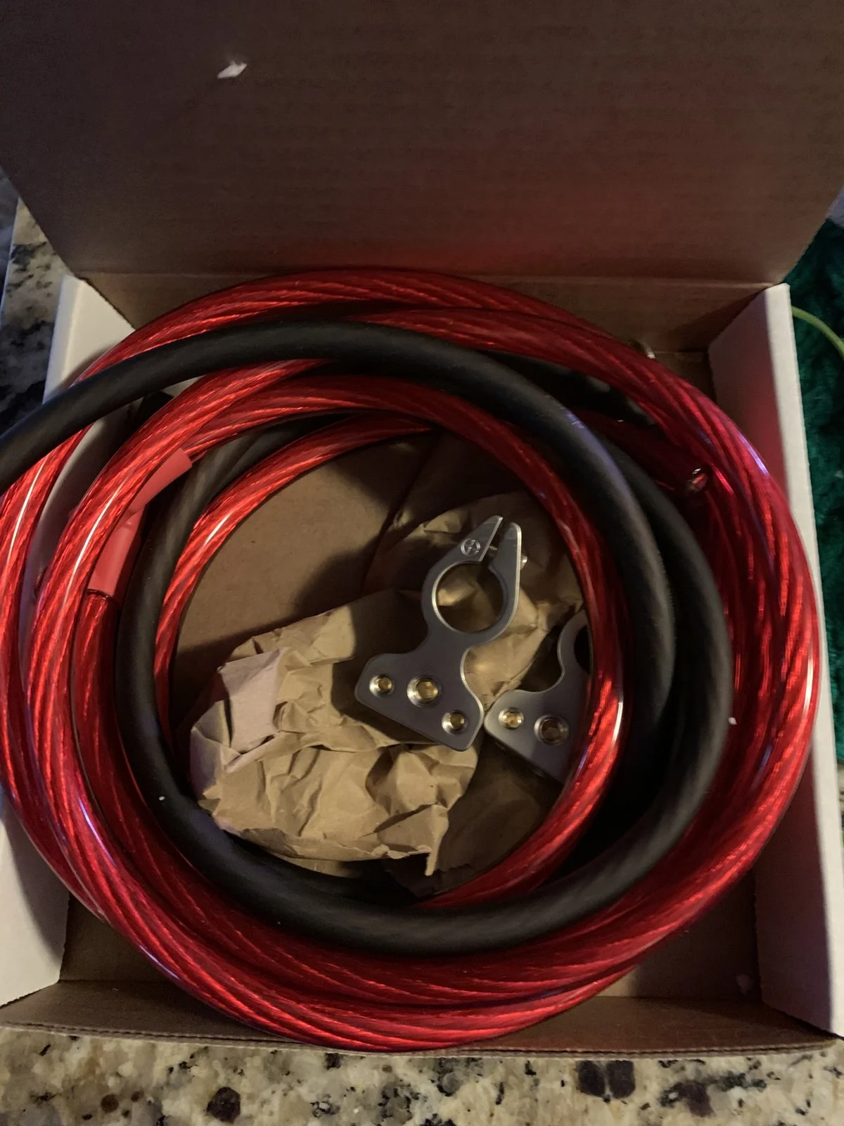

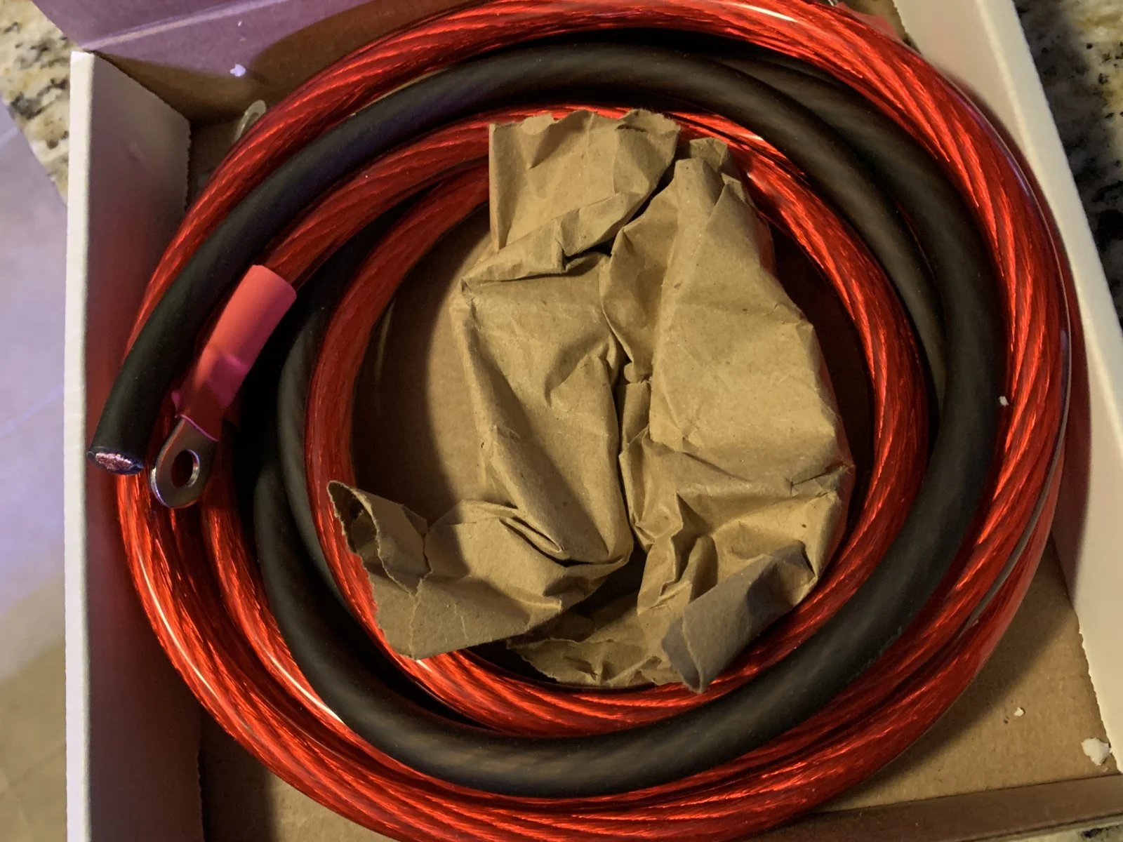

Just got this in the mail today, though no instructions were included so hopefully I can manage to install without electrocuting myself.

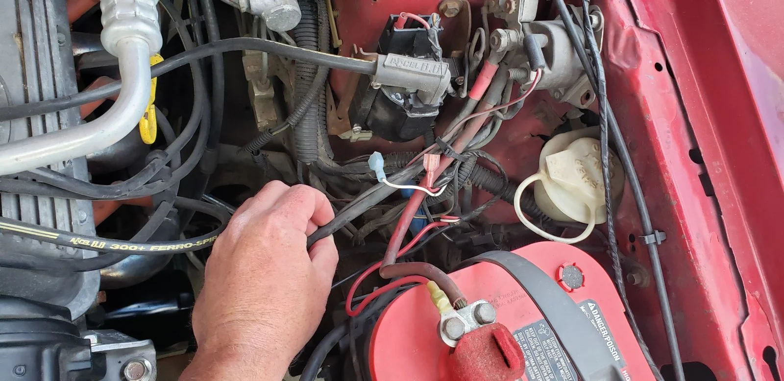

I’m sure that broken terminal is not a secure connection, and could be causing you some issues.
Make sure your battery is disconnected, and it’s just nuts and bolts to change the wires.
I put the PA terminals on my car.... real nice quality!

Looks like a good battery to me. Now....on to that cracked terminal.

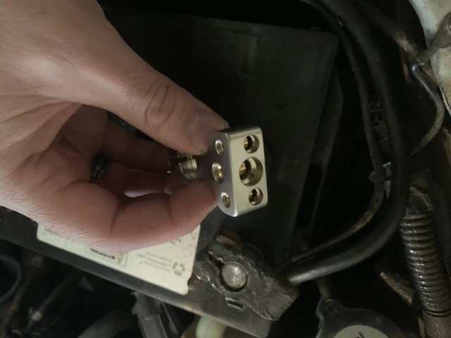

Negative looks like it does not have the extra ground wires.
Wondering if maybe I can just use the existing ground wire and it would attach in one of these extra holes on the new terminal?

That should work as long as the wire is good.
Yep. Cut the wire, strip it back a little, and clamp it down!

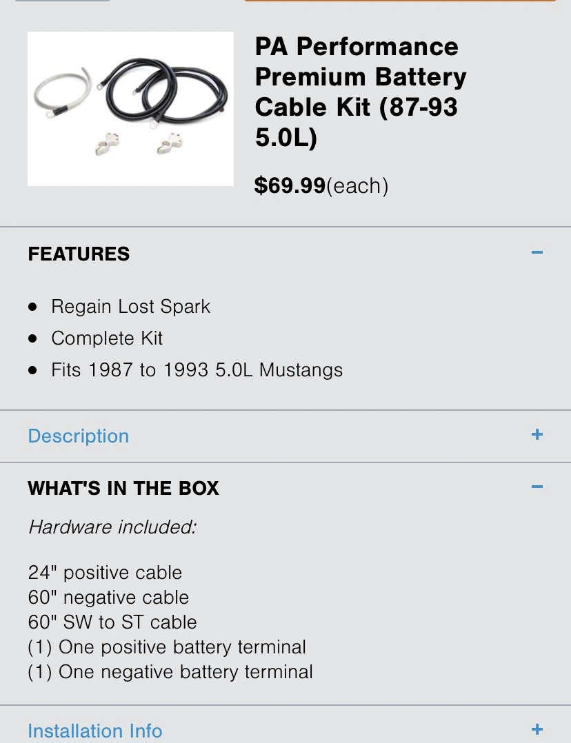

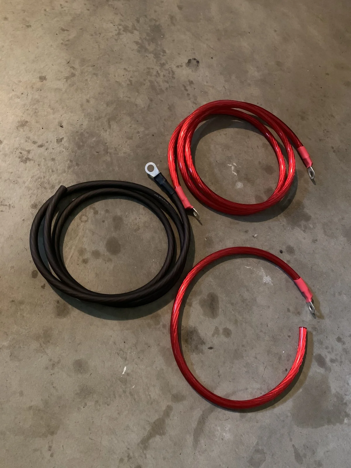

Ok so I’m looking at these battery cables and I’m a little bit confused.
I understand the black cable is the negative and the short red cable is the positive but does anyone know what the longer red cable is for? Here’s what is described on AM (don’t judge me, I had some gift card money leftover). What is SW to ST? The google isn’t producing a lot of helpful results..is it something that connects to the alternator perhaps?

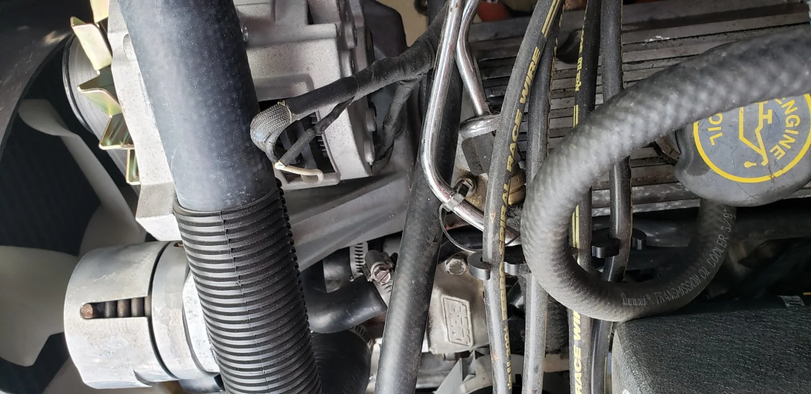

Yeah, the shorter red one goes from battery + to the post on the solenoid and the longer red one goes from the solenoid to the alternator.
Just copy how your cables are routed now.

On my car the ground goes to the timing chain cover. Then there is a short red wire that goes from the positive battery post to the starter solenoid and another heavy gauge wire with a bit of red on it that goes from the other solenoid post to the starter.
There isn't anything going directly from the alternator to the starter solenoid. That I see.

I think mine goes in front of the radiator. Check there across the top , just below
