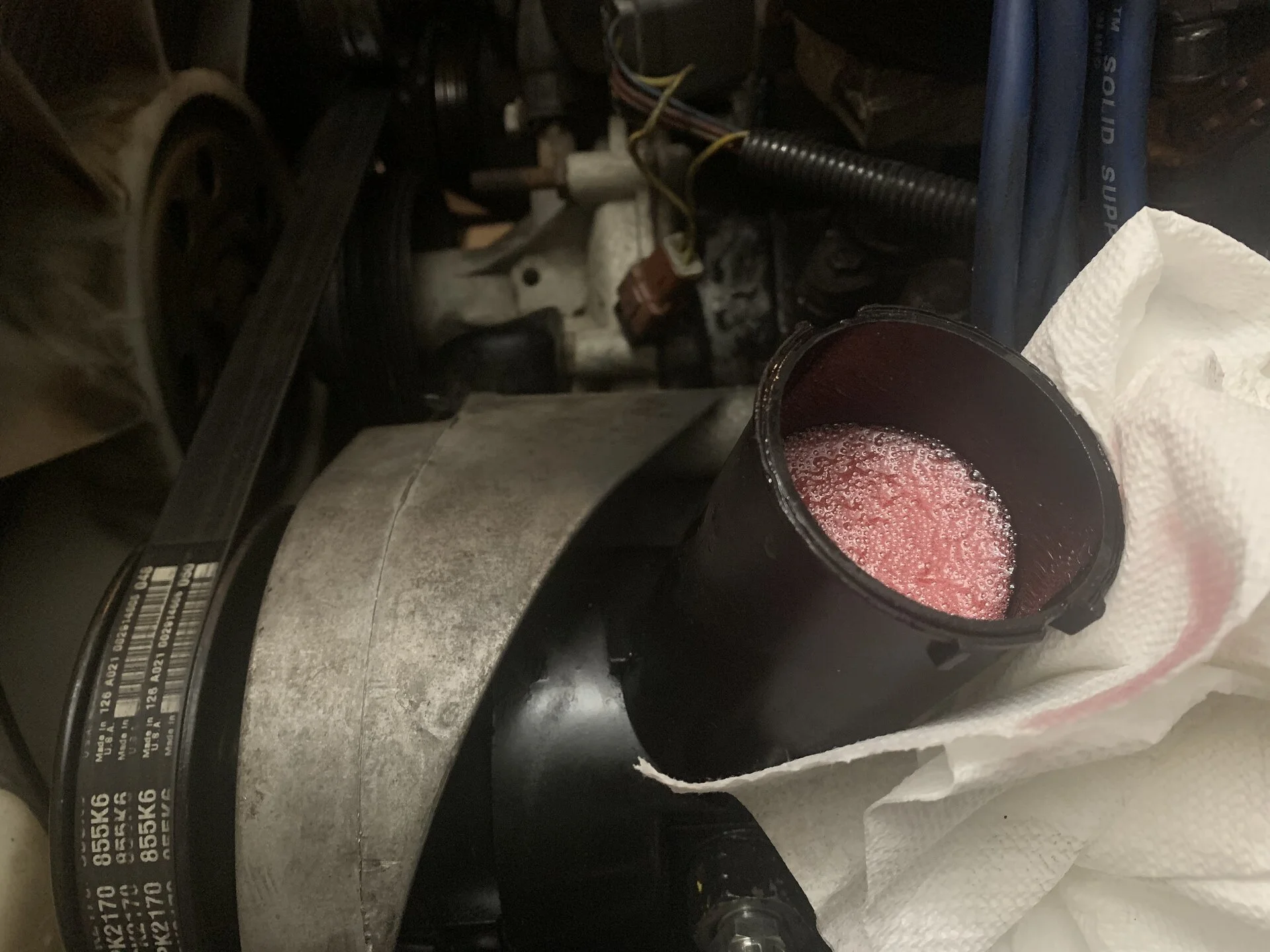

I’ve got a lot of messages in here to respond to but...priorities first. We just finished replacing the power steering pump. Put almost one quart of Type F fluid in and started the car up. The fluid went down so I started putting more in. The pump started making a loud whining sound, lower in pitch than the sound I was dealing with previously and it’s definitely coming from the pump or the pulley. After I turned the car off, the fluid started foaming a little bit and close to overflowing.
My two theories (guesses really) are that either the pump is bad....or that the return hose that runs from the pump to the power steering cooler is too narrow...though I’m not sure that would cause the sound. We got a length of generic power steering hose from auto zone and it was a tighter fit on the ends.
Any thoughts? Lol
Neighbor friend of ours who is a mechanic came by and took a look and had me start and stop the car a few times and turn the wheel from side to side. Seemed to help get rid of some of the bubbles/foaming and definitely reduced the volume of the noise. It’s still making some noise but it’s much quieter than when we started it up.

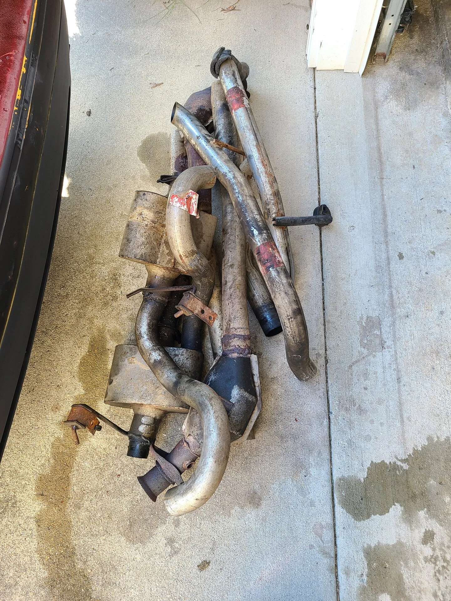

Hardest part honestly for me is getting the bolts loosened up on the driveshaft.. and if you have a factory mid pipe you'll enjoy dealing with the rusty exhaust bolts otherwise just take your time and drink beer.
I have an off-road x-pipe that was installed by a previous owner. Based on my experience unhooking the exhaust to get the LCAs in, the exhaust hardware has seen better days.

I could come that way too. Might make it easier for you. I know you want to get some cleaning done so I could come out and help you remove it...then come back for install. Once you see how it comes apart you may be fine putting it back in by yourself. The t5 isn't heavy at all. The hardest thing is getting the header nuts loose. Takes a long extension and a good universal joint. They sit at an awkward angle. Everything else is easy peasy.
It should only take...maybe 4 hrs tops to pull the t5. By myself I can have them out in about an hour and a half if the exhaust bolts cooperate. The last customer I had to do this to his...
His exhaust was completely shot. If you are thinking about headers or h pipes this is the best time to do them. The bolts to worry about are the ones at the header and x pipe connections. Either way I have everything to get them off...one way...or another.

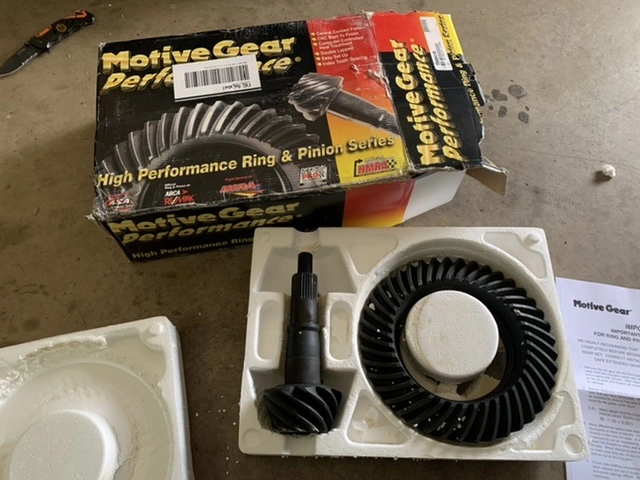

An unexpected gift arrived today...
My friend Ben who helped with the power steering pump - him and another friend sent me an early Xmas gift. I had been trying to decide between 3.55s and 3.73s but I guess 4.10s were decided for me, lol. I’m willing to give them a try and see how it goes
Funny thing, the other friend...him and I got Ben a set of 4.30s as a birthday or Christmas gift like 15 years ago when he had a 2002 Mustang GT. He had them put on the car and kept them until he went with a built engine/pro charger setup and then moved down to 3.73s. I remember that thing being pretty bananas to drive with just the 4.30s.
