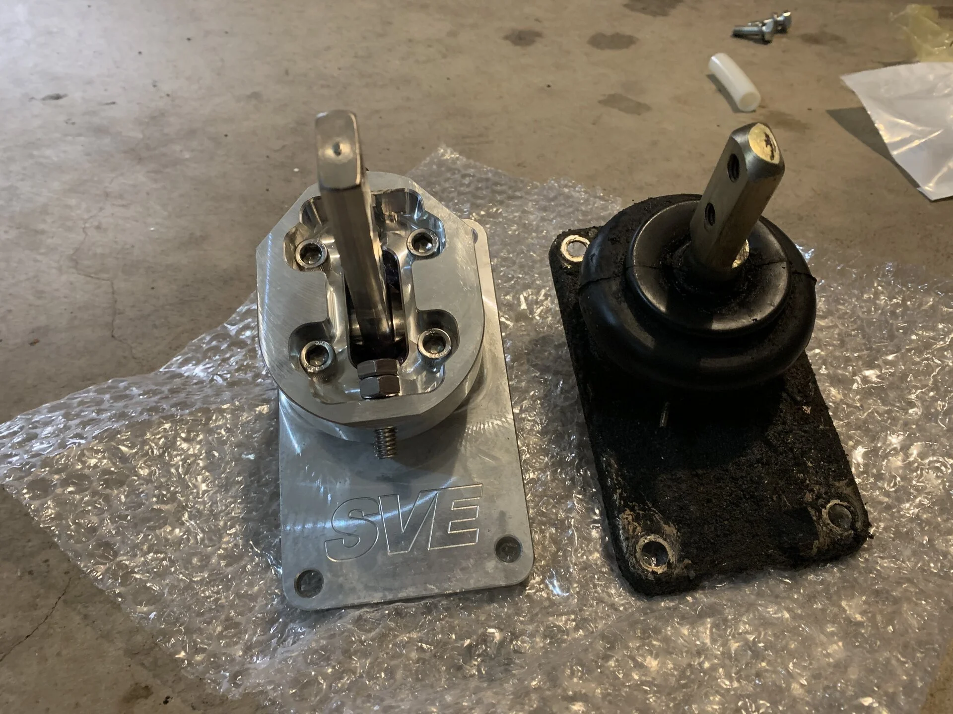

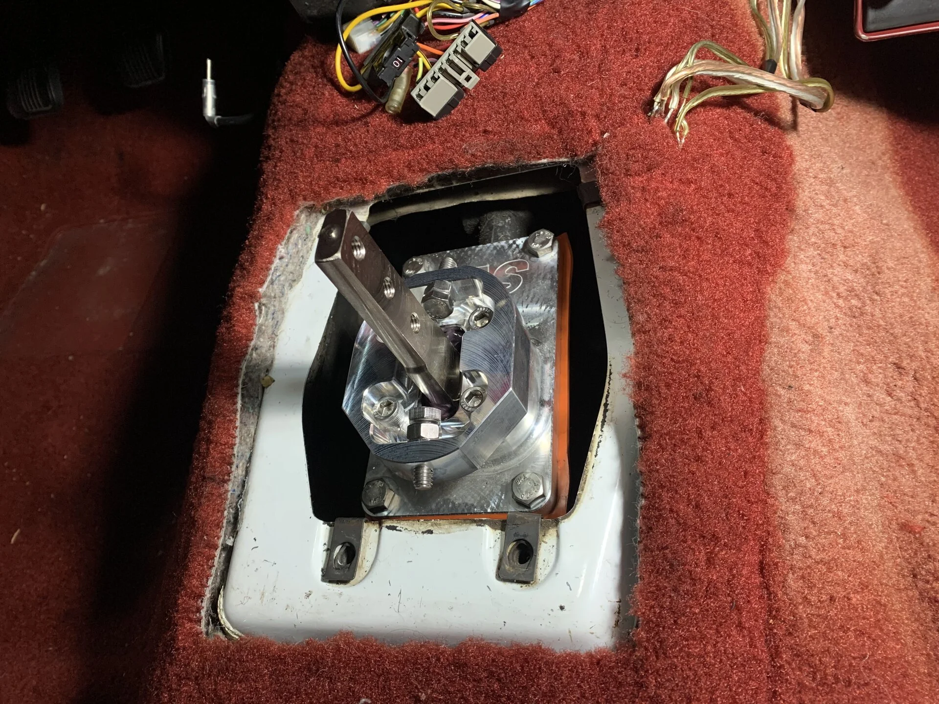

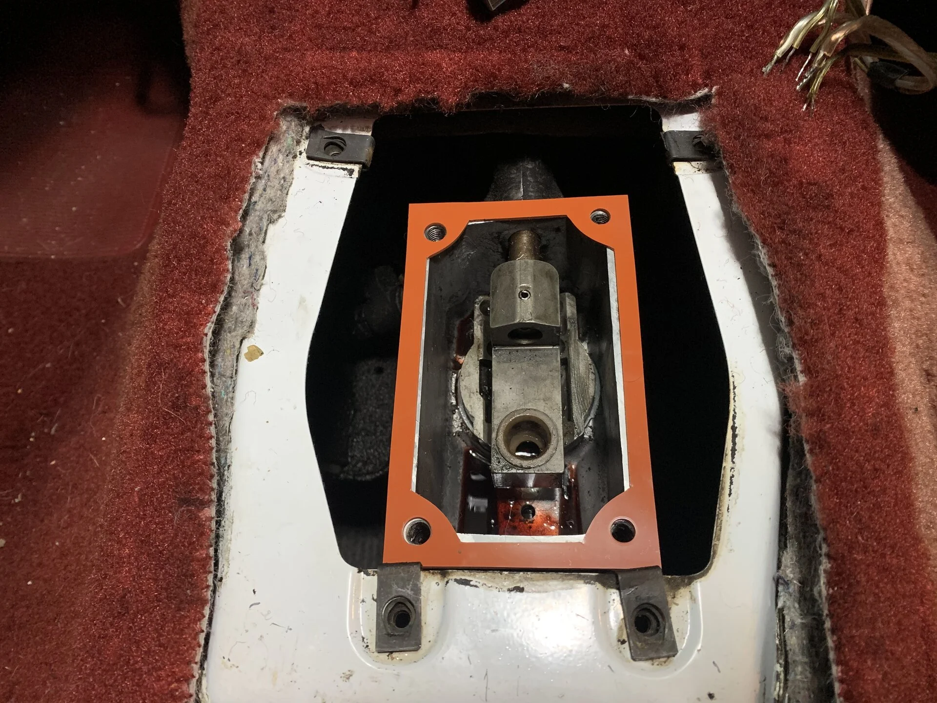

I managed to get some more cables/wiring removed from under the carpet, en route to discovering I have no idea how any of this stuff works or where to even start trying to wire the speakers to the head unit, lol. The Fox might need to go without music for a while until I can figure out a new setup and either learn how to install it or have someone more knowledgeable help me out.
In the meanwhile, I got the new gasket and shifter in. I still need to adjust the stop point bolt things.
I’m waiting on a new lower shift boot and metal ring to arrive. I suppose I will do some vacuuming before I start putting the seats back in.

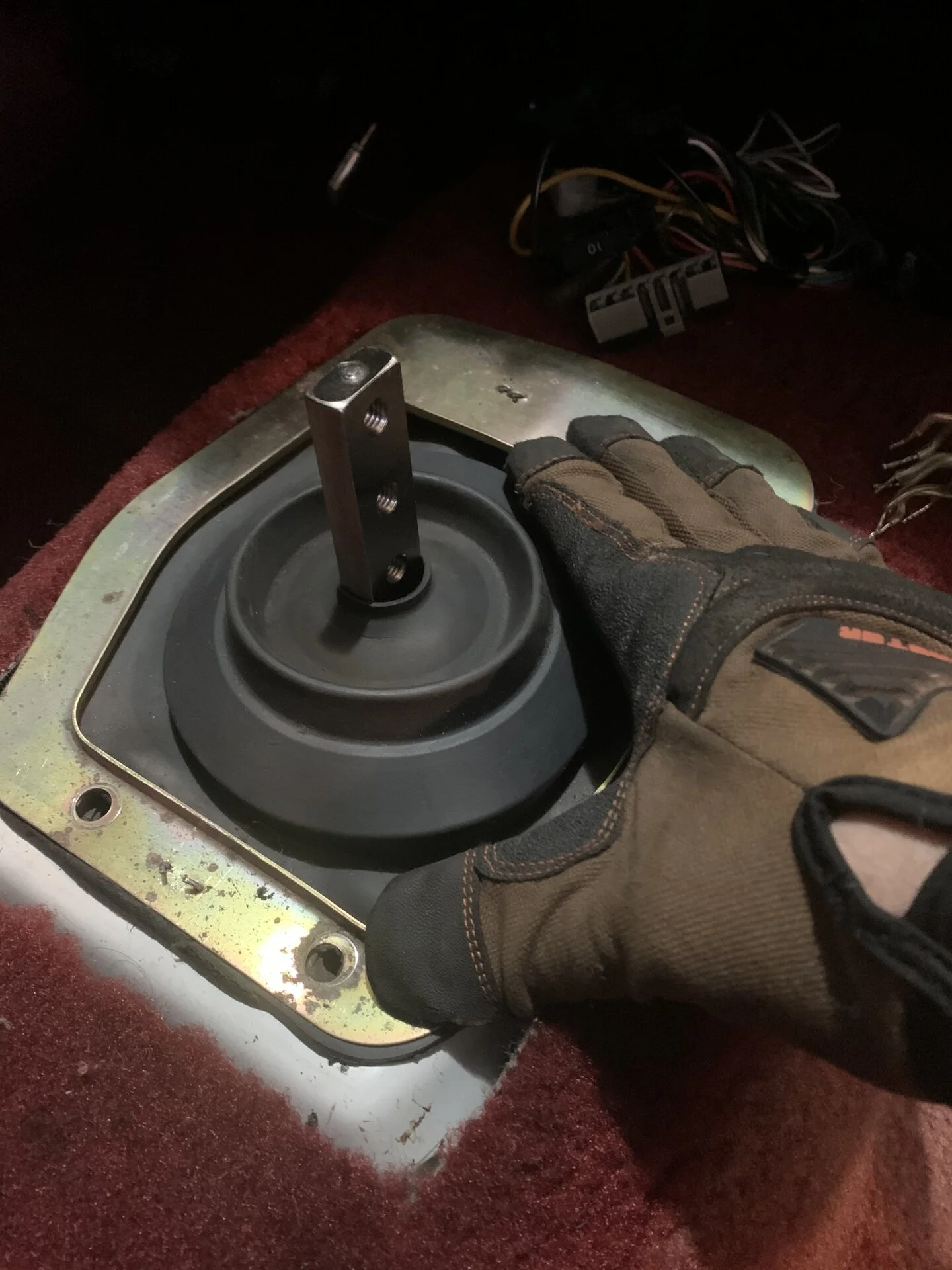

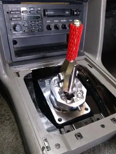

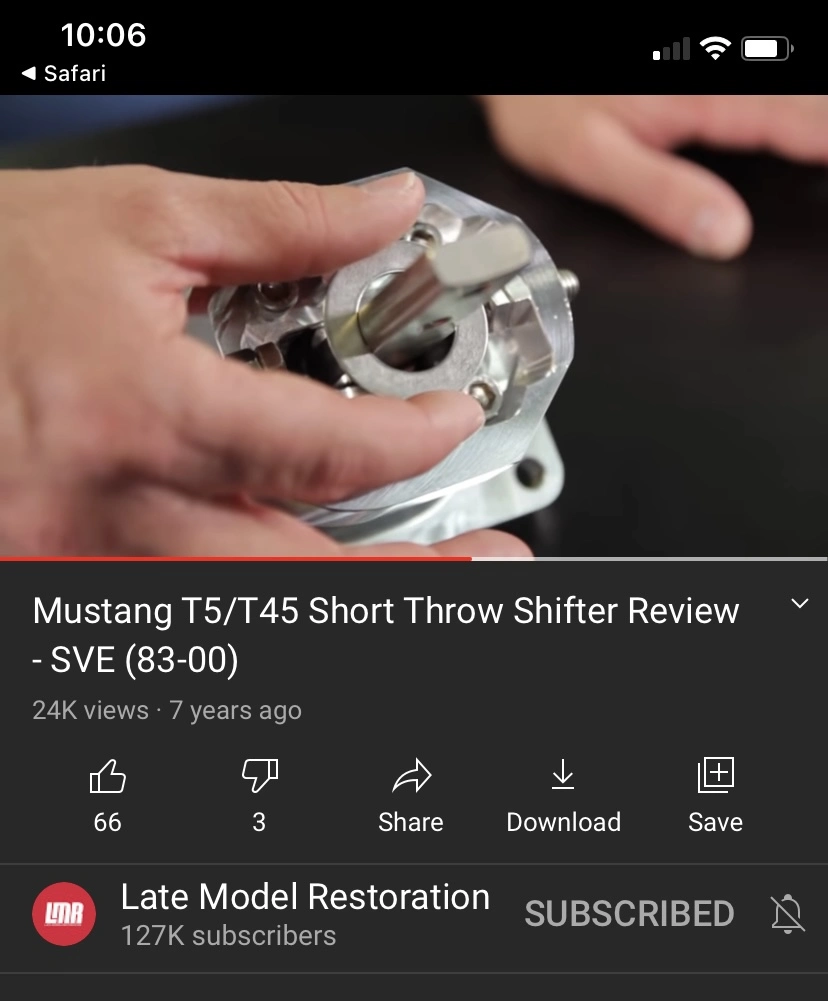

I was looking at the hardware yesterday and it does include this washer which supposedly prevents the shifter boot from getting caught in the shifter stops and in the same video I got the screenshot from, that’s where he says the lower shift boot doesn’t need to be modified. I guess I could try with the old one and just see if it fits.
Another shot from the LMR page that shows how it looks with shifter handle but boot not on yet.
DudeStang
Apr 30, 2017
465
238
53

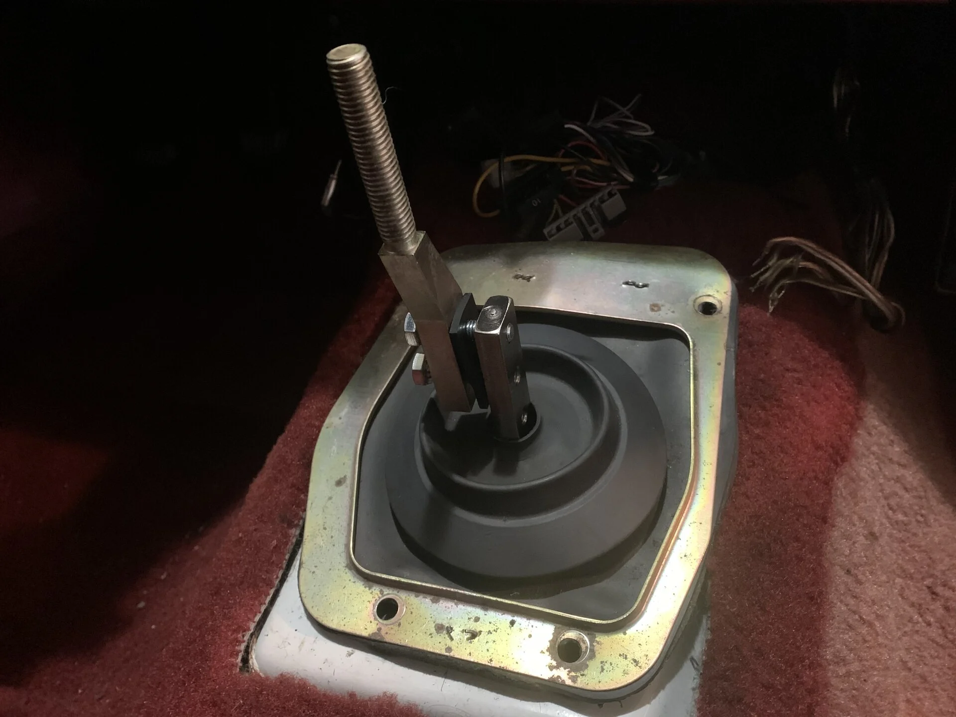

Just tried it with the old lower shift boot and it seems to work as described. I put the washer on first and then the boot.
Here it is with the shifter handle it came with
I believe there is a boot that fits around the shifter mechanism itself, before that goes on. That keeps stuff out of the cabin, the other boot protects the shifter.
DudeStang
Apr 30, 2017
465
238
53
Ahhhh...I didn’t realize that. I should have ordered a replacement one of those too. Will have to look into finding one that fits with this shifter.
