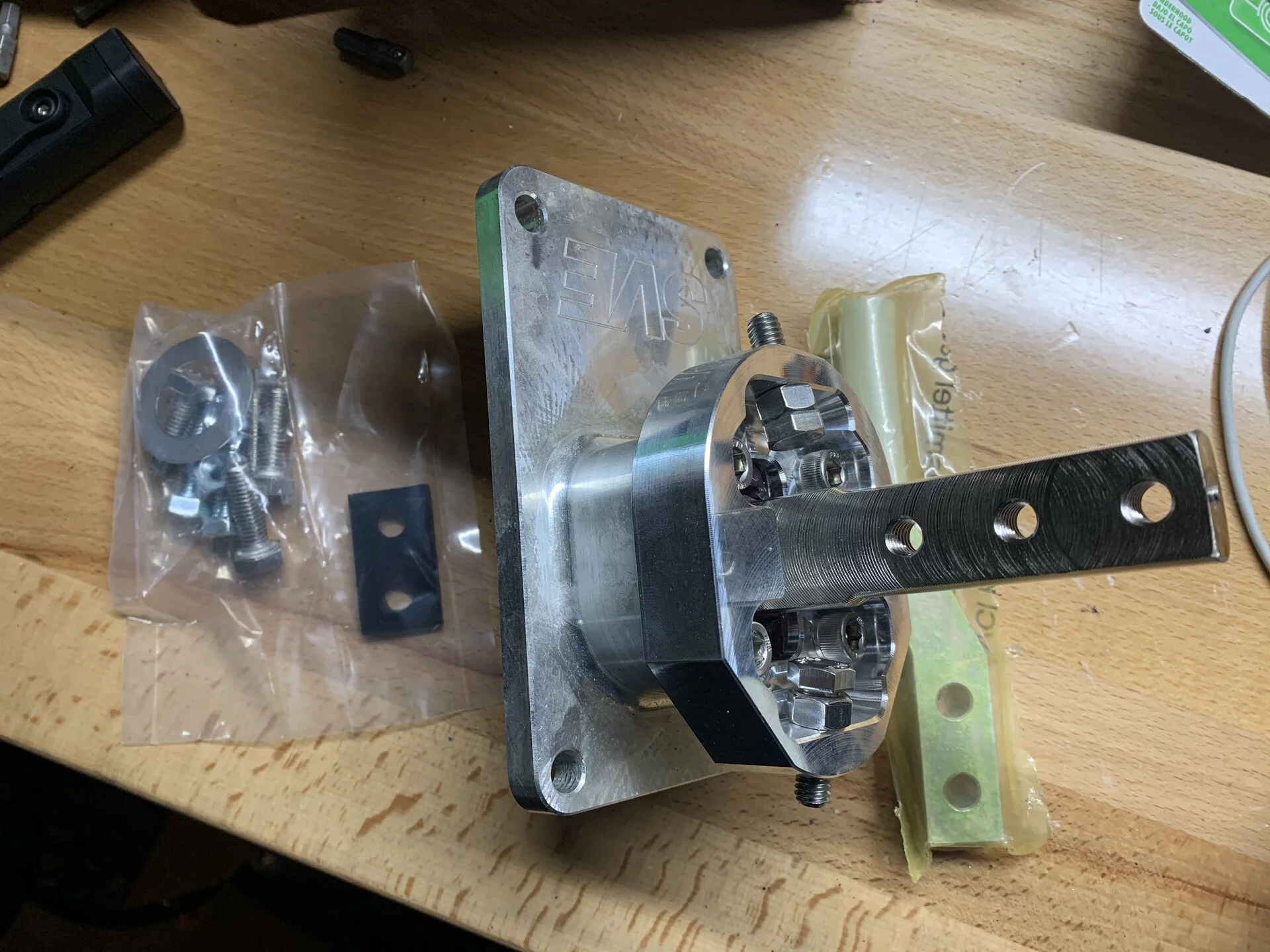

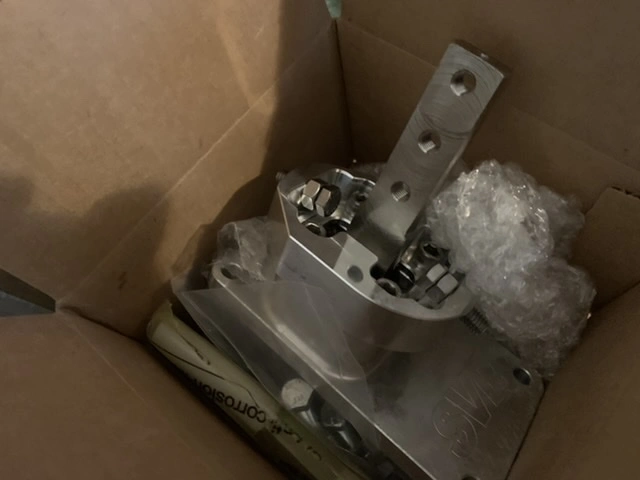

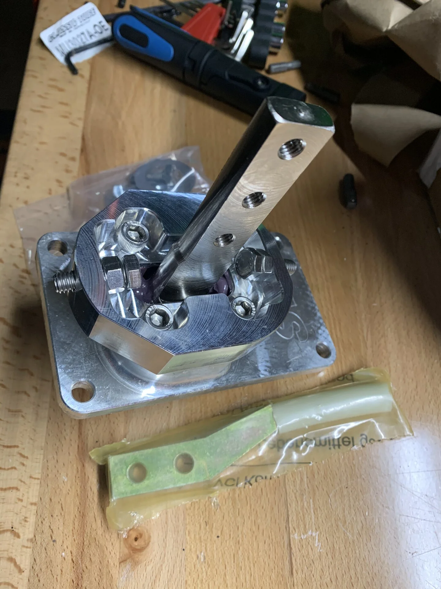

My early Christmas present to myself arrived yesterday. Ordered the SVE short throw shifter. I picked this one over the Steeda because it had better reviews and was slightly cheaper. Plus, I already have the Steeda shifter handle so I figure I can at least try both that one and the handle that came with the SVE, rather than having two Steeda shifter handles. Will probably try to get this installed over the weekend.

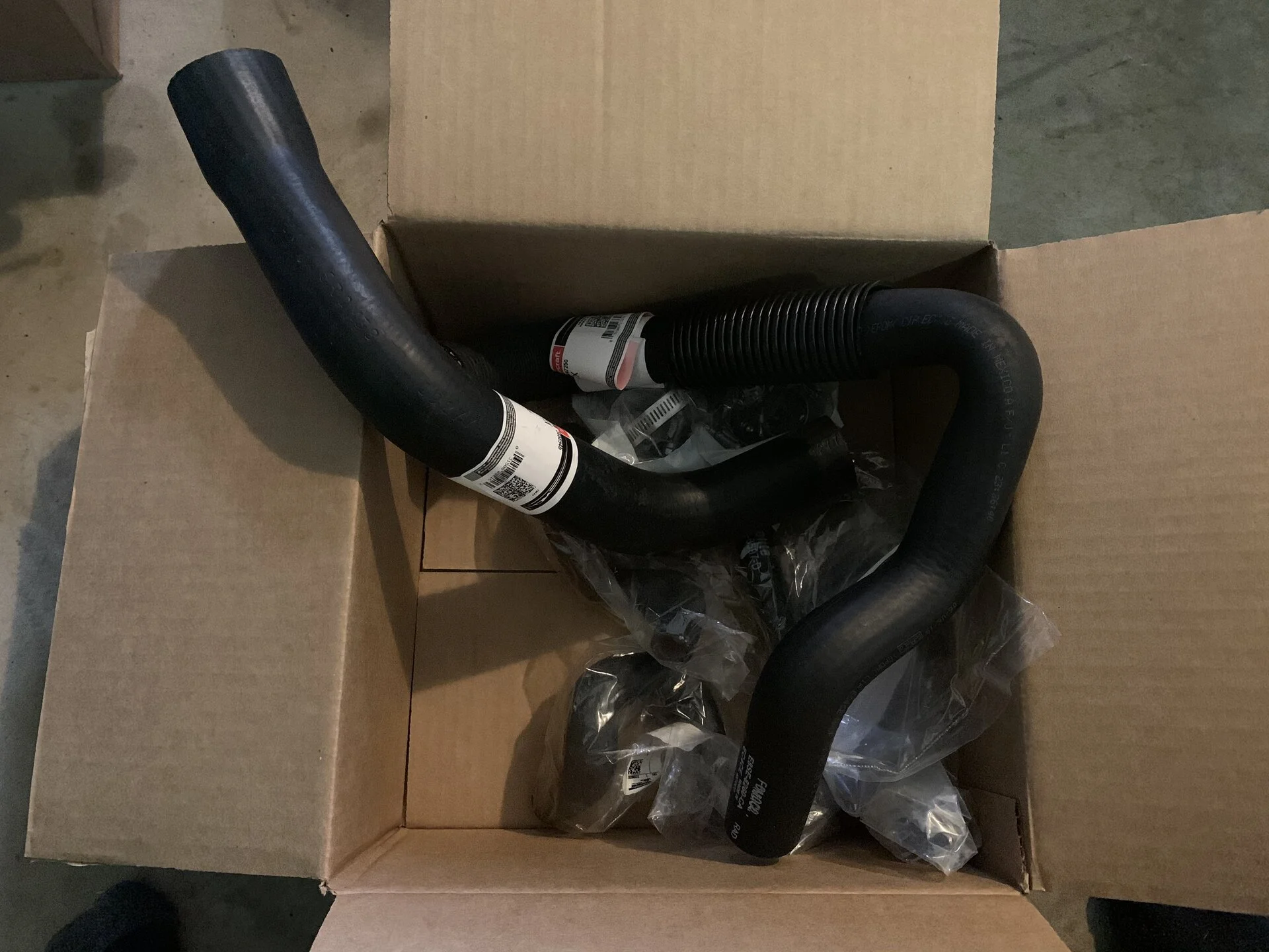

Will likely try to do the radiator hoses soon too, since those arrived a couple of days ago:

Ok we'll talk about the shifter first, when replacing things we all know there are other things related to the part in question, in this case there is a rubber seal that bolts to the floor and the shifter sticks up through a hole, this gets brittle and torn, I would plan on replacing it because when you install an aftermarket shifter you need to trim the hole to fit tight around the shifter tower, it needs to be pliable (soft/streachy) so it seals around the tower to keep out road dust and hot air.

Water pump, this is subjective, If you do nothing, not replace the seeping hose and just kind of forget about it it will likely last a long, long time, if you go to all the trouble to replace the hoses and not the pump, well you can guess what will happen, the water pump will start seeping out that weep hole you read about in about a week, you won't even have to drive it, it will just happen as if by magic so if you replace the hoses I would do the pump too. JMO.

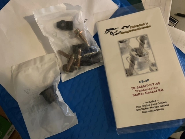

Shifter bushing, gaskets, and lower shift boot hardware arrived today. Planning on giving the SVE shifter a try tomorrow.

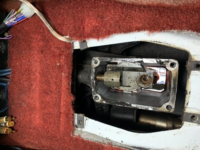

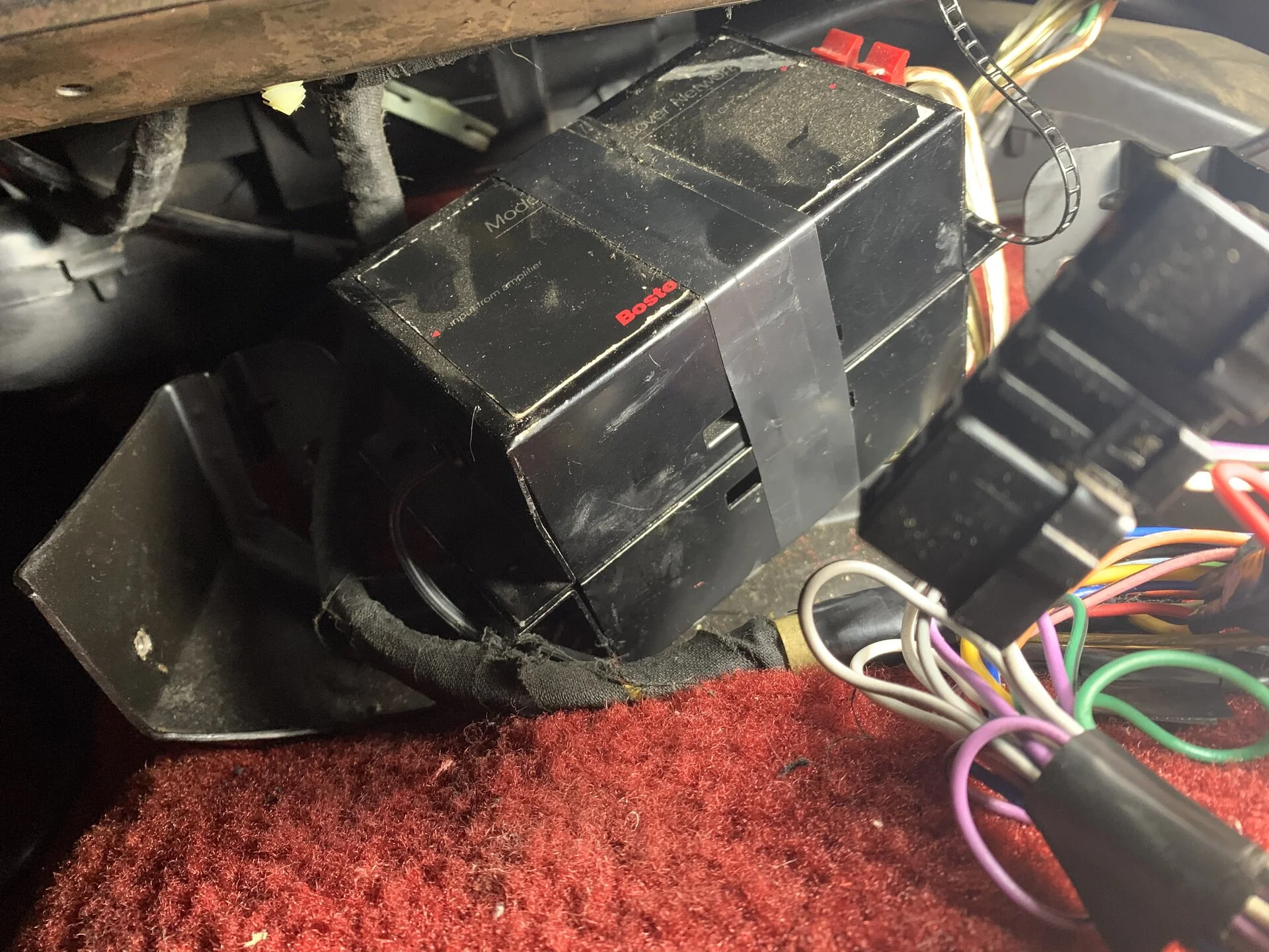

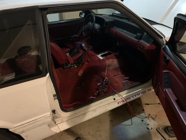

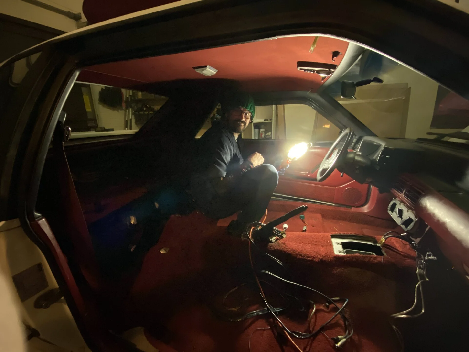

Took out the console yesterday with the intention of installing the SVE short throw shifter. It was a pain in the ass (will explain in more detail when I finish my next video) but I managed to get it out...and now since I have it out, I’m trying to figure out which wires/cables I can pull out since I removed the subs and amps from the old system.

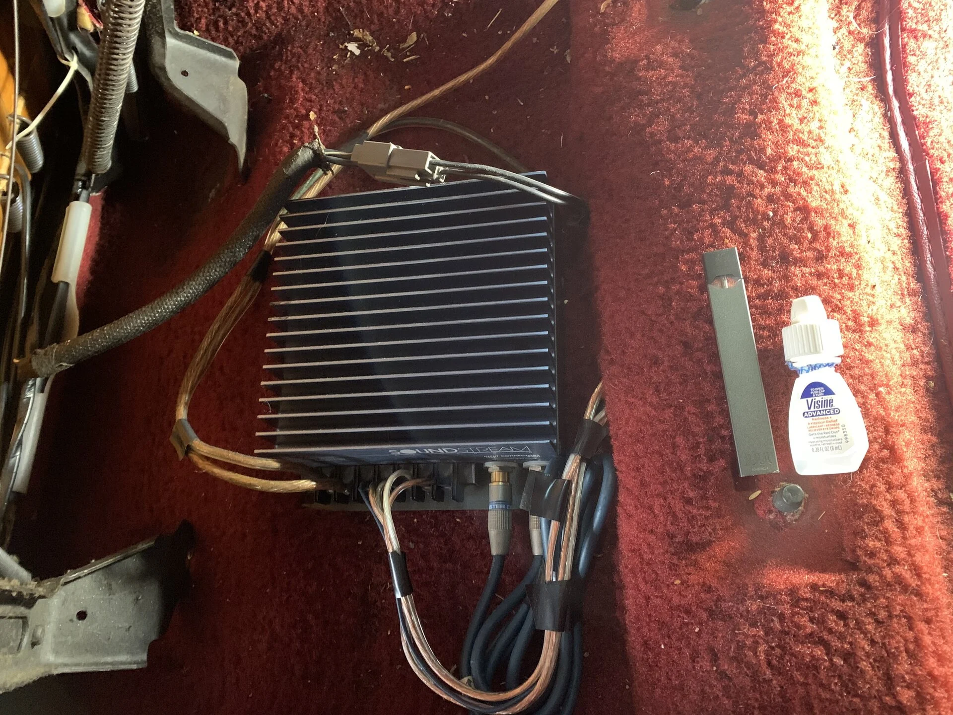

Another amp was under the passenger seat, along with some vape cartridge thingy and some eye drops, I assume from the previous owner.

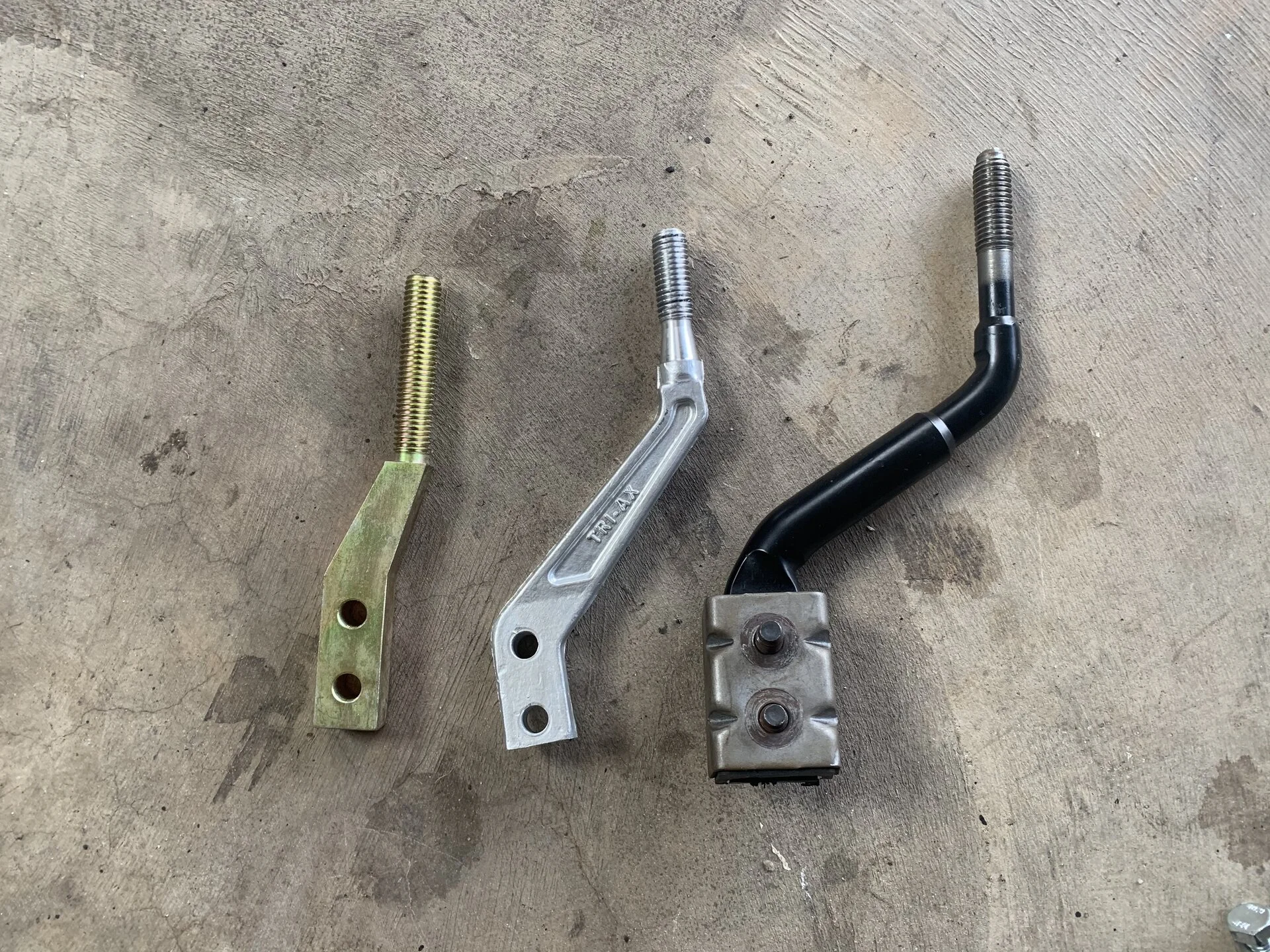

A little side by side comparison with the factory, Steeda, and SVE shifter handles. I will probably try all three with the new shifter and see which I prefer.

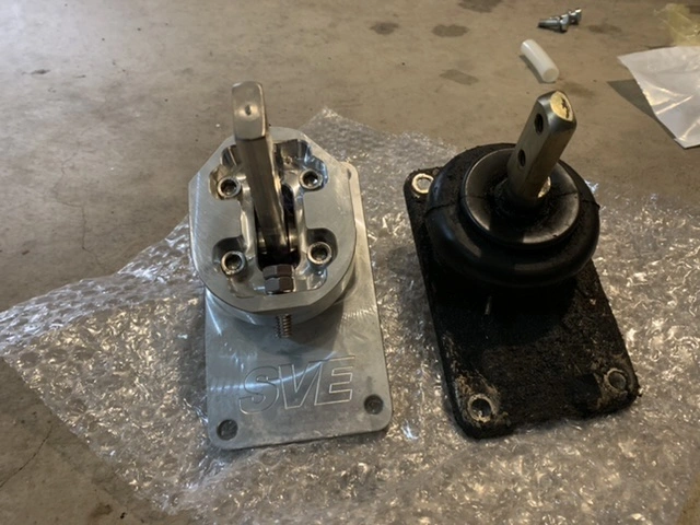

New SVE shifter and the grimy factory shifter

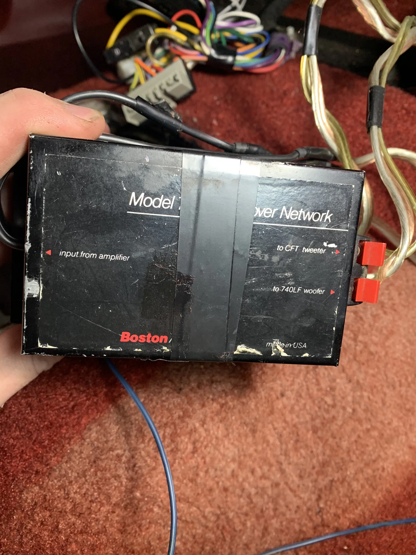

Some more shots of the old school audio setup that came with the car...

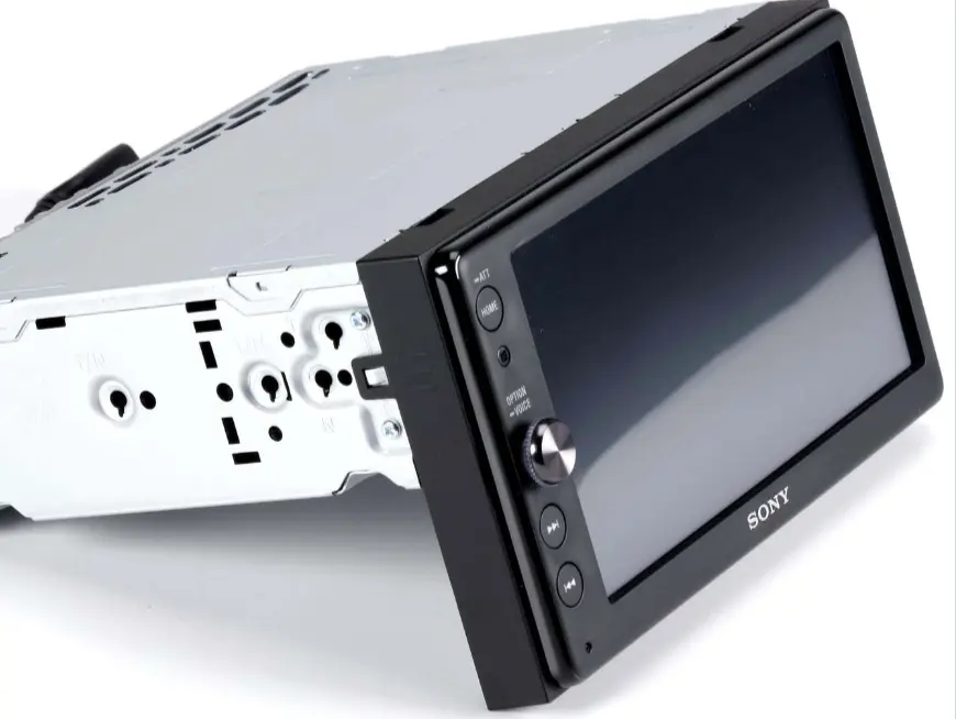

Removing the old stereo stuff has me thinking about doing something like a double din head unit, maybe something with Apple CarPlay (if that exists and is affordable). Don’t want to go too crazy but I do like the idea of having something a bit newer and fancier in the Fox.
The double dins are nice. I've been thinking about one since my phone no longer has an aux jack for the current stereo.
You can get a good double din with car play for 300$, with options as cheap as 250$. I’ve had my eye on the Alpine iLX-W650 for a while.
I was watching a video from Gearhead704 on YouTube and it got me really thinking more about the double din option. I think the one he installed was a JVC. I’ve been looking online and it seems like there are some solid options from Best Buy. Might need to go look at a few in person soon.
The double DIN's without the CD player fit quite well in the lower spot. It's the older ones that are big boxes with internal 6-disk changers that have issues clearing the trans hump without removing the bracket and trimming the studs down. Even something like the sony AX would fit quite well.
If you do want the big box units, you can get one of those new relocation kits that moves the radio up. Only downside is it's rather permanent
