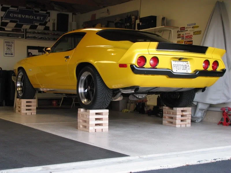

I built a set of cribbing blocks out of 2x4s with the sole intention of using them when I welded in a set of jacking rails,
they worked great and are rock solid.
I would have to measure but I think I built them 12"-14" high, simple 2x4 and screw construction.
They do get the car a little higher than jack stands being that the cars tires are resting on them and it
is very stable.
There's some drawbacks ,you have to be able to get the car up on them , they are heavy and they are not
easy to store if you have limited space.

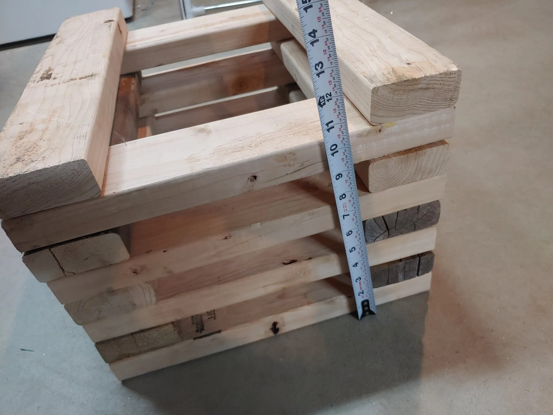

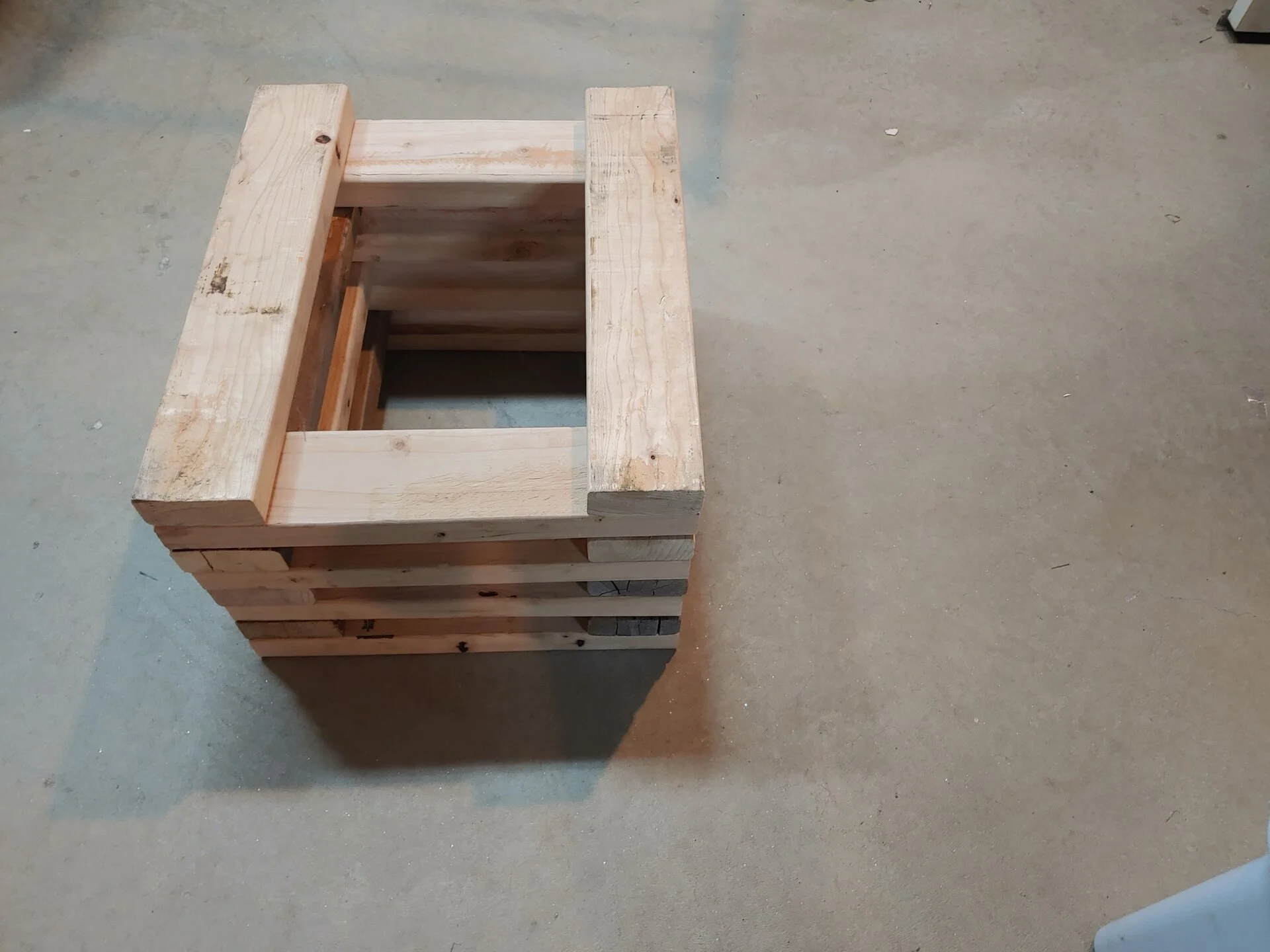

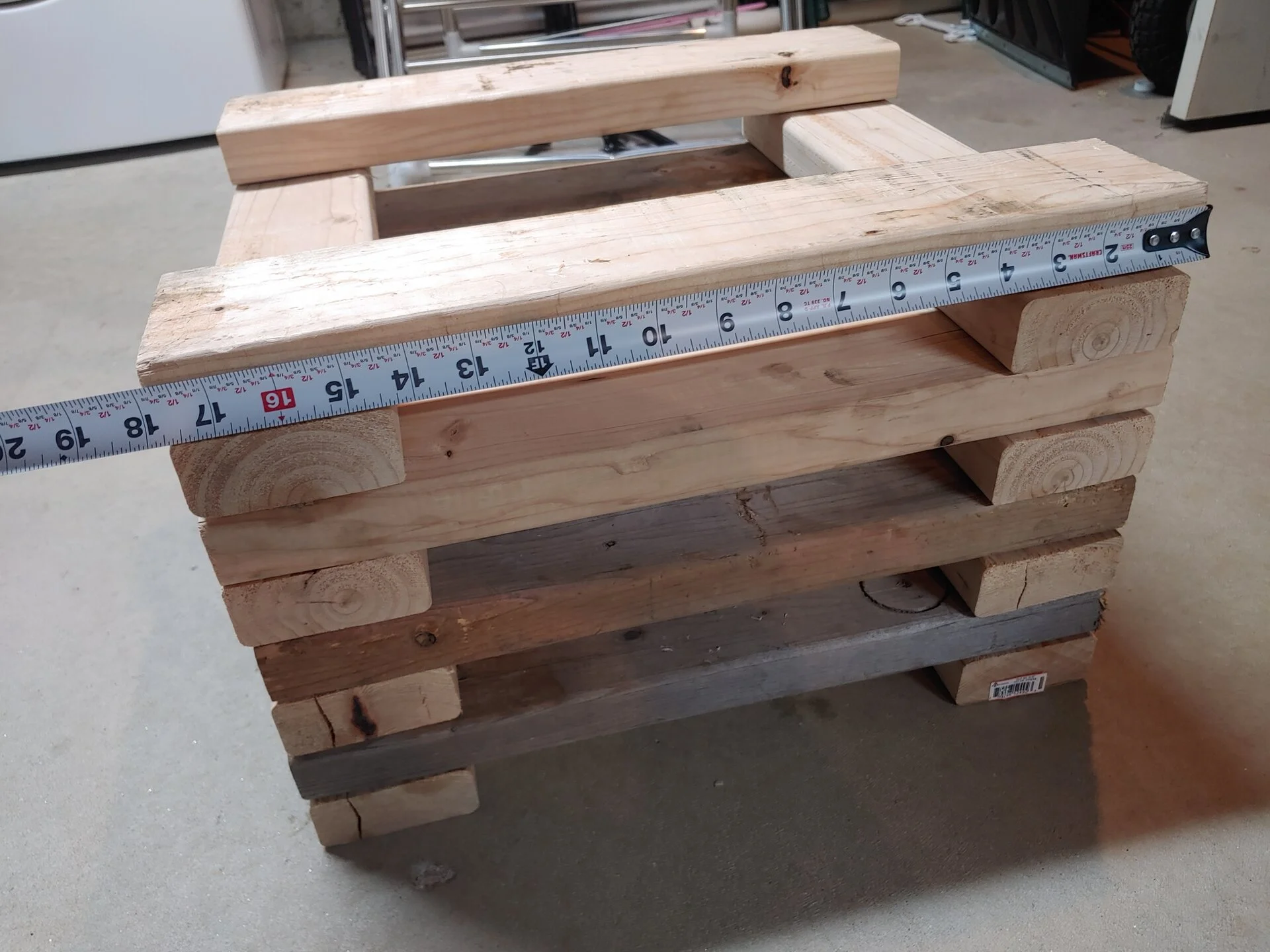

Do you guys have pictures of these you could share? Thanks.
Here's some pics of the cribbing I built.
Simple 2x4 and screw construction. I almost had enough leftover lumber from various home improvement
project to complete these but did have to by a few 2x4s , cheap enough though.
They are heavy but can be stacked , I keep all 4 of them in my basement just don't have room in the garage.
Stupid Question: How do you get the car up there. Just jack all around a little at a time. The blocks are nailed together?
floor jacks under the rear axle and front subframe ( i used a piece of 2x6 between the jack and front subframe)...my cribs are 12 inches high..its best to have 2 people to get it up and down...theres alot of room under the car to work when its on the cribs...yes nails or screws holds it together
