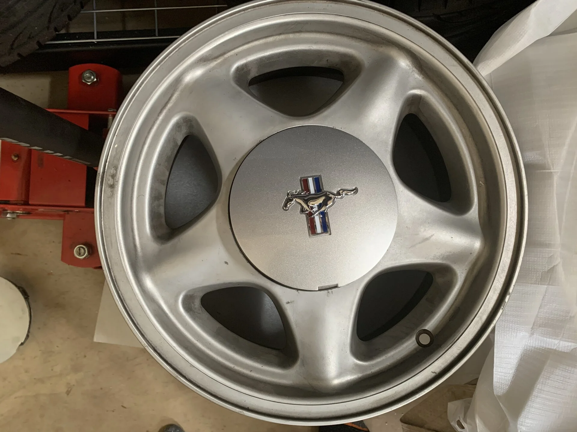

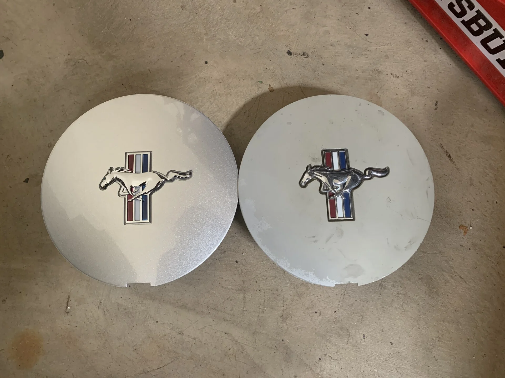

After closer examination of the center caps that came with my super cheap pony wheels, I decided to just go ahead and order new ones. Hopefully the color is a close enough match. Now I just need to figure out how soon I'm going to brave the rear main seal/clutch replacements and then have a better idea of what time I'll order some new tires.

Center caps arrived yesterday. After looking at these, I'm A. positive I couldn't salvage the originals to look this good; and B. going to need to wash the wheels pretty well, haha.

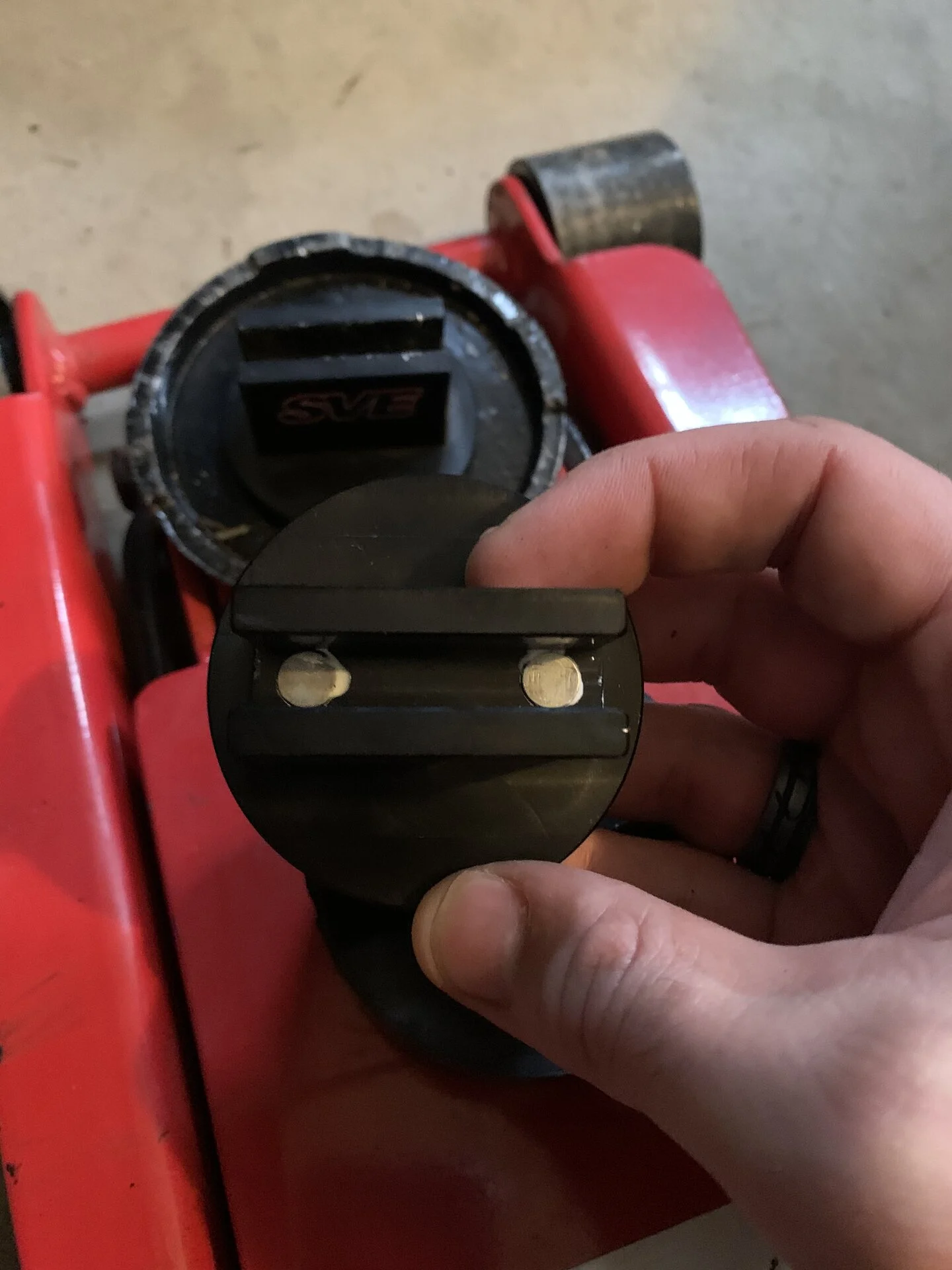

I did a little bit of work on straightening out the pinch welds on the Fox on Saturday. I'll have a video up on that soon. Little thing that I had been meaning to do and also procrastinating on doing the cooling system stuff.

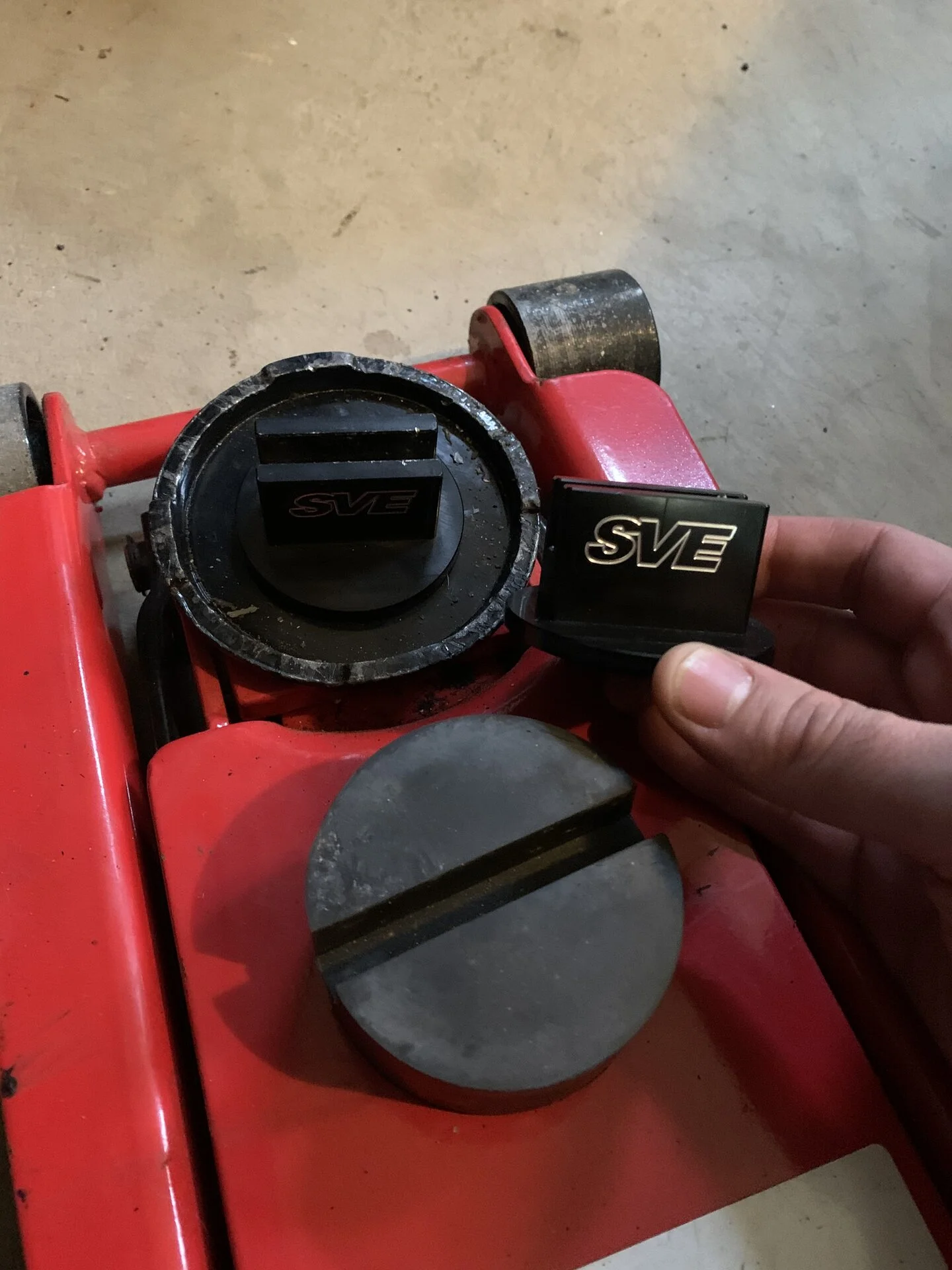

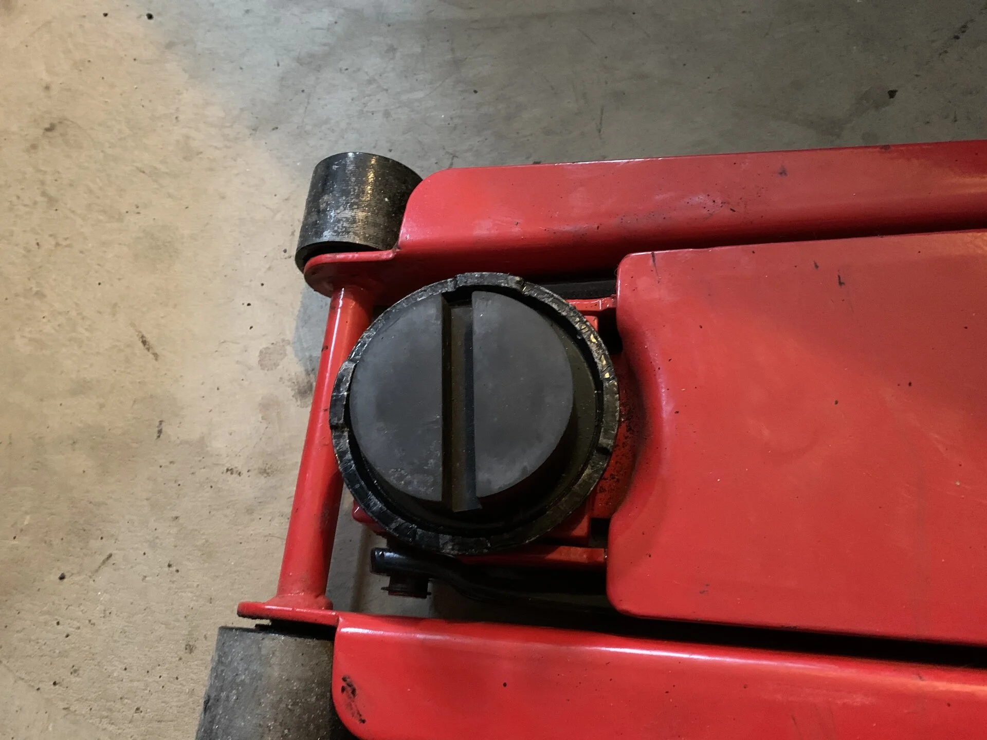

Got the jack pad and pinch weld video up this morning. There’s more detail in the video but I’m pretty happy with these SVE jack pads. It would be awesome if they made them in a few different sizes (like maybe slightly bigger to better fit the jack cup like the rubber one pictured below) but these seem like they will work pretty well for the Fox. I haven’t tried them on the 2014 yet.
It’s pretty awesome that they have magnets.

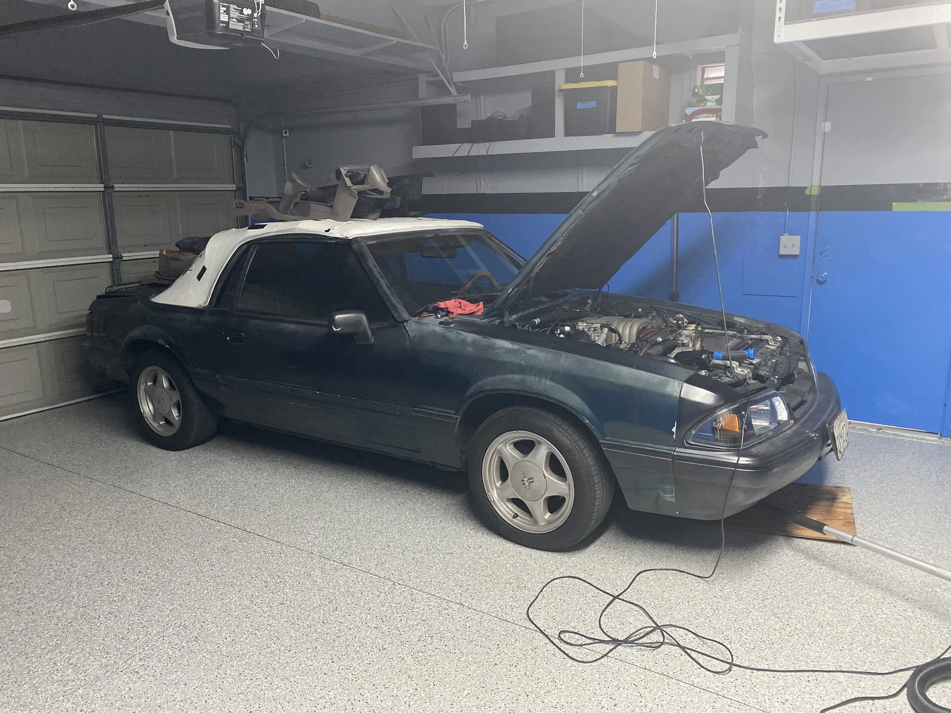

Convinced the universe was conspiring against me, I was about to take a break for a while but came across a couple more options. I checked out this 1988 GT and made an offer a couple of weeks ago. Finally picked the car up last weekend. She definitely needs some work but she runs strong and is a lot of fun to drive. Looks good in the garage next to my 2014 GT.
Be prepared for a :poo: load of threads/questions as I get started working on this thing, lol.

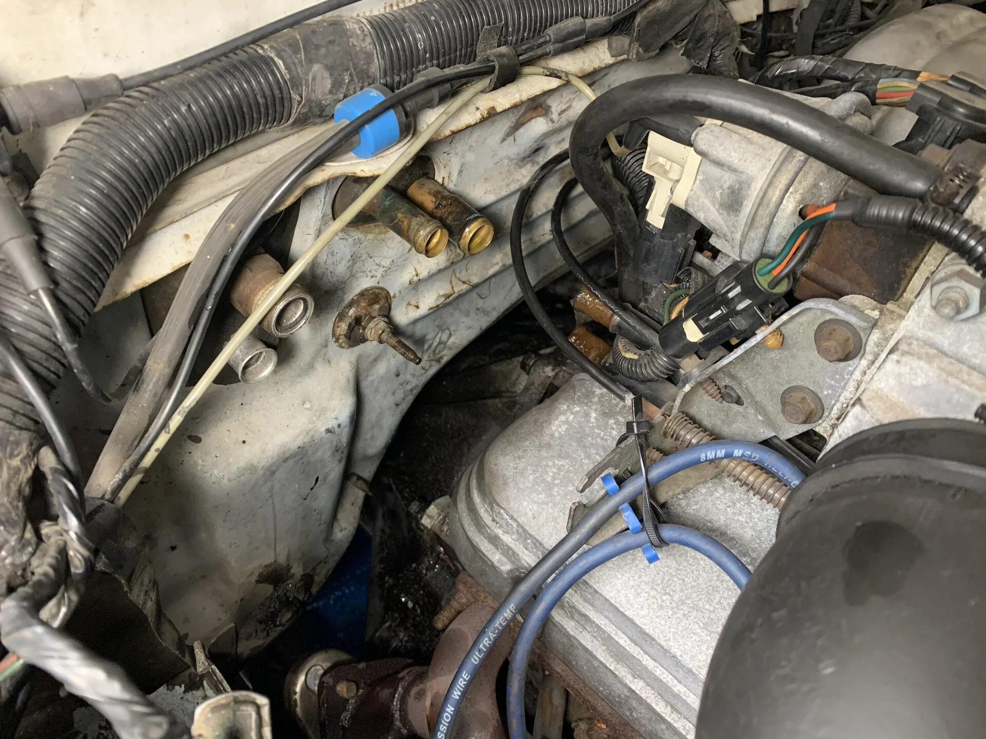

I took advantage of the warm weather to finally get started on the cooling system stuff, which I’ve been procrastinating on. I drained the coolant, removed three of the hoses, and sprayed some PB blaster on the water pump bolts. Had to do some work on the back deck this morning so I didn’t get a ton of time on the Fox but I’m glad I finally started that process.
I still need to get the bottom radiator hose off. My plan for tomorrow is to hit the water pump hardware with more pb blaster, remove the belt, etc. and then start carefully trying to remove the water pump.

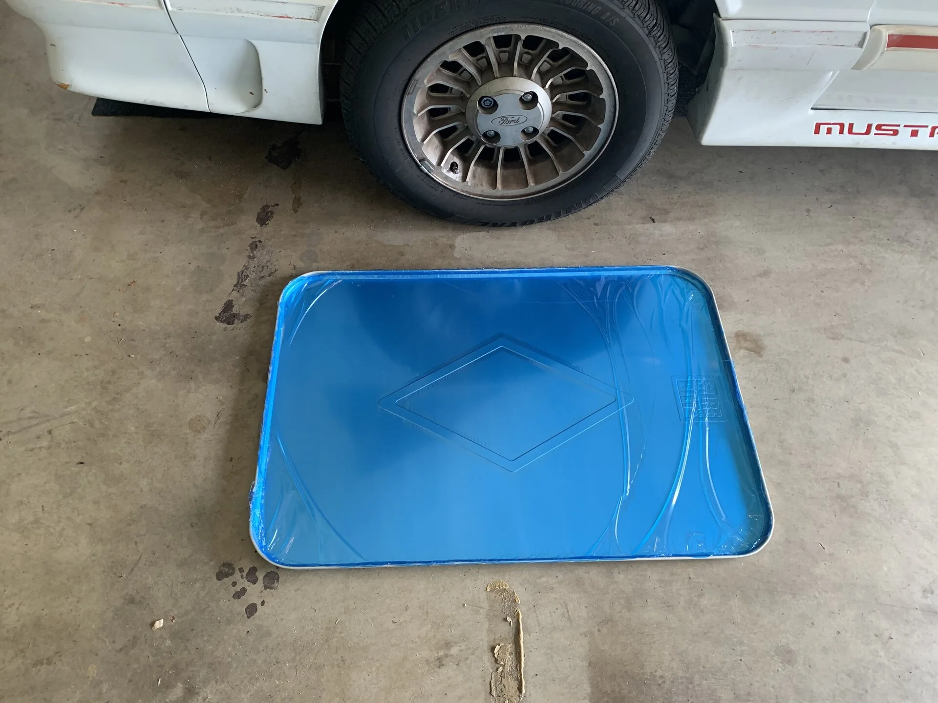

Also found a large drip pan at Auto Zone today. It was $10 so I grabbed it. Figure it’s better than constantly throwing cardboard boxes underneath to catch leaks.

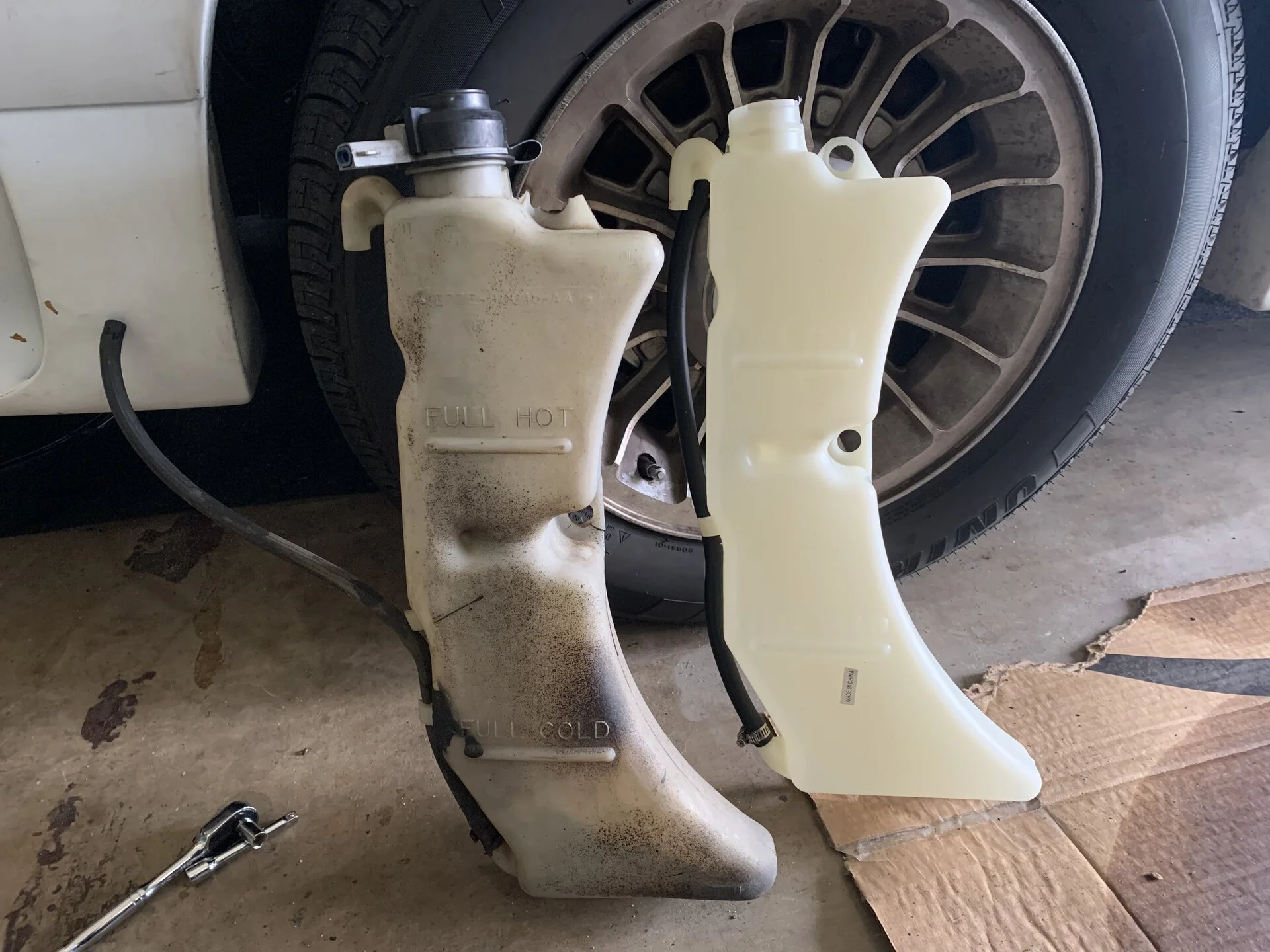

Made a little bit more progress today - got all the hoses removed, got 4 of the water pump bolts out, and took the coolant overflow tank out.
Taking the tank out made me glad I decided to order a new one.

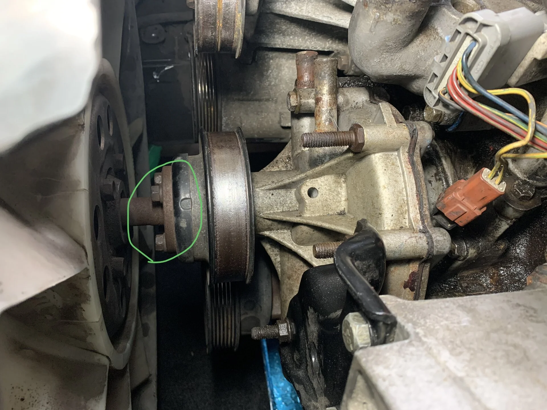

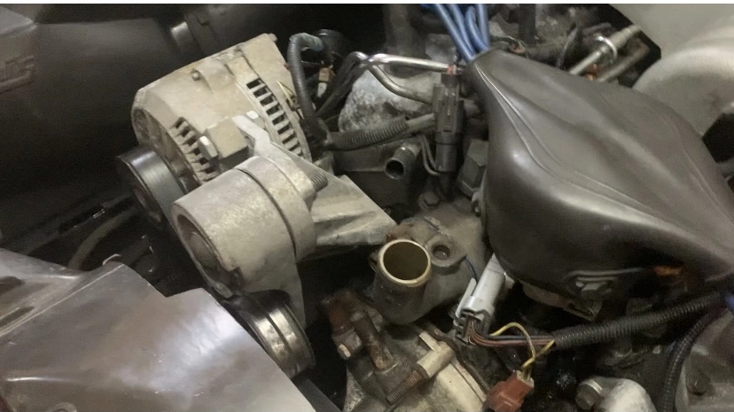

The bolts have been coming out OK so far. I’ve been really slow and careful but I’ve got a few more to go. I got the belt out but haven’t figured out exactly how the water pump disconnects from the fan/fan clutch but I will get that sorted out sometime this week.
The four bolts on the pulley and it will fall off and ding a hole in the radiator so put a piece of cardboard between the fan and the radiator, unless you've taken it out already,

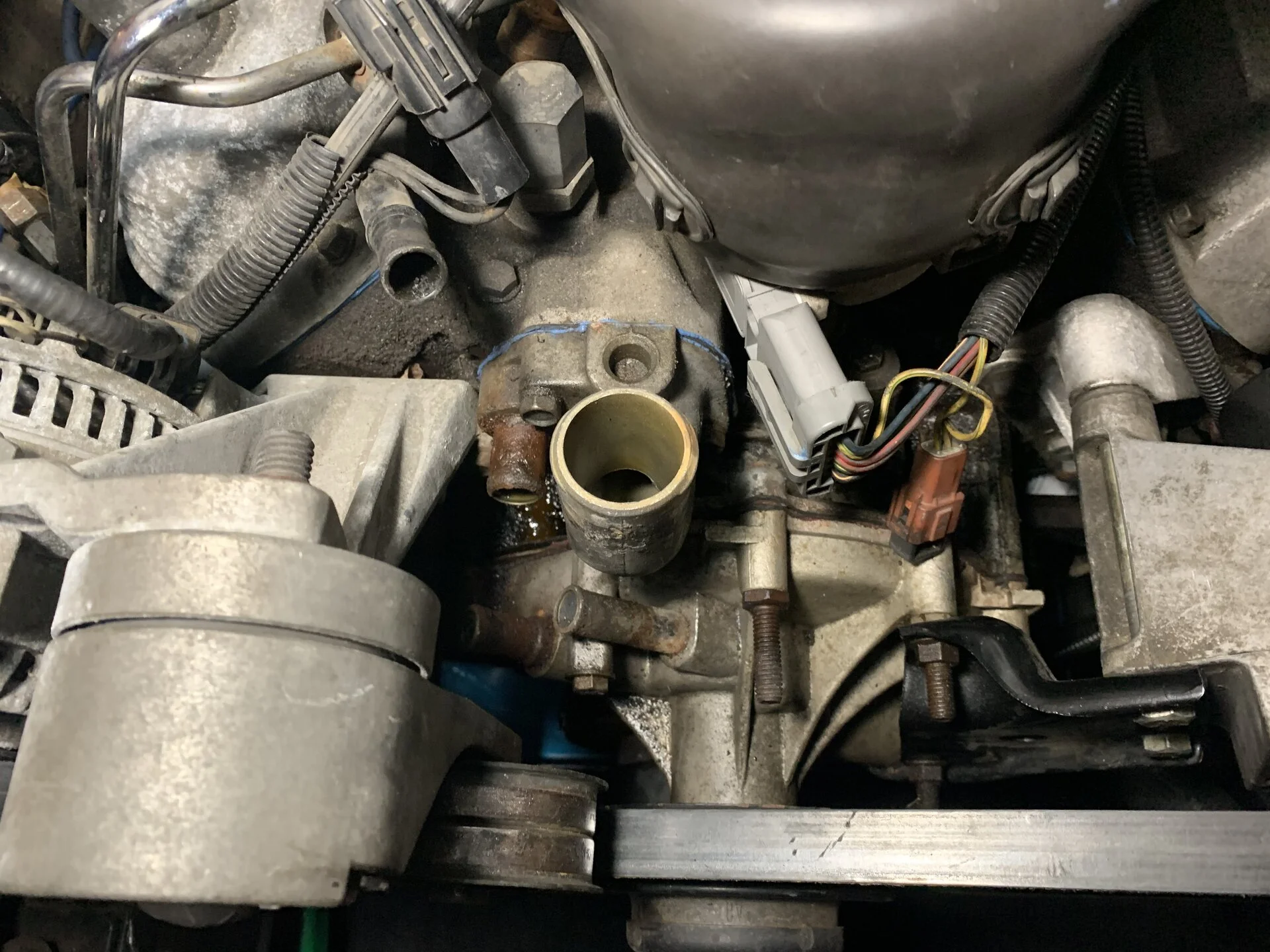

Thanks. I assume you’re referring to these bolts?

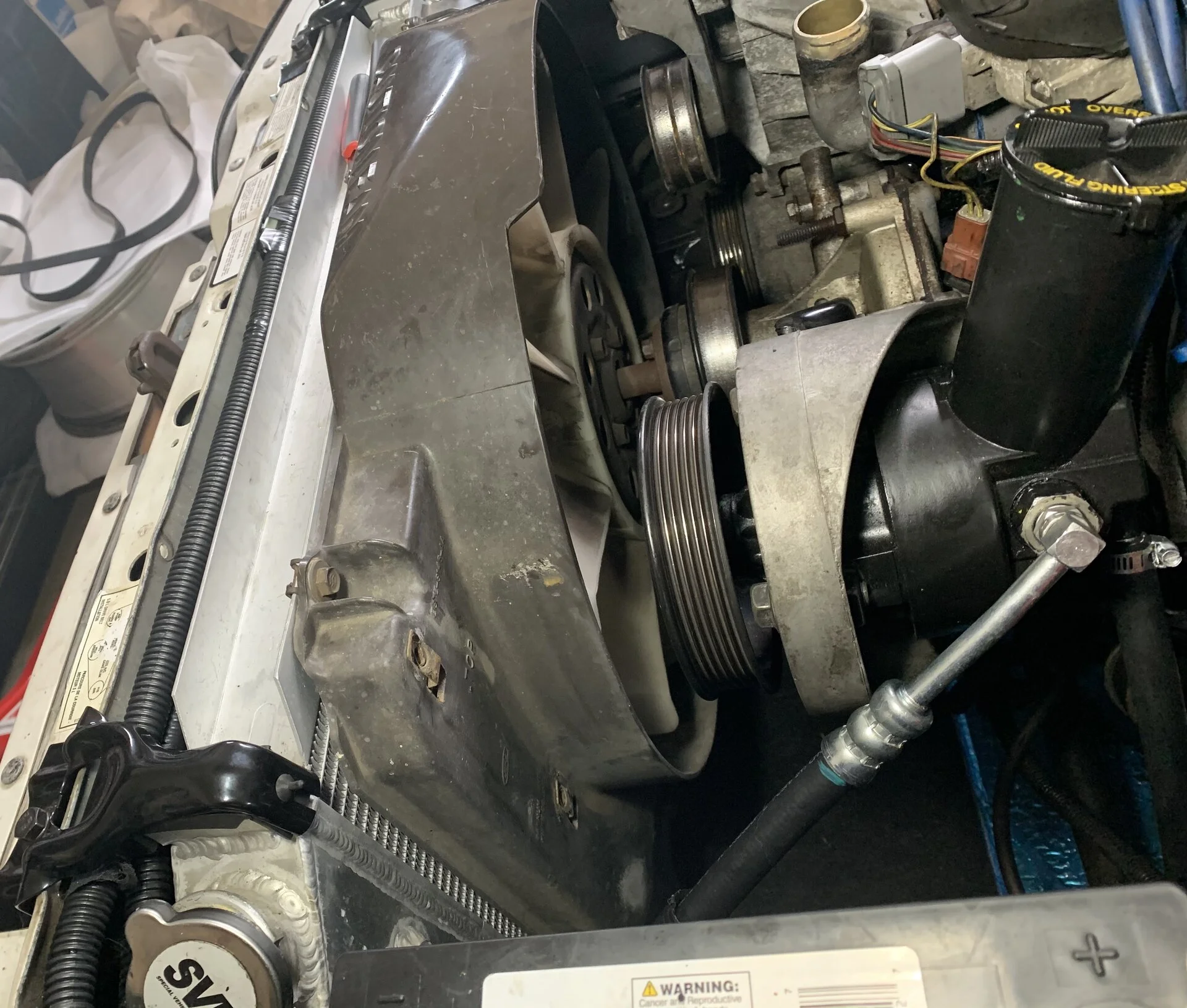

What falls into the radiator? The fan clutch? I haven’t taken the fan or fan clutch out. Here’s how it looks at the moment.
Undo three of the four bolts at the pulley, leave the forth loose, take the two bolts from the top of the shroud out, lift it a little and the tabs at the bottom will allow the shroud to move back towards the engine, slide a piece of cardboard in between the fan and the radiator, take the last bolt out of the pulley and lift the fan/clutch and the shroud up and out, this saves possibly damaging the radiator.
Easy peasy (after doing it a couple dozen times.

Thanks for clarifying. A few of the videos I was looking at - they either already had the fan/radiator out of the car or they were adding the water pump to an engine that was out of the car so it wasn't completely clear how to proceed on that particular part. I'm hoping to make some time to keep working on this tonight after work or tomorrow.

Let's talk here for a minute, first jack that junk up and stick some jack stands under it, it's too hard to maneuver around in the small space when the car is at rest, second, that hose would have been easier to deal with after the fan and shroud was removed, you'll learn,
Now, a few words of caution, and this has happened to me more than once, the bolts that hold the water pump also hold the top part of the timing cover to the block and the coolant flows through it, the reason I mention this, after you change the water pump the timing cover could start to leak coolant in the area of the water jacket. This has happened to me nearly every time I have changed a water pump on an engine with the original timing cover to block gasket in place, without getting into you changing the timing cover to block gasket cause that is a whole nuther bag of wrenches. Consider, if the water pump is not causing any issues, swap out the hoses and call it good.
Don't let me talk you out of changing it but just be forewarned.

You probably just talked me out of changing it, lol. :eek:
