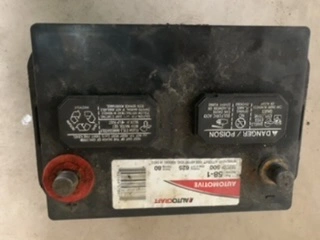

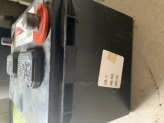

Found the battery dead on the fox today. I think it’s been a little over two weeks since I last started it. Anyone know if this means the battery needs to be replaced or if it might be the alternator? Or is there any particular way to tell?
When I bought the car, the seller had to jump start it because it had been sitting but I think it was no more than a week or two.
BlakeusMaximus
Still got to try a little lube on my speedo head
5 Year Member
Jul 12, 2017
2,477
1,348
173
Mar 14, 2020
#127
  • Mar 14, 2020
  • #127
There should be a date of manufacture on the battery. My guess is that it’s ready to be replaced. Look for a bright colored round sticker on the battery for the date.
Reactions: DudeStang
DudeStang
Nuts fell off while driving
5 Year Member
Apr 30, 2017
659
373
83
Mar 14, 2020
#128
  • Mar 14, 2020
  • #128

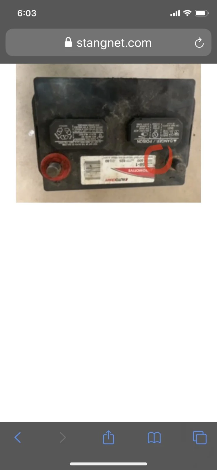

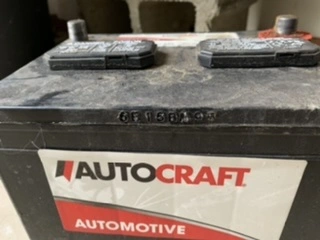

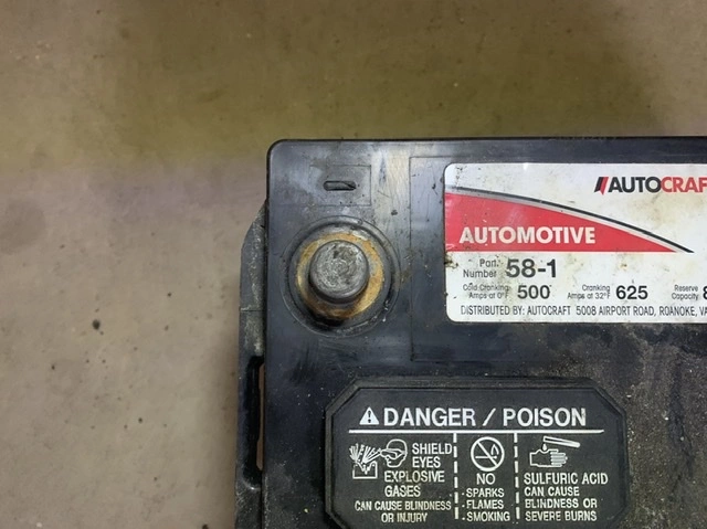

Here’s some pics. Based on the sticker on the side it seems it could be from June 2015 but based on the stamp on the front, maybe it’s older...I’m finding conflicting code reading guidance in my googling..

Hard to tell, because when I blow up the pic it’s too fuzzy, but sometimes there are “cutouts”, “perforations” whatever you want to call them, in the label. You may want to clean the label where I’ve circled and you may find a list of Months/ years. Again..... can’t see well in pic.... just guessing.

Average life span is 4-5 years. Get a new one.
Not seeing anything. Here’s a closer up picture.
Yeah...I was thinking the same thing. Going to try and pick one up today so I can proceed with horn trouble shooting.

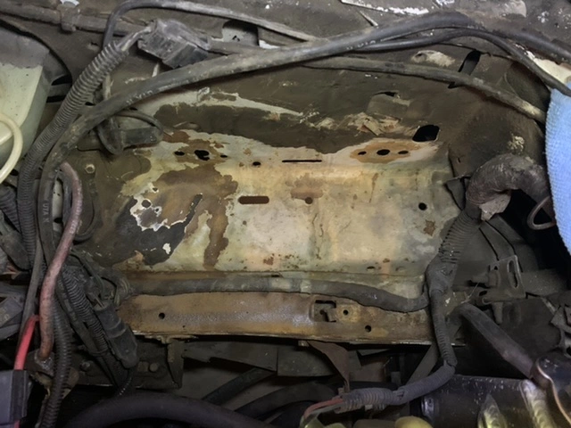

I do want to spend some time working on this rust (and the rust on the engine bay side of the shock tower) though.

Put in a new battery. Car fired right up.

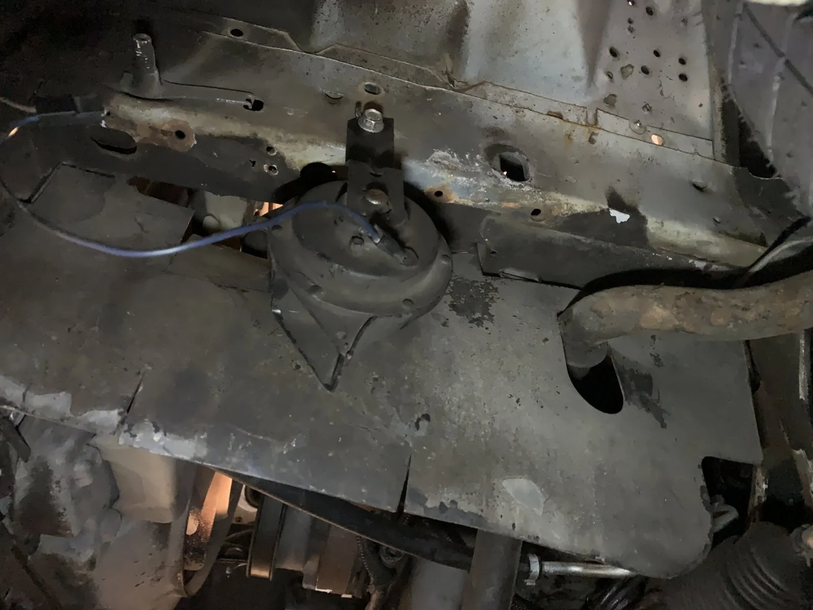

So, interesting development...just for sh*ts and giggles I mounted one of the old horns to the frame (again) and plugged it in, and pressed the pad and the horn worked :-O
Only difference between today and doing the same thing last weekend was the new battery.
Here’s how it’s mounted at the moment:
Reactions: Rdub6 and General karthief

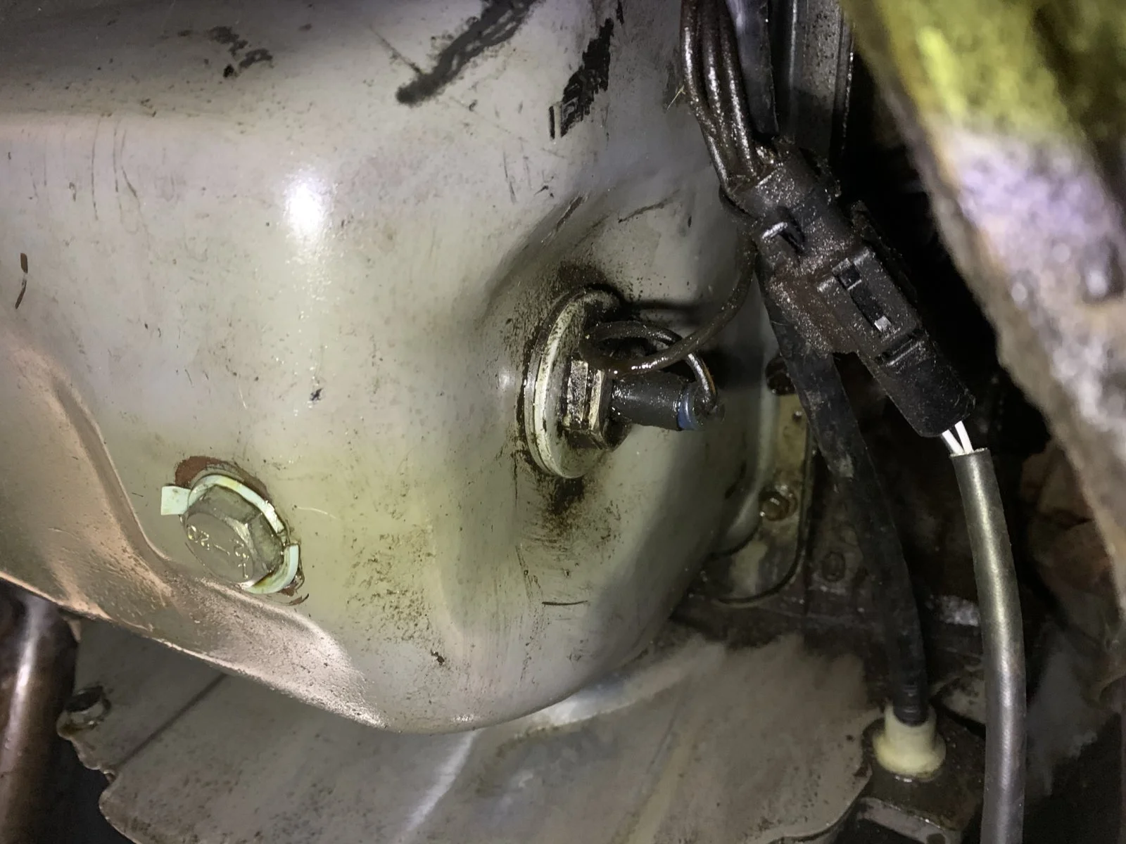

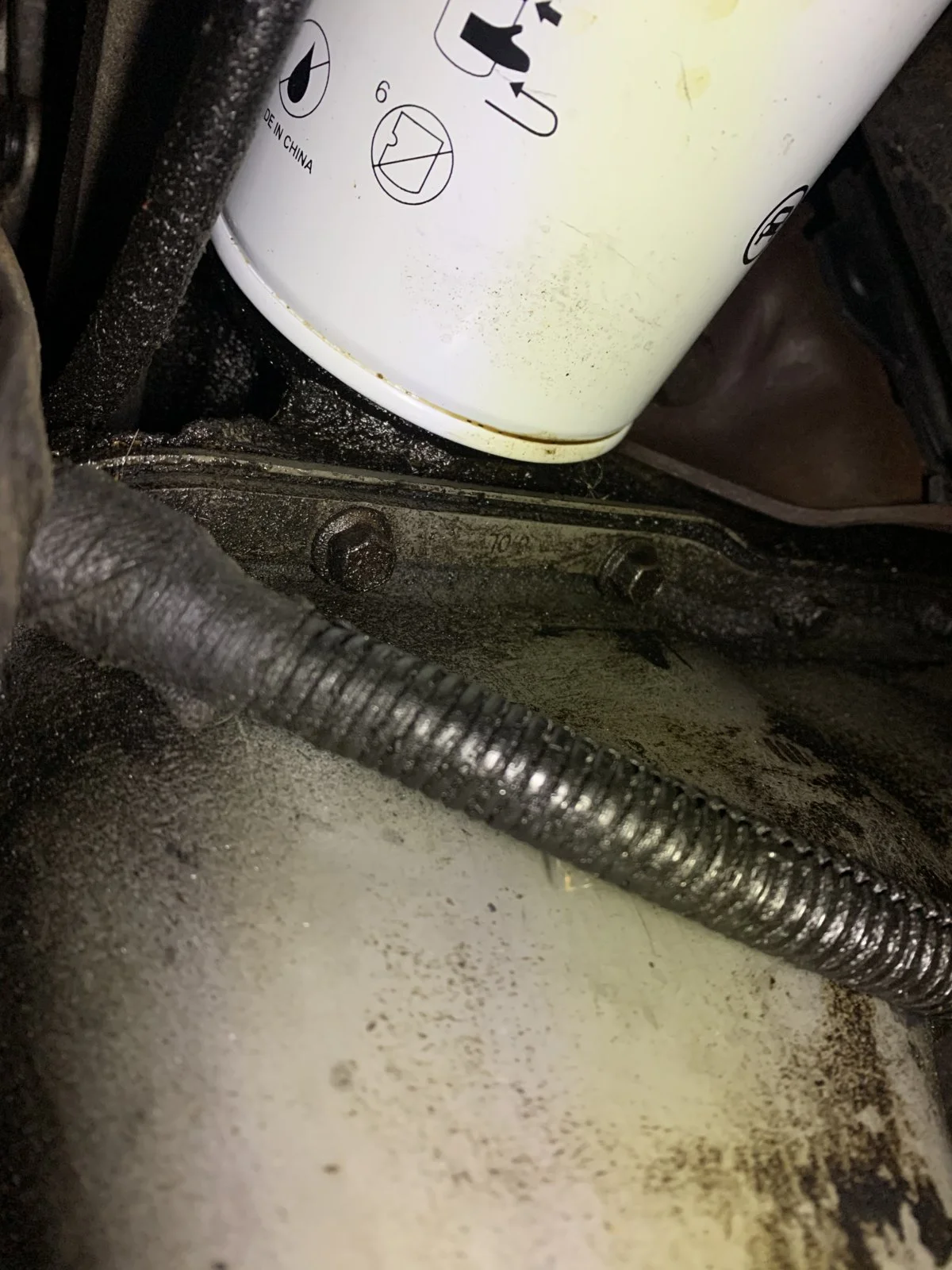

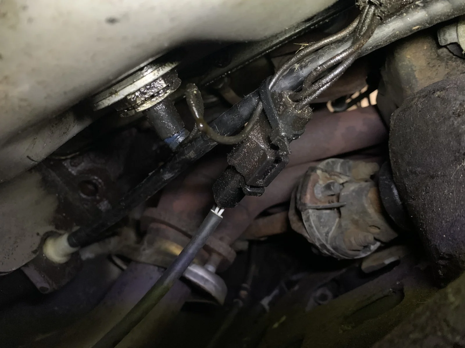

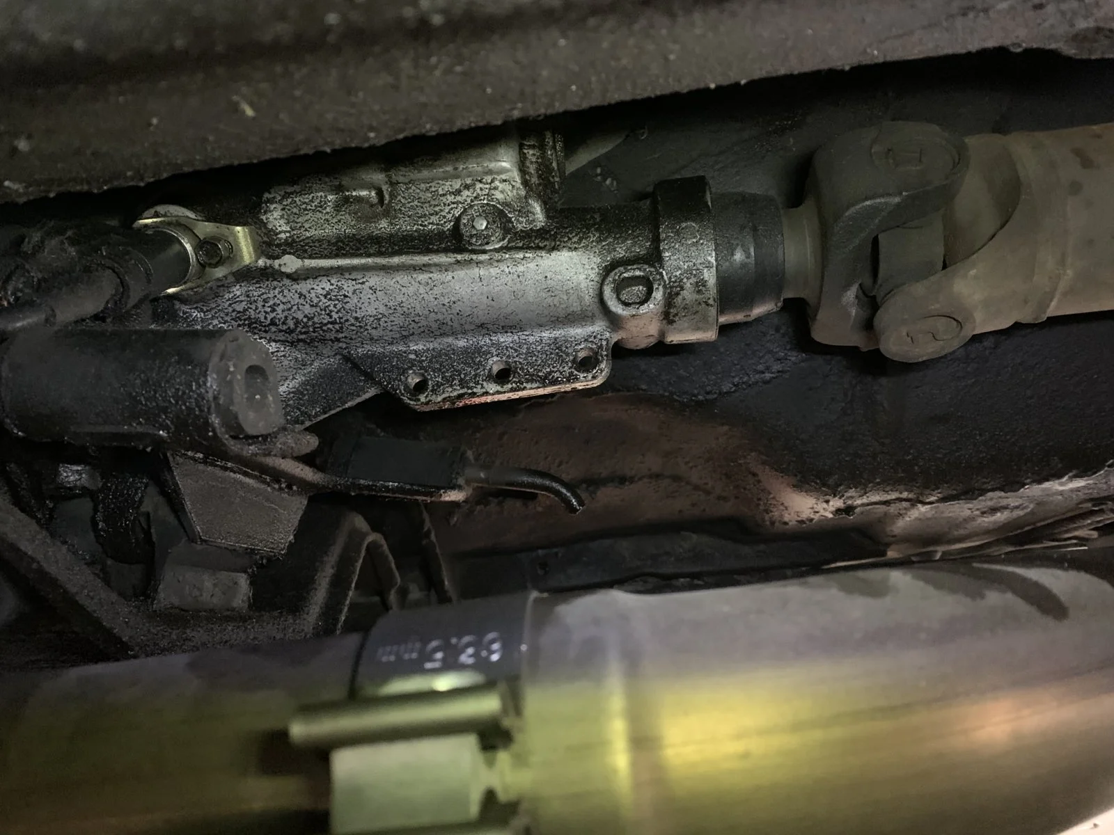

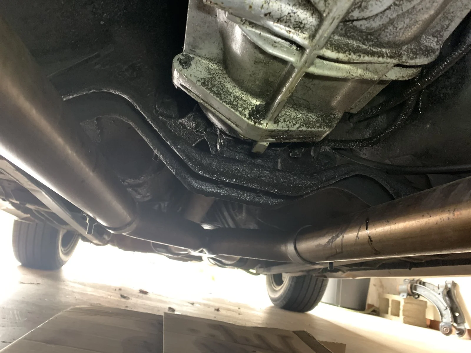

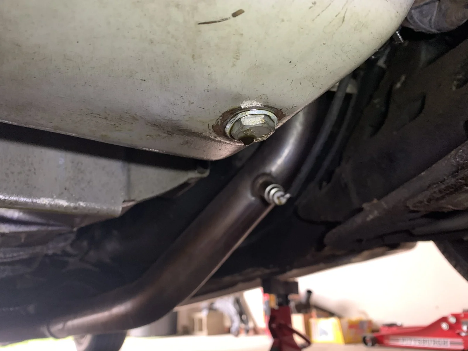

So I got the fox up on ramps to change the oil and got a few shots underneath to hopefully try and start pinpointing leaks. Commentary from the peanut gallery very much welcome here, lol.
On the oil drain plugs - I cleaned them with brakleen but I’m wondering if they both need to be replaced....

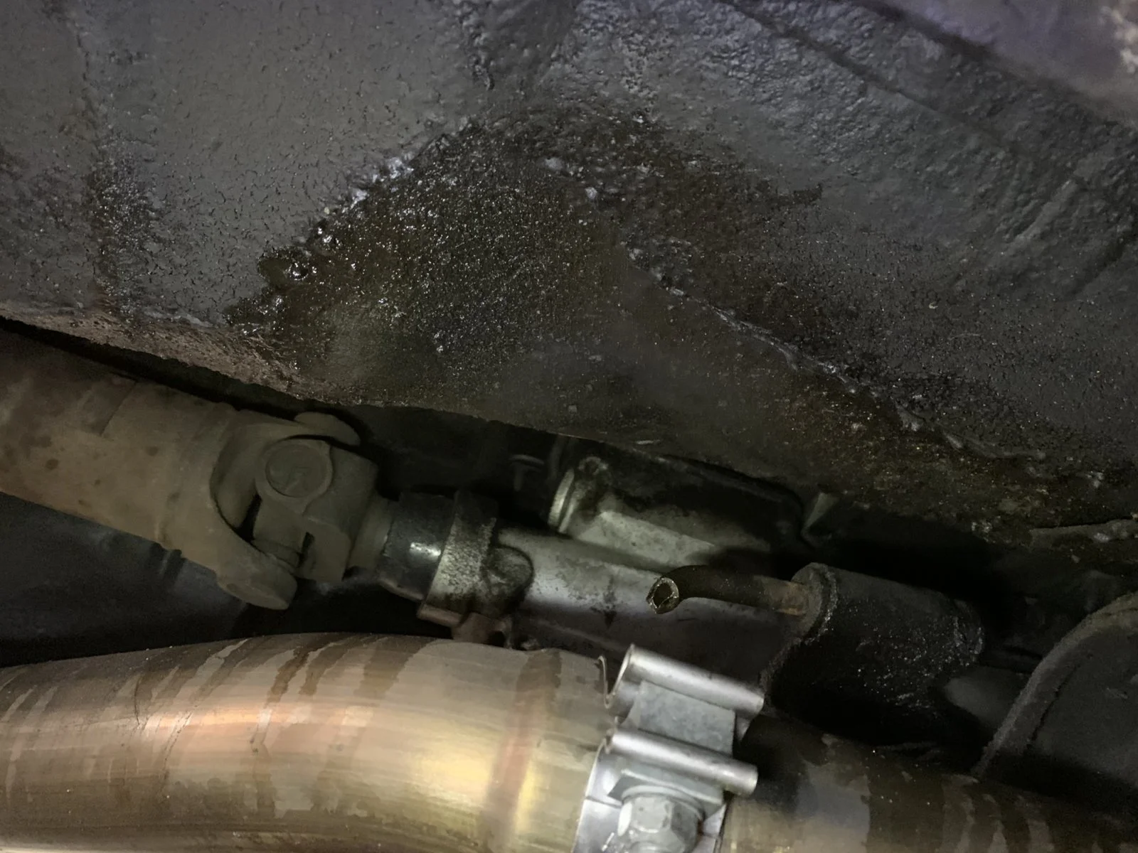

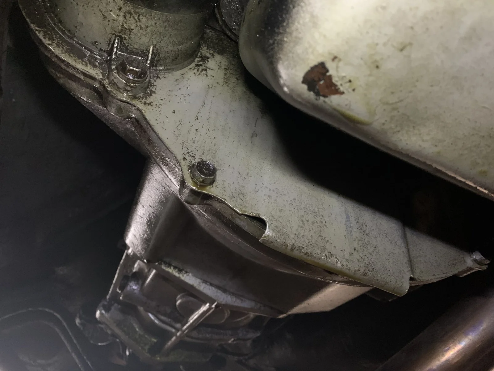

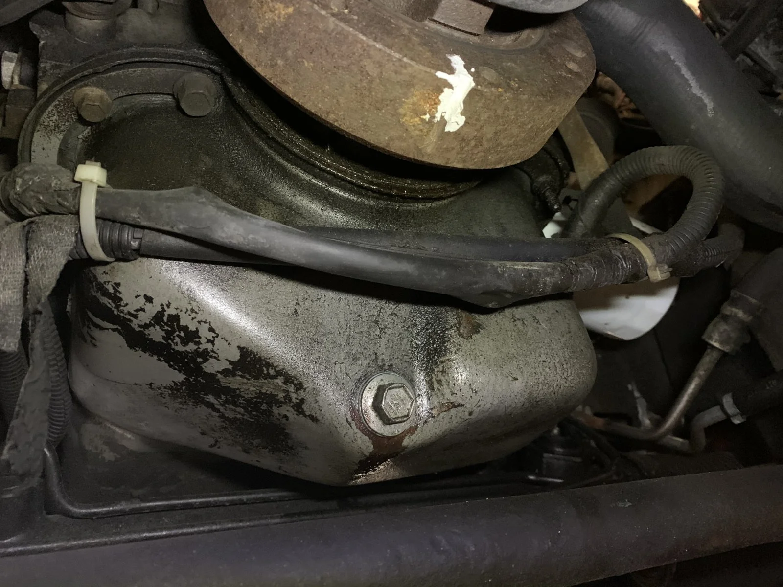

Some more

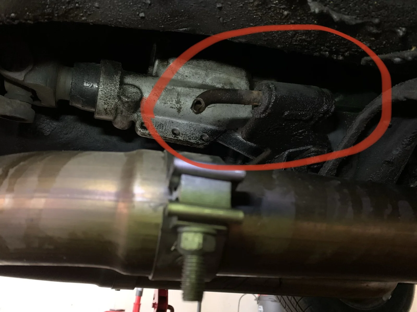

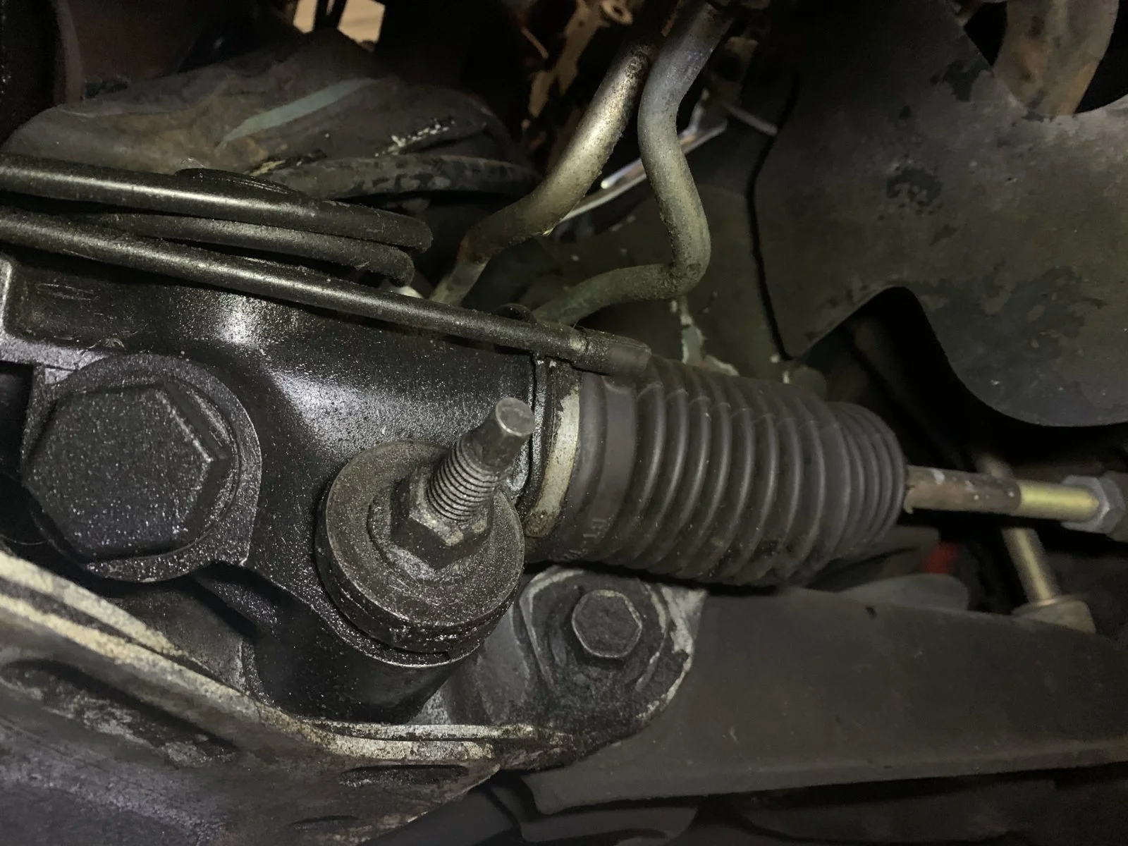

Last few...can anyone tell me what the thing is that I circled

I’d spend some time with a rag and degreaser and get everything as clean as you can. Then you can better see what is actually leaking.
Some copper washers on the drain plugs should fix those leaks!
It was connected to an old exhaust pipe. Looks like someone cut it off there and left that piece in the hanger.
