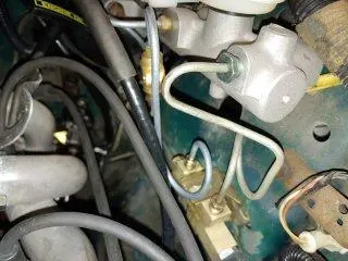

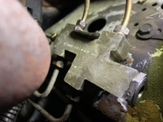

Are those brake lines copper? They don't look right and one looks to be leaking at the fitting.

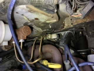

The rust looks to be at the base of the shock tower which concerns me. The leaking brake line may have helped this,
Given the rear disc brake conversion lines would have needed to be reconfigured but I agree something doesn't look right and
there looks to be a leak.
A picture of the whole distribution block would help.

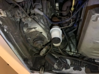

Didn’t have time to get any pics this morning but will share more this coming weekend. I’m going to try and get a wire wheel/brush to work on some of the rust on Saturday and also work on the horn mount and see if I can get that reattached at the same time.

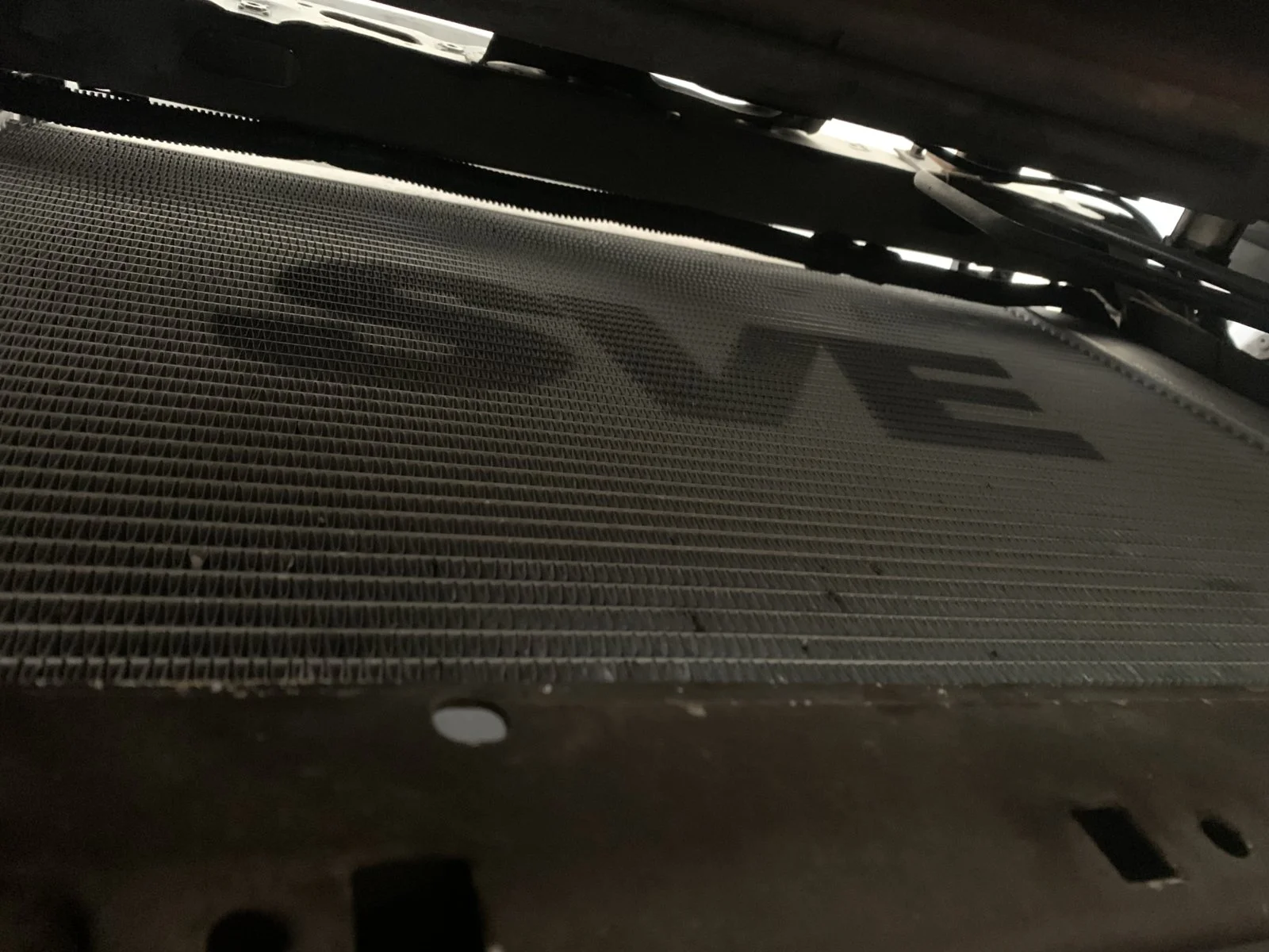

Meant to include this when I made some posts on Monday but also figured out that the car has an SVE Radiator (looks like this one), which is apparently a slight upgrade from stock(?).

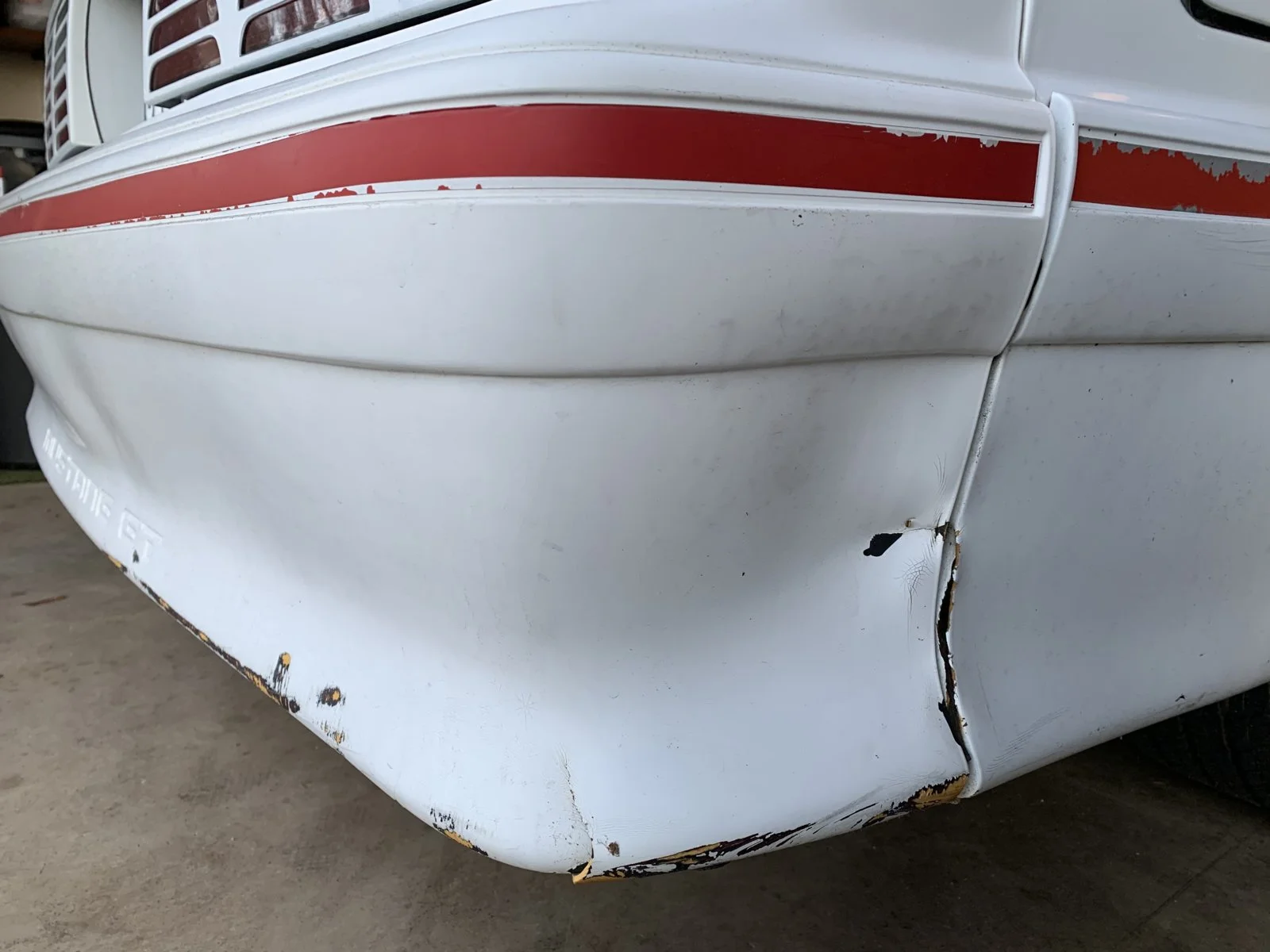

Also, these aren't as much of a priority as addressing the rust and the horn issue but figured I'd ask for not too distant future reference. My assumption is that this damage to the bumper means I need a new bumper, because it seems having this repaired would maybe be more expensive than getting a replacement bumper...though now that I'm thinking about it, the additional cost of painting it could make it closer to repair costs. Any thoughts?

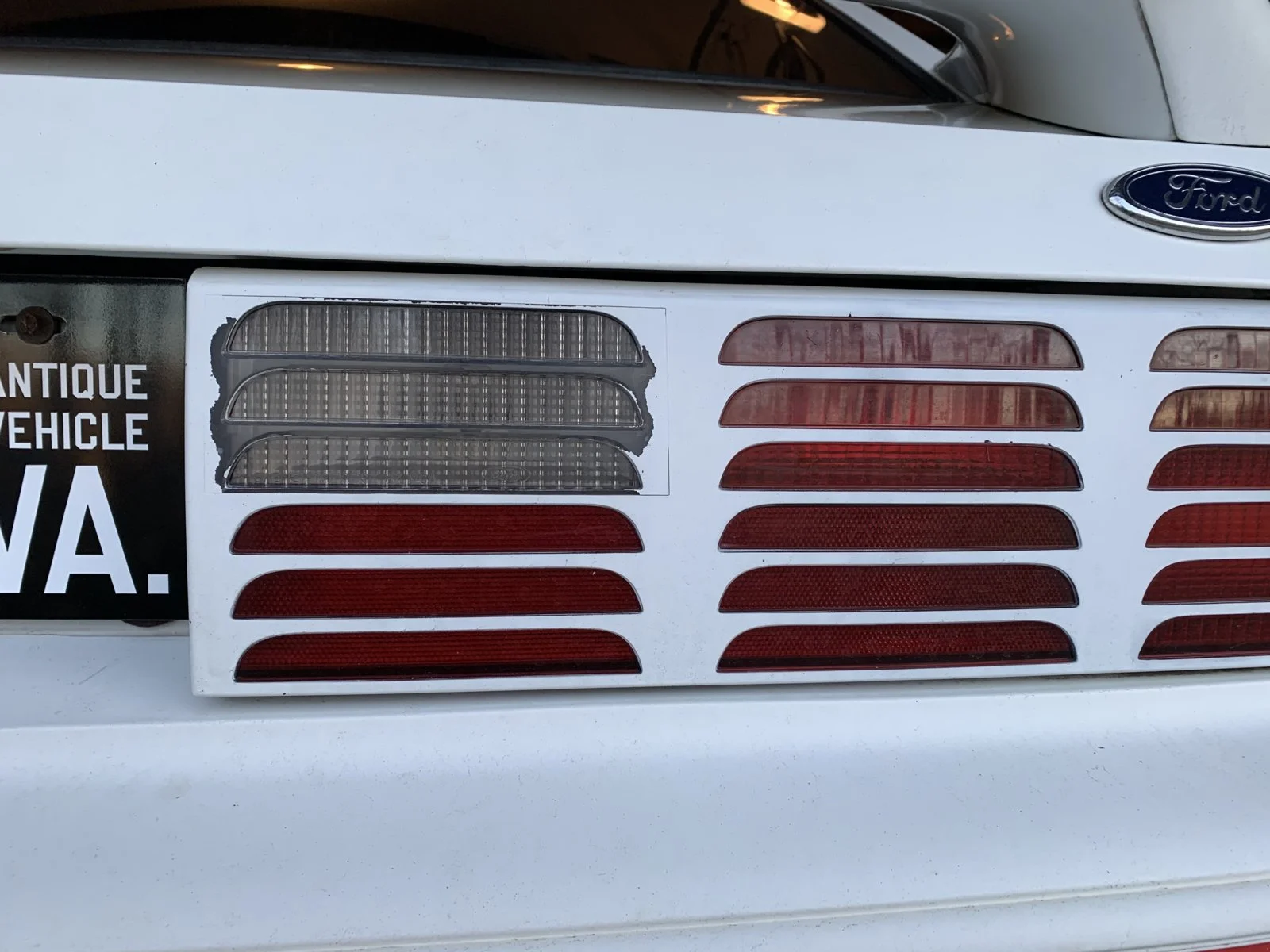

And on the taillights, as much as I dig the Cobra and LX taillights, I want to stick with the graters on this car for now. There is some paint missing on the passenger side around the reverse light. I saw that LMR has these template kits that are supposed to help with repainting. Anyone with no paint experience try to repaint these themselves? :confused: I am want the car to look decent but I'm not really going for show car quality since I do plan to track the car.

That bumper looks like it would be best to replace. You want to find a decent yellow urethane original rear bumper. Try to find one that hasn't been repainted yet. They are out there. The aftermarket ones will work but don't fit as easy and can crack easier...paint also has a hard time adhering if it's not prepped correctly.
Yep, like 90sickfox said, a replacement bumper would be best. A used one would be better than a new A/M. Ive never used a template for the cheese graders. When I did mine I used masking tape and a exacto knife. I would polish the lenses first, then clean them, tape them up, prep them, and repaint. Better to polish them with the old paint rather than trying to polish them after paint.

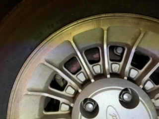

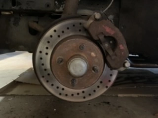

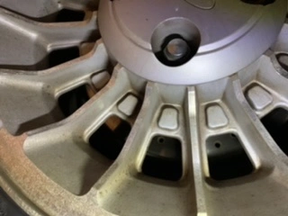

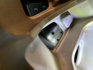

So...I was just looking a bit closer at the front brakes.
FD27E11E-83FE-4ECF-9465-44795F5044CC.webp 1A0E532E-4355-4B22-9A8E-F6E6215B6B95.webp 4A27D224-E83C-4275-935C-341DD5ACA8E5.webp
I’m assuming 1988 Mustangs didn’t come from the factory with drilled rotors..hard to see much with these wheels but any ideas what brake kit this might be?

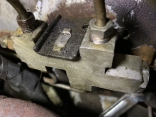

Took a few pics tonight. The distribution block:
5D3C5D9A-AD88-45F9-94BA-0900B7F2870F.jpeg 4DF8169D-2BCA-4AAB-8A76-36B4C3E7CF03.jpeg
A few more pics of the shock tower area:
867BF9E0-15C2-4ABC-B3DE-E898F3E9F771.jpeg C1B16F95-407F-491E-84D7-70EBDF3A2E10.jpeg
Hard to tell with the wheel on but my guess is the rotors have just been upgraded.
The brake lines look like a diy job which could be ok, still looks like the rear upper line on the
block is leaking. How do the brakes feel ?

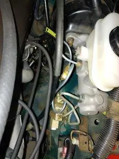

I used pre-bent lines and fittings that are made for a rear disc upgrade, got them from LMR / MM.
here's some pics you can compare to yours.
Reactions: DudeStang
Thanks for the input. So by replacement bumper you mean getting another bumper off another fox body? Are there any “new” bumpers that are worthwhile at all?

I got the new horn pad in and had my wife press it while I held the horns against the frame, plugged in, and got nothing. There’s sort of a sound when we press the pad though, like a clicking, which wasn’t there before replacing the pad...hoping that’s a good sign. My next move is to order replacement horns from AM or LMR, unless anyone else has any suggestions. :)
Got a shot of the front driver side rotor with the wheel off btw
Stock style front brakes, aftermarket rotor.
Next time you do brakes, I would recommend plain face rotors.
Have you confirmed the horns are good? Sounds like you are activating the relay. Unplug the horn and use a multimeter to test the horn wire to ground and see if you have 12v when the horn is pressed
Plain face rotors = non-drilled, non-slotted?
I don’t know for sure if the horns are good or not. You might need to explain that “test wire to ground” bit in the dumbest possible English, or I soon might ask a bunch of questions that make no sense...lol.
