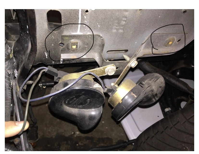

You can test the horns by holding the horn body to the negative battery post and touch the connector of the horn to the positive post with a wire.
caution: it will scare the sht outta you when it beeps.
To test the wire by using a dvm, red one to the horn wire and black to the frame, put the dial on 12v or 20v (the nearest number above 12v dc) and it will read if there is current.
If you don't have a dvm (digital volt meter) you can use a 12v bulb in a socket. Connect the wires the same way. One to the horn wire and one to ground, push the horn button and it should light up if there is current.
These suggestions should work
I think.
Disclaimer: these suggestions are not based on any real mechanical experience.
