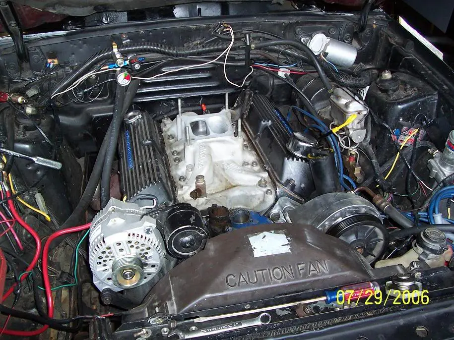

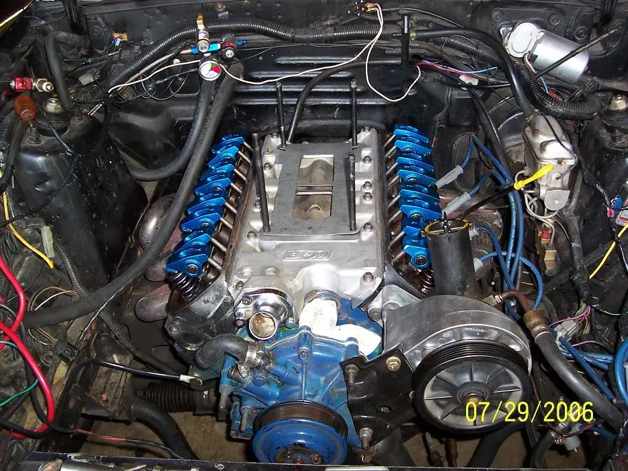

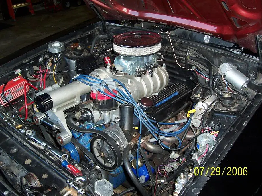

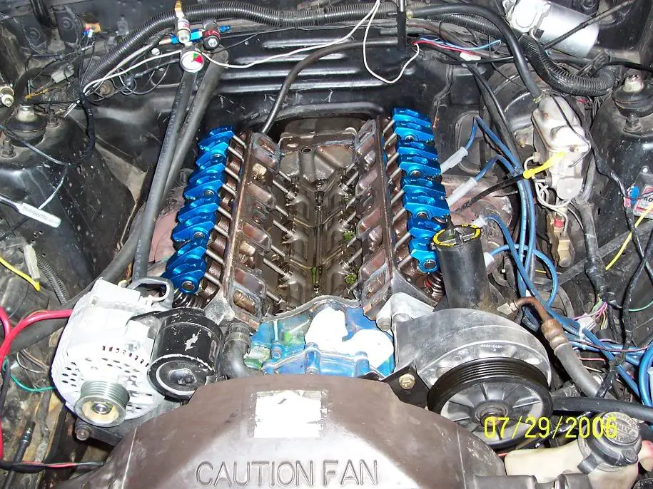

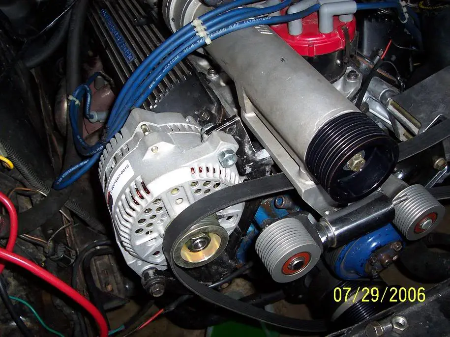

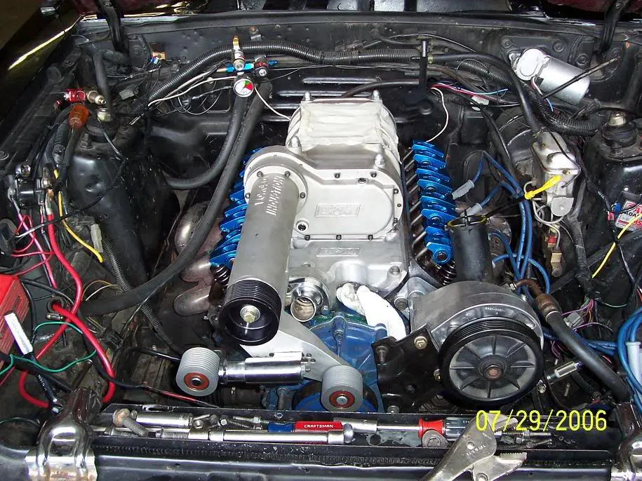

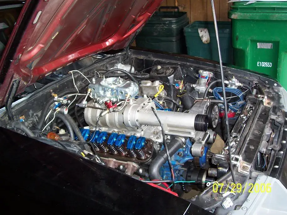

Its mostly done, i need to do a little rewiring and re-runing of the gas lines.
and i need to get some shorter crank bolts. my biggest problem is the accessorie belt tensioner. I had to cut the bracket to make way for the blower shaft. So i have to come up with some way to mount it elsewhere.
if i can get that done tomorrow ill have it fired up.
EDIT: the bracket where the tensioner used to be

how about you set up some sort of turn buckle the attaches to a water pump bolt and to the upper Alt bolt. Similar to the March kit, that way you can amnually adjust the tension.
88gt
Aug 2, 1999
794
Drillers cabin
Jul 29, 2006
  • Jul 29, 2006
Looks good!!
I agree with the adjustable turn buckle idea...get a couple of sphericle rod ends, jam nuts and all thread and you should be set...attach one end to the alt, the other to the bracket and tension as needed.
Jim

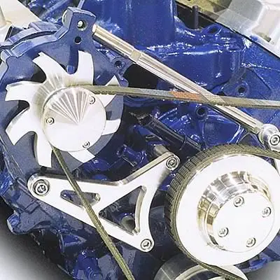

I was thinking, would an alternator bracket from an old 60s mustang work if i spaced it properly. that way i could just get rid of tensioner completly. something like this.

Just get a march kit... it's 100 bucks and very pretty

so your saying this would work as the tensioner?
stang8urimport
Autozone Junkie
Jun 21, 2002
1,499
12
59
Daytona Beach, FL
Jul 30, 2006
#15
  • Jul 30, 2006
  • #15
I would think that it would. That bracket kit actually lowers the alternator from the stock position, so it should clear the blower snout.

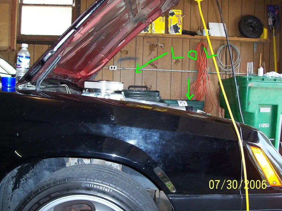

So did you decide to cut the hood, or does the air cleaner still clear? Gotta admitt I was lookign forward to seeing the black beast with a bird catcher looming above the hood. Looks great though.
woodyy24
Mar 30, 2005
290
illinois
Jul 30, 2006
#17
  • Jul 30, 2006
  • #17
It has to be cut the carb doesnt clear (probably because of the nitrous plate)
Im going with the bird catcher

alright everythings done but the belt tensioner
