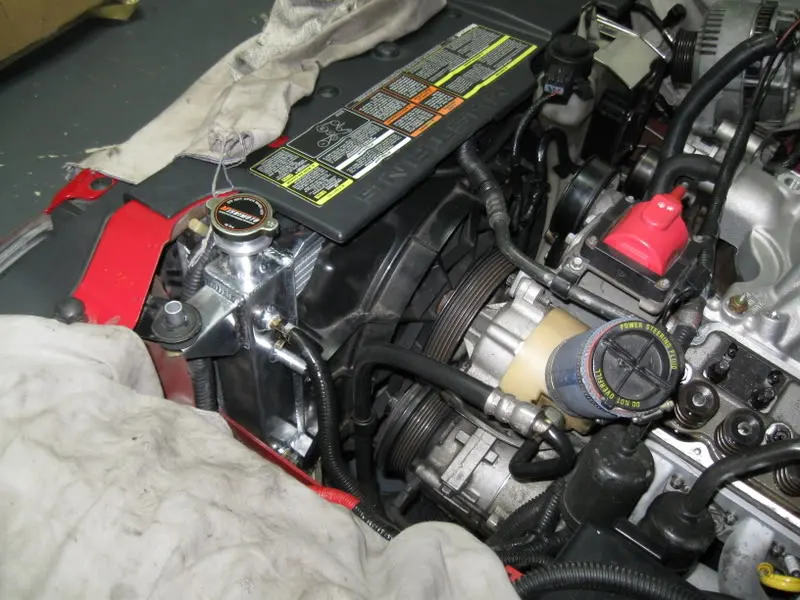

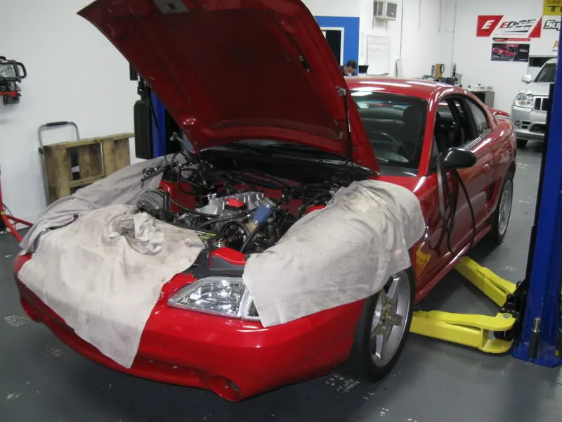

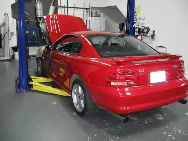

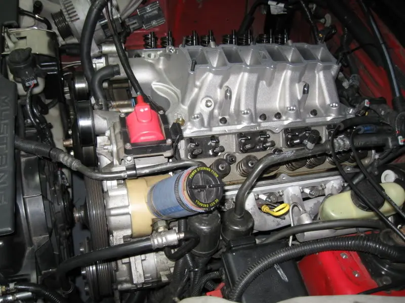

I have no problems w/ Ed at all, he deff knows his stuff and hes been very easy to work with through this situation. Stopped by the shop today to pick up the valve spring kit he sent me so I can send it back to him, snapped off a few pics while I was there. Its getting there, new fuel filter is in, tranny fluid, 2 core aluminum radiator. Just waiting for the springs to get put on so that it can all be buttoned up again.
To bad this is all you can see of that kick ass looking Radiator

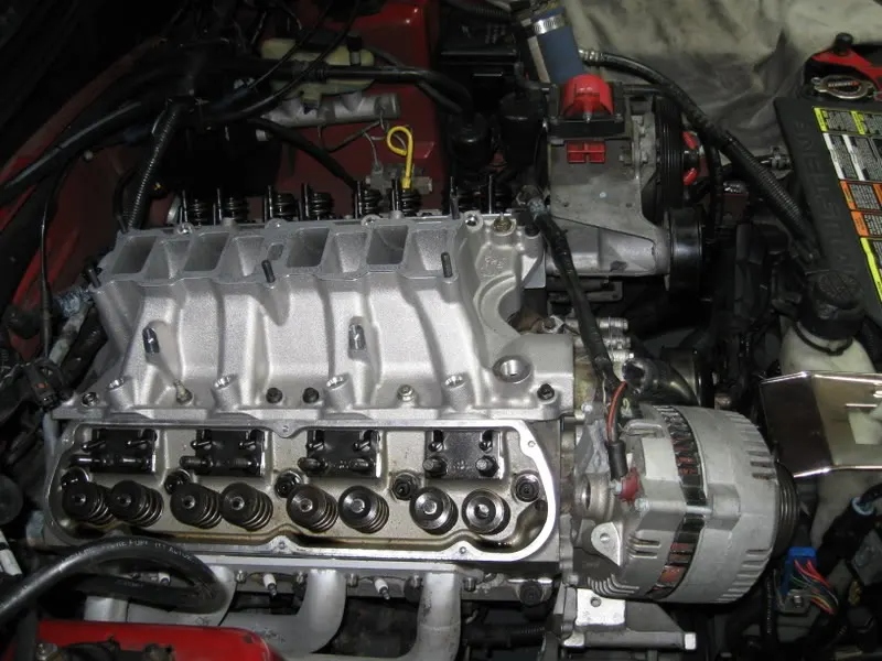

Not yet, I have to go in tomorrow to drop the locks off for the valve springs so I'll set the passenger side one on and see how it fits since that one seems like the problem one. It has a different bracket set up then a 302 so I'll either make out good or be F'ed in the A
Valve covers should fit, I test fitted them today, didn't appear as though there would be any clearance issues which will be sweet b/c those VC will look killer on this set up.

The bracket on mine is different then the 302 set up. I did not bolt it on but I pushed it up against the bracket as far as it would go and lined up the bolt holes on the heads and valve covers and there was a few centimeters of clearance, its going to be close but from what I can tell it should fit.

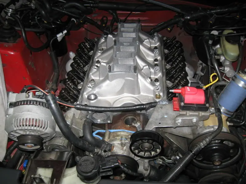

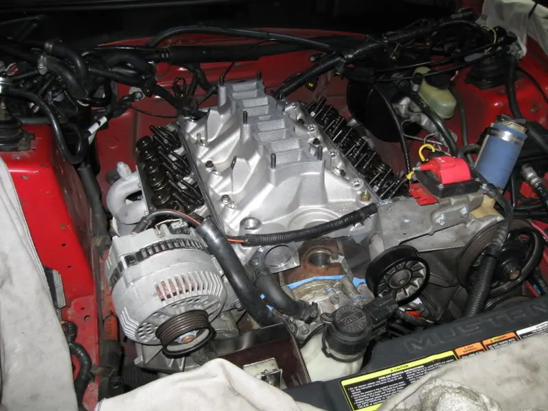

Stock 302 fuel rails will not fit on a Trick Flow R intake for the 351W. The stock rails are being modified now as to be able to fit on the lower intake VS buying an Aeromotive or Trick Flow fuel rail kit. Its something I do want to do but just not right now, dont have the funds to dump in $500+ for a new fuel rail kit right now.
Unknowns-
Valve covers, I test fitted them, the friend doing the install on my parts test fitted them, appears they will fit but until they are on the car and bolted down I wont be 100% sure.
The car is a few hrs away from being put back together. Just need to get the fuel rails to work and then its just a matter of hooking everything back up and putting the upper intake on. I wont make it to the track this friday or saturday as I wanted to so Im going to try for next weds night b/c hopefully with out anymore hang ups it should be all set by then.
